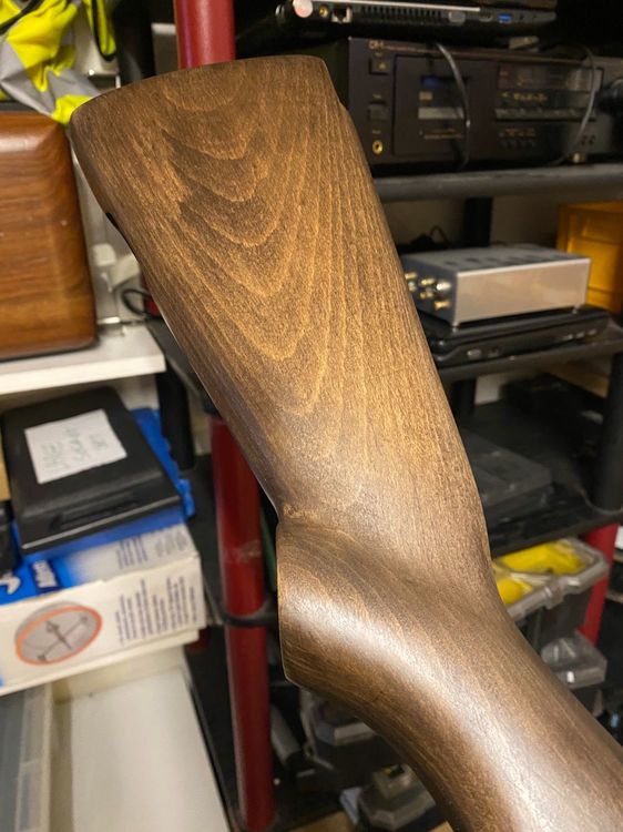

Alimcd Posted December 19, 2020 Posted December 19, 2020 Good morning good sirs, Now that I’ve sated myself for now with Hi-Capas, it’s time to have a closer look at something I started last year. I wanted a DMR, people had started bringing semi-auto 450fps stuff to the field and I wanted something that actually felt and looked as if it could justify that role. The final straw was when chronoing in at Finmere, a new face boldly stated that his short-barrelled M4 derivative with an enormous scope was a DeE EmM ArRrR. That night I bought a Cyma M14 as a base. Internally it’s all sorted. A few key internal switcharoos and a bit of TLC has given a stable output of c.435 with hop set for 0.4’s. The stock hides a Gate mosfet, the selector plate has been removed so the cut off lever cannot be lifted. The hop unit has been switched out for a TM, rubber and nub with the obligatory Maple leaf. I replaced the feed springs in some Cyma mid caps to make sure I had reliable, rattle-free mags and that’s the boring bit out of the way. Externally is where I want a few pointers. Ive already replaced the Cyma stock with a Wooden jobby. The original finish was ‘orrid so it’s been sanded, stained and sealed with OSMO, a beeswax based finish. I’ve stuck a RIS top cover on there and a nice Hawke 3-9x50AO scope on there. Here’s where the question lies. What to do to next. Ive gotten in touch with a local engraver to get some trademarks on the receiver. The Cyma has a printed serial number on the receiver but no actual trades, that’s got to change. I think I’ve settled on Winchester trades, a peculiar and scarce manufacturing run of RS M14’s. I’ve popped a picture of the markings. If anyone knows of anything even more obscure, I’m open to suggestions. The other area that I need a hand with is finish. The Cyma paint is crap and there are seam lines on almost all of the cast metal bits. I’ll be doing some sanding and finishing before it all goes over to Mark at FMJUK for a Cerakote finish. I’m hovering over E110 Midnight to try and get that parkerised look. Am I looking at totally the wrong colour? Will I just end up with a blue M14? I’m really hesitant to just go with Graphite Black as I want a bit of flair. What’s the opinion on best Cerakote for a M14? These threads are useless without pictures so I’ll make sure to take some when I’m back in work on Monday Ali

Alimcd Posted December 22, 2020 Author Posted December 22, 2020 Decided to strip the finish off of the stock as it wasn’t quite dark enough to look authentic. Some sanding and staining later and it’s getting close to where I want it to be. Didn’t manage to get to the engraver today so that’s going to have to wait until after Christmas. Bah Humbag

Alimcd Posted March 15, 2021 Author Posted March 15, 2021 Now that the cerakoted parts are on their way back to me, I've given the stock one last rough-up with some fine grit paper and rub-down with some OSMO. It's a nice balance between having a deep, rich lustre and looking too clean and shiny. She's gonna be purty
