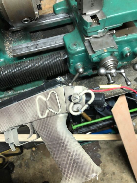

I picked up a CYMA AK47 in the tactical configuration for dirt cheap. I want to add a wood stock for the classic look. I can’t find any wood furniture online however if there is some that is unused could you PM me. I’ve taken the tactical stock off and I’m left with this. I’m not familiar with AK’s so could anyone tell me if my gun can even take wood furniture.
thank you.
Unused meaning surplus to any of you guys. It can be battered I’m not fussy. I just want the classic look. Thank you.
@JME Unfortunately  with this model of Cyma AK you will be unable to get a AK wood stock to fit, to get  a wood stock/ traditional style of stock to fit the AK you need at least one of the two parts circled in red in the picture  attached to get a wood stock to fit and hold mainly the upper stock tang.
The AK in the picture is an E&L model, it dose vary from manufacture to manufacture.
ahhhh I’ll try and source one
Unfortunately as @Sniper780 says thats not a standard mount for an ak.
the one he pictured is the common type for the classic full stock variants. Real surplus stocks still need modified to fit airsoft guns though.
Honestly it might be as easy to try and source a reciever with the right tang than trying to modify things.
To be honest I fully agree with you. As I don’t even know if you could buy a tang. Or maybe I could make one using a wood stock for reference. A new receiver would cost a lot more than what I paid for the gun. Also I’m after upgrading the gearbox to run a 11.1 lipo but I’m not sure what gears I’d need? Are there any special grears less prone to wear? And is the CYMA ak a V2 GB?

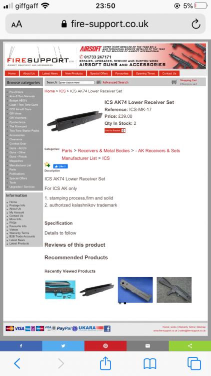

Will an ics take CYMA parts?
18 minutes ago, JME said:
CYMA ak a V2 GB?
Nearly all airsoft AKs use or are based on a version 3 gear box their are acceptations to this. As for the ICS receiver, you linked,  I don't believe it will be compatible with your cyma AK front set as ICS have their own proprietary deign you might be able to modify it but I am not sure how.

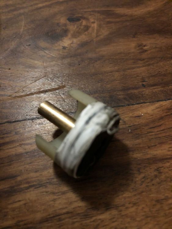

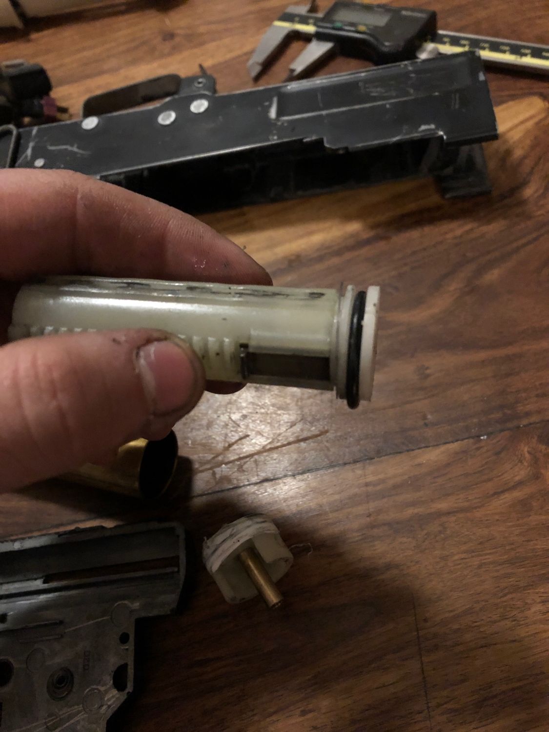

Piston o ring seems baggy. Is this normal and nozzle has ptfe tape over the o ring?? Any expert comments on this and will this be the cause of low 200fps?
thank you.

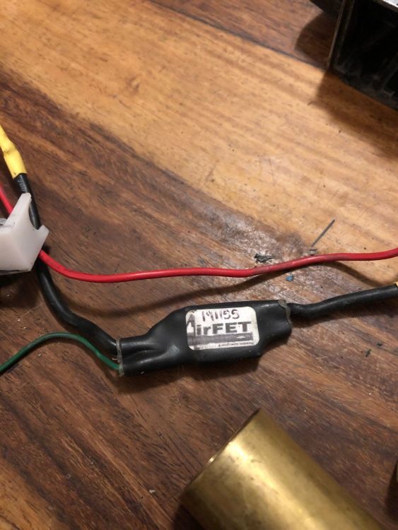

...also, is this a mosfet?
the o-ring should normally be pretty baggy around the piston, it doubles as a one-way valve hence the holes in the front of the piston to help inflate it up.
it should however be a nice fit to the cylinder (worth checking the cylinder bore is nice and scratch free) to give good air seal. also worth ensuring the back face of the o-ring track is clean too (that's the side it's sealing on when firing)
the ptfe tape around the cylinder head is one of the methods of fixing/improving air seal, can be effective if done right although it's a bodge to get around having a good o-ring-cylinder seal in the first place.
if you have a look in the guide i linked there's some pics show how to check the air seal.
as for the mosfet, looks like it, not familiar with the brand but looks like a generic one, good if it works will save arcing on the trigger contacts.
