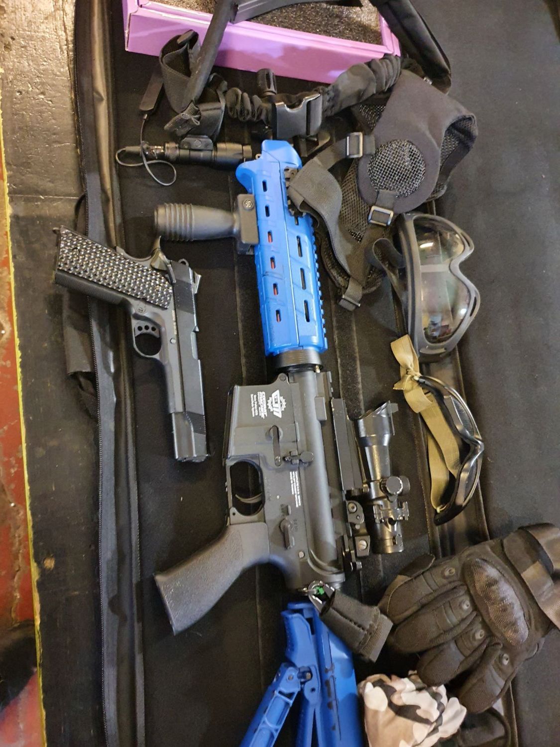

Hi there im new to all this upgrading stuff I have a cm16 mod 0 I'm just looking to get a bit more out of the gun like a bit more range and accuracy i dont really want to go full hog and spend a fortune on it just  Effective mods to help me out

The gun is only a month old and is about 320-330fps
