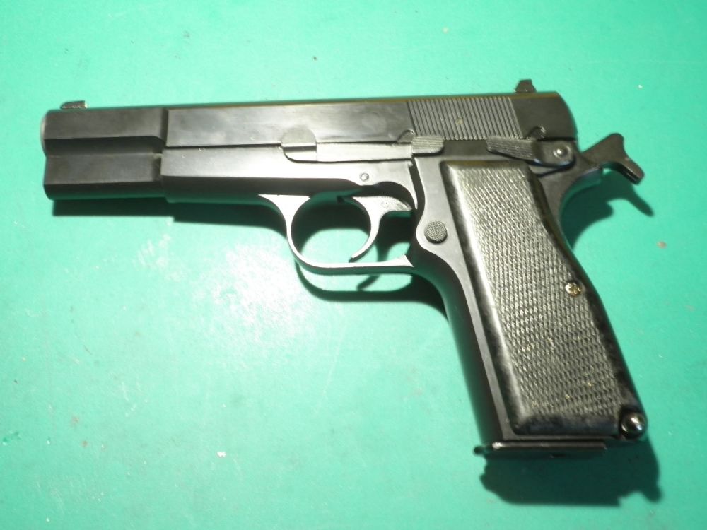

Little bit of fettling required to get them on, and they dont fit with the right hand safety.  I removed mine rather than cut the grips and I've ordered the single safety to fit at some point. Also worth noting that grips for models with the lanyard pin are different to ones without. Helstom rooted through thier grips for me to find 2 sets with the correct lanyard cutout. Happy with the look, prefer them to the late ones it comes with. Now on to trades !

Thanks ! They were very helpful. Rang them for a chat then emailed them with the exact details of what I wanted, had a reply in a couple of hours. Ordered over the phone and with me in a couple of days.
