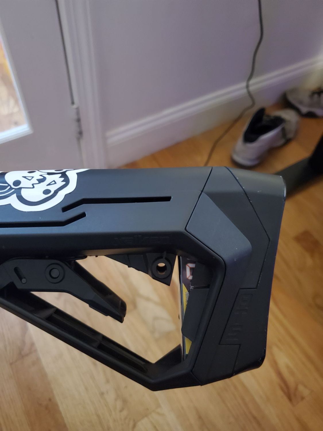

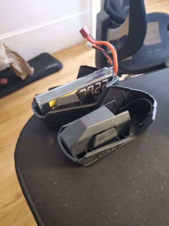

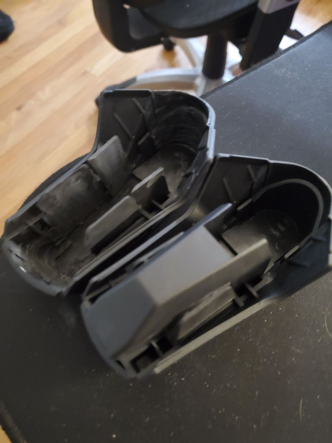

Advanced3 Posted October 27, 2020 Author Posted October 27, 2020 Thanks, The gun isn't short stroked. The sector gear still has all its teeth. I am eventually gonna reshim it, but after an hour that was as quiet as I could get it. Its definitely not battery efficient but it doesn't get hot even when spamming semi auto. I usually run it with a SHS HT motor but had this laying around and threw it in. I have plenty of lipo space as Im not using the ARP9s CQB stock. I have modified the ASG buttstock to hold 11.1 50c lipos. Thanks for checking it out.

Skara Posted October 27, 2020 Posted October 27, 2020 Out of curiosity, where did you get that drop stock adapter?
Advanced3 Posted October 27, 2020 Author Posted October 27, 2020 15 hours ago, Skara said: Out of curiosity, where did you get that drop stock adapter? I got it from Airsoftgateway. Ill be putting the HT motor back in, this was just for fun though. 20201025_151215.mp4
