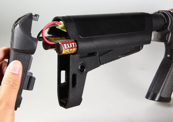

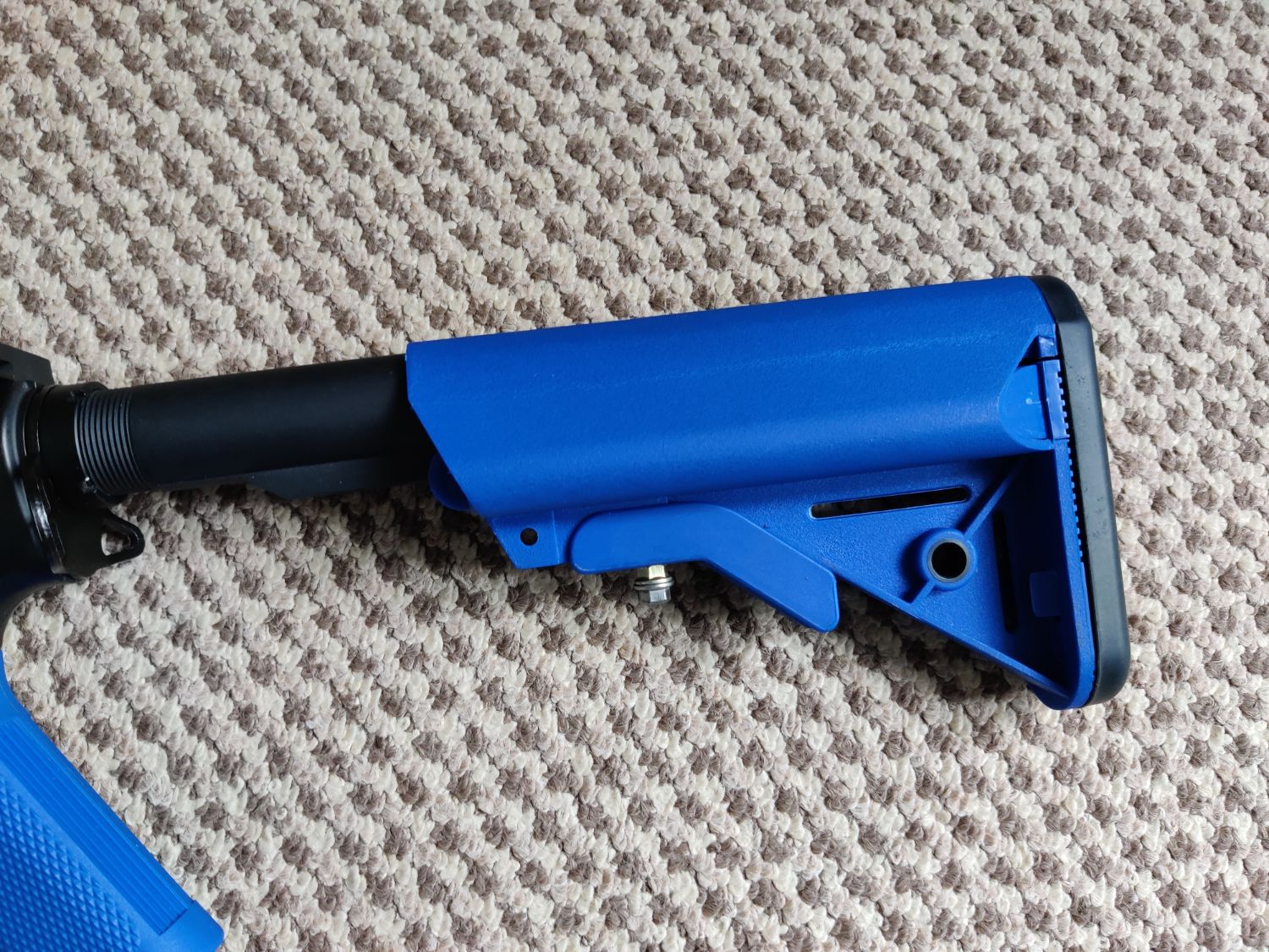

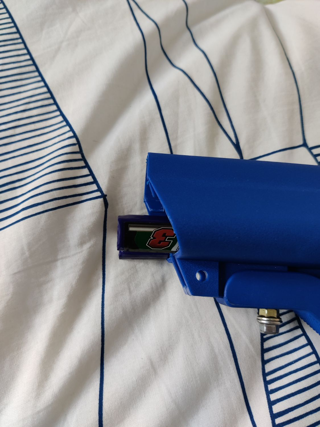

As a final note, the battery sticks out a bit from the back, is there any frequently used solution for this to secure them in the stock?
You'd typically fit a nunchuck / crane stock battery up the sides of the stock like this.
There's no reason that you can't put a battery in the stock tube though, it's just whatever fits best for you.
If the cells are too long, then they're too long, and lesson learned.  I don't have an M4 stock to hand but you'll generally want to stick to cells about 100mm long.  Best to measure your available space before buying - sorry, we should have said.
