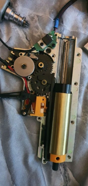

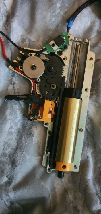

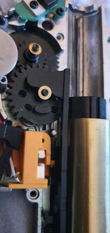

I took apart my gearbox to clean it of sand and now It only shoots 10ft before the bb land. Obviously must be the gear box.

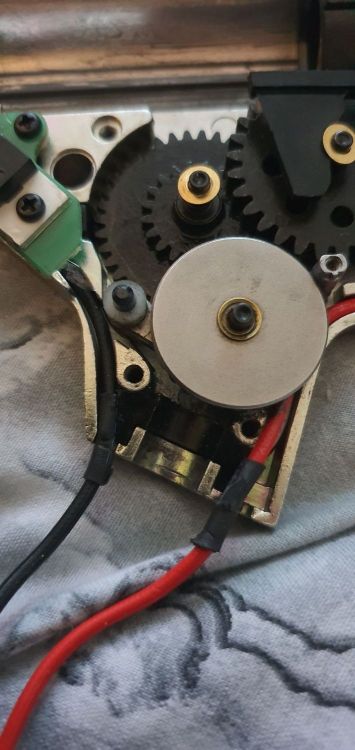

from the pic you have posted your anti reversal latch is in the wrong position it should point down to were the motor comes in to the gearbox
Is the tappet plate slotted into the nozzle? I cant see it in the photo but I am pretty sure its not installed correctly which would cause the FPS loss.
Hopefully this is clear
Cheers just sorted it

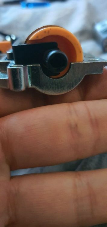

What do you mean? Like this?

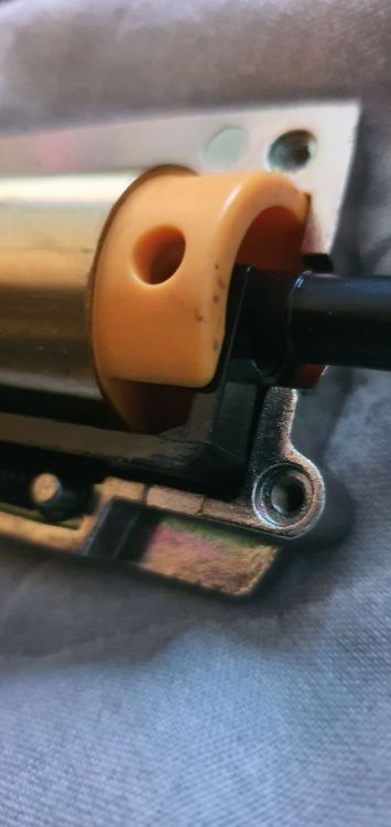

That picture doesn't help much, we need to see the front of the nozzle / tappet plate to see if the nozzle is sitting correctly. The groove at the rear of the nozzle should slot over the plate. and as Keithlag posted your  anti reversal latch is sitting incorectly.
Pretty sure the tappet plate is not in the groove of the nozzle.
Cheers guys that did the trick ? and yeah sand aha there was a trench with sand in it and it got everywhere ? last time I go near that trench aha
