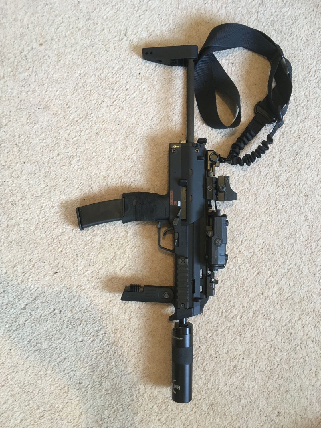

I use TMs version. Fantastic little gun, great for CQB out of the box the accuracy and range is great. I haven’t changed anything other than the furniture. Never had an issue with feeding or leakage from the mags, all in all a solid gun
