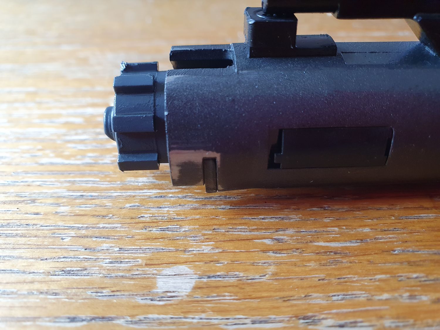

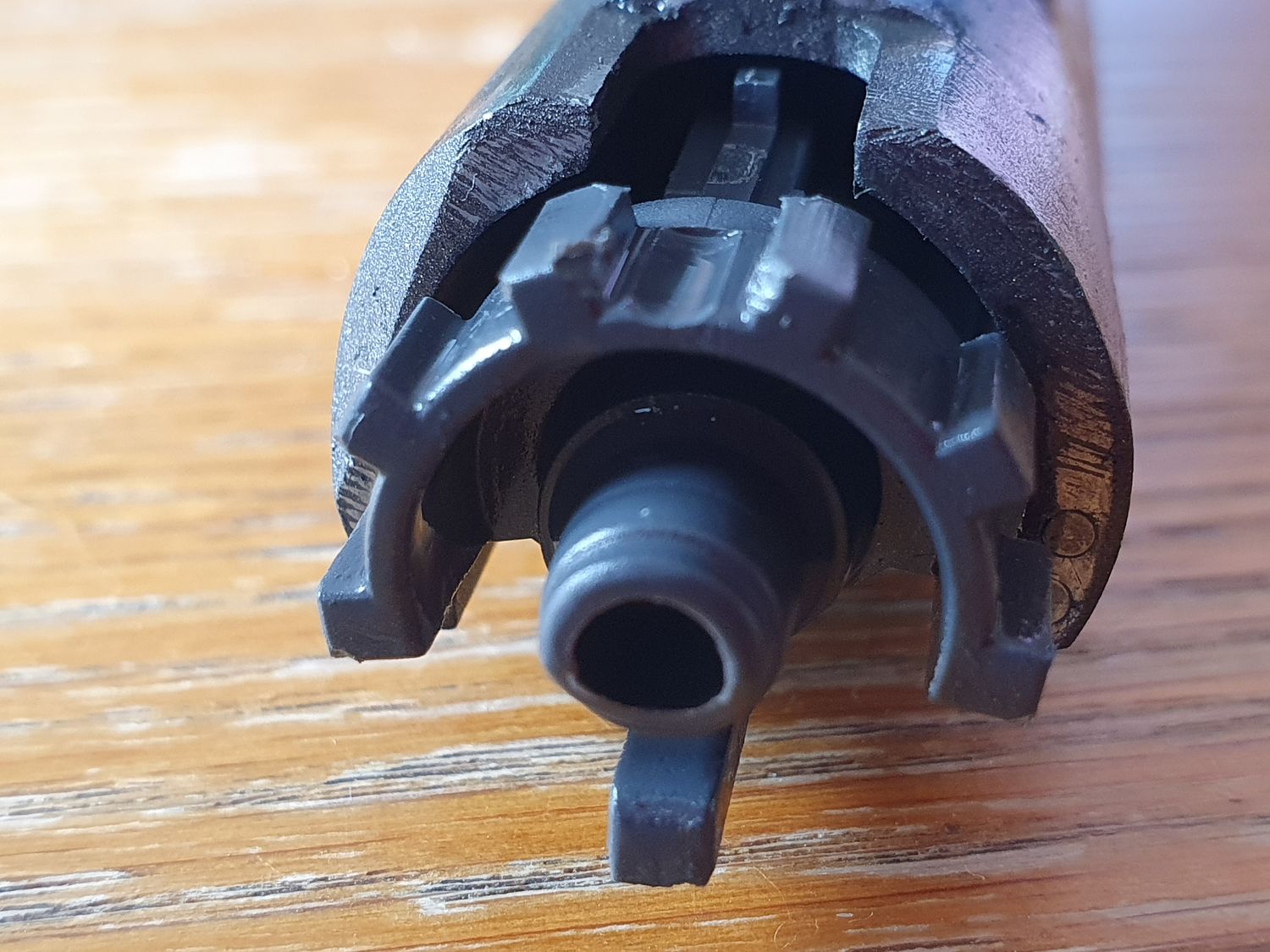

Attached are some pictures of the bolt

It looks well used but nothing broken.
Might be worth cleaning up the fake locking lugs (the two at the top which have been worn/damaged)
Other than that make sure to clean the barrel (and gently into the hop) using the rod with a strip of cloth and alcohol on it.

There wont be an NPAS or similar fitted unless you fitted one. As Edcase said the top lugs on the nozzle do look a bit damaged so could be stopping the bolt going fully home which would cause some issues.  It's a little hard to tell in the top picture , but the rubber (not seen a white one before) looks like it's a little lopsided, although that might be the angle of the photo. GBBRs tend to vary more than AEGs but that's extreme. My money is on a bolt / hop issue. Clean up those lugs and try again, if still no improvement open up the hop unit .

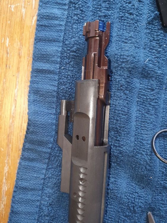

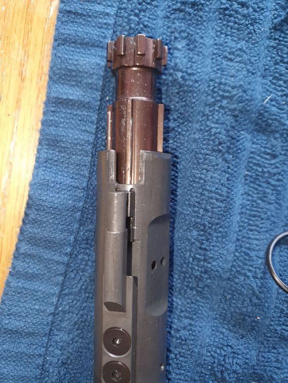

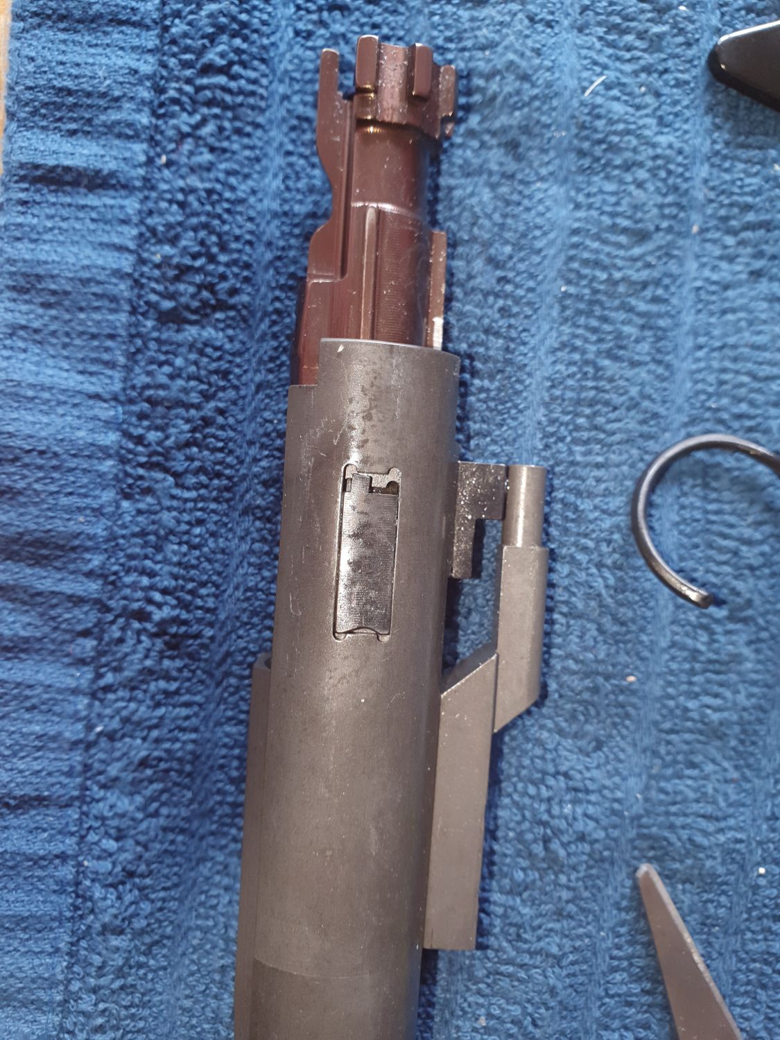

Ordered a new hop up rubber and a complete bolt assembly as I'm working on both of them are playing up! Took it out for a shooting session yesterday and it's shooting really short then good then short again. Hopefully I'll have it sorted for Saturday ?
Well that was an interesting day, ive fitted a new nub and flamingo 60A added a TNT barrel and replaced the standard bolt assembly with a Ra-Tech NPAS aluminum nozzle and steel bolt, took it down to my local shop to check the fps and it ran well however half way through the Saturday skirmish it began to smash up bb's in the chamber and then totally locked up the bolt? before it was put in the bolt was oiled,  I've emailed the people who supplied the bolt skirmshop.co.uk looking for a replacement bolt but not had any reply as yet!

Strange that its the bolt that gone though, its totally siezed up
Its probably crushed BB parts along the sides.
Is the nozzle completely stuck ? wont pull out either ? try removing the guides and see if you can get enough movement to see if it frees off. As EDcase suggested it could well be crushed BB bits jamming it, or I guess the rails on the aluminium nozzle may have gotten damaged and be binding.
It was well stuck, the  guides on each side damaged all the anodised coating off and the nozzle was twisted slightly! Ive returned it now the guys at Skirmishshop?
