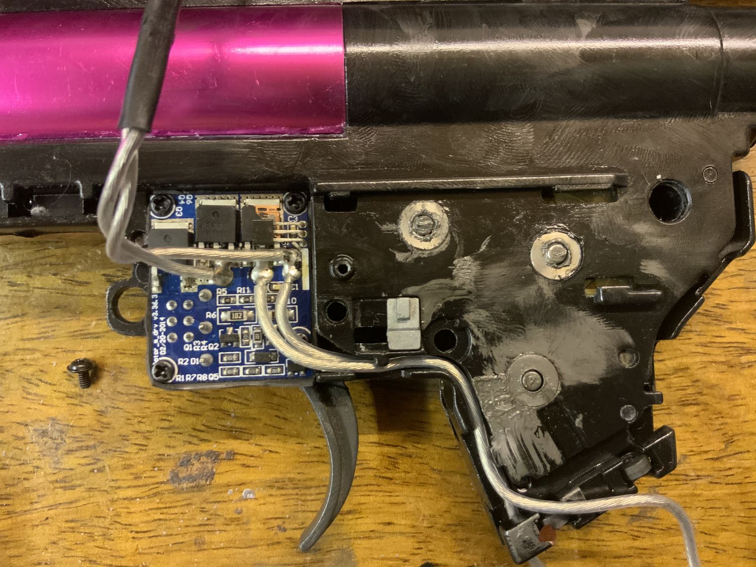

So I have had this work horse for a few years well since 2015 I think, only used as a back up if my Tm 416 or scar went down.
any how my youngest wanted to come to airsoft, so I did the pre game checks the night before. Fully working, only use 7.4v lipo in it, the same one I have all it’s life, the one petrol base sold me.
so on game day it doesn’t work, check the battery wires for a break in them as it’s front wired but it’s solid to the ares mosfet.
check the motor wires same thing perfect, so I get another motor and still nothing.
so I strip the gun and have a look at the gearbox, to see this.

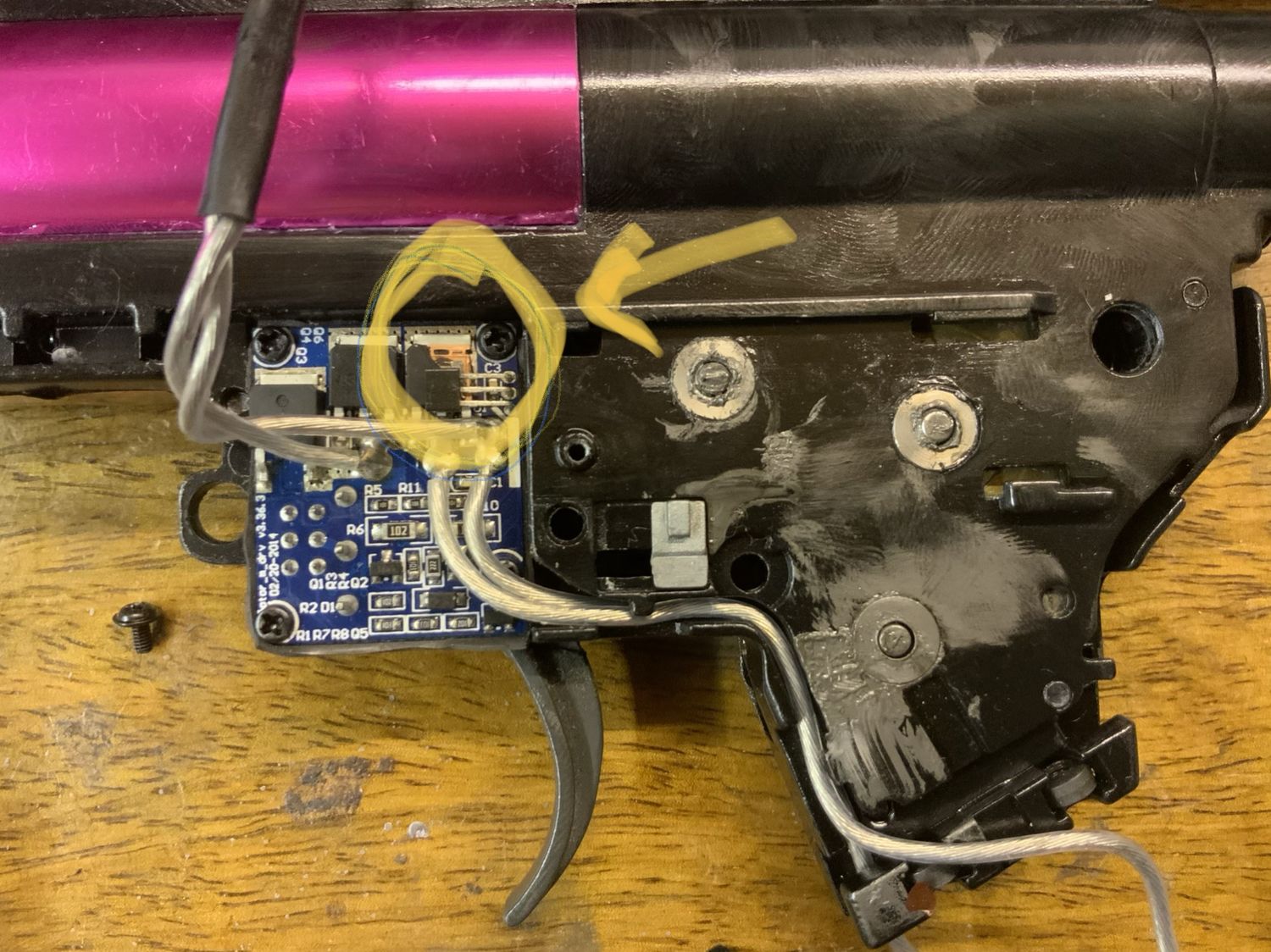

the resistor or whatever it is has broken.
anyone have any experience in this? It’s bizarre as the gearbox moves freely and when I use another switch and the motor turns the gear box.
the mosfet is £44 to buy new.
I am lost for words right now.
I'd get new bushings as well, yours are done for. Get some bearings.
And yes, new FCU. Because Ares and their shit QC.
What a pain in the Ares..and £44 for one of their crappy fets.  The gearbox looks to have the same dimensions as the ZCI spare I have sitting here with me but mine uses the older micro switch, at least you can replace them for £2.  Not sure if a TM spec shell will work.  If you need a video of the replacement I have here let me know.
https://www.bullseyecountrysport.co.uk/ares-airsoft-efcs-001-electronic-fire-control-mosfet-m-series-front-wired-19740-p.asp
might need one of these...
https://www.bullseyecountrysport.co.uk/ares-amoeba-electronic-gearbox-programmer-efcs-34645-p.asp
but wtf did you do to it ???
did you drop it (down a waste disposal unit) ???
lot of money for a few bells & whistles - I'd consider to go old school with something less bespoke inside/outside
basic mosfet or warfet or something
I'm pretty sure other brands boxes need some filing here and there to fit inside an Ares body.
The P* Fusion Engine (and its Valken clone) surely does.
The cheaper option, all things considered, is to just buy another FCU.
Or, if you have a skilled friend, you could try to replace the thing that broke.
