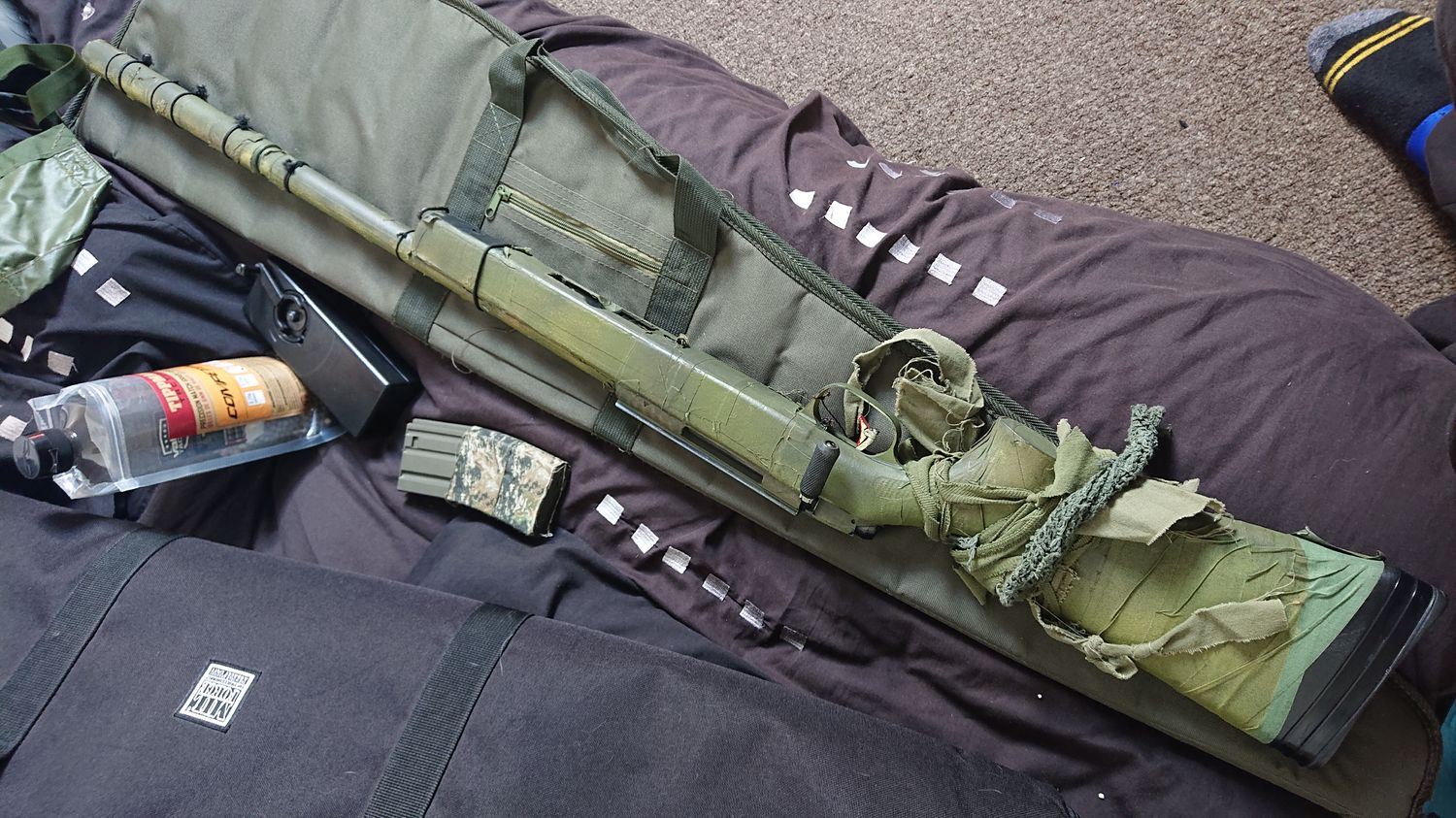

PickaxePete Posted July 1, 2020 Posted July 1, 2020 Digging my old kit out of storage for a tidy up / possible sale. The stock cylinder I had with my APS2 EX has unfortunately given up the ghost. The stamped cylinder / bolt handle connector are almost falling apart. Any leads on a good replacement? Finding it hard to find APS2 parts these days! Ideally, I'd want a cyldiner pinned at the bolt handle end, rather than stamped metal. Something capable of upgrading spring inside woudl also be great. I've already got a lot of upgraded parts (All LayLax - zero trigger, barrel, bolt handle, cylinder head, inner barrel), spring guide), so some leads on the following would be great: * Upgrade Cylinder * Upgrade Piston Will check my hop out too, as I think that may not have been upgraded previously - was bought / upgraded about 10 years ago and my memory is not that great! ? Any advice welcome. Lee

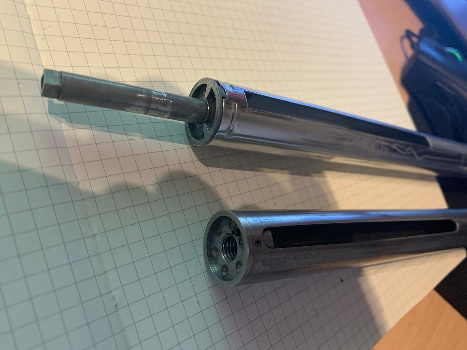

PickaxePete Posted July 7, 2020 Author Posted July 7, 2020 Yeah - I hear ya. Actually in a bit of a bind now. + side, I found an APS 2 cylinder at wolf armouries. great! - side, I found another box of airsoft kit with a cylinder in right after I ordered the one from wold. boo! I knew i had one somewhere.... Thought though please gents. I can return the wolf armouries cylinder (when it arrives tomorrow probably), and recoup my costs (minus shipping) but the cylinder I found is missing the bit that threads through the bolt handle. pic attached... Any ideas if that is something you can buy / obtain? what's it even called?! Cheers for the input so far. Lee On 06/07/2020 at 14:55, heroshark said: I'd shift it on (if you can) and start a fresh if your not being nostalgic and precious . The aps was top in the day but you'll get a better performing cheaper setups now without a bolt you need an ox to pull. Problem is that its not currently operational and I'd expect a very low return on all the package. I'll give it a few more goes to get it rocking or cut my losses and allow someone else to pick it up as a project gun. CHeers Lee
Hudson Posted July 7, 2020 Posted July 7, 2020 Getting that part alone is likely more hassle than the cylinder. I'd just keep the new one and start from there. At the least, it'll be in better condition.

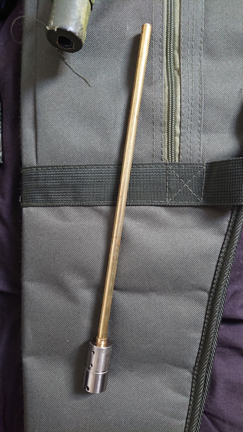

Hudson Posted July 24, 2020 Posted July 24, 2020 I finally remembered to actually do some more on this, so thought I'd give a quick update. Started with an old KM-Head adjustable hop unit. It takes its own style barrel & bucking with no idea on anything that might fit. However, I tried replacing it with a VSR style barrel & bucking, only with the little tab cut off the side of the rubber. It just about fits, and seems to seal! I'm getting between 407 & 412fps on a 0.20 but no idea on how well it will actually shoot.
