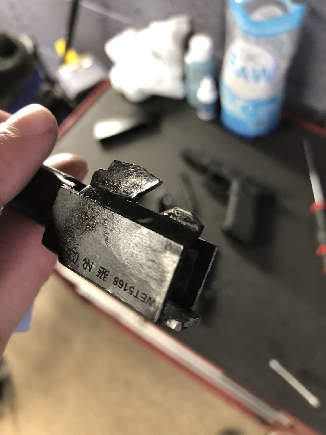

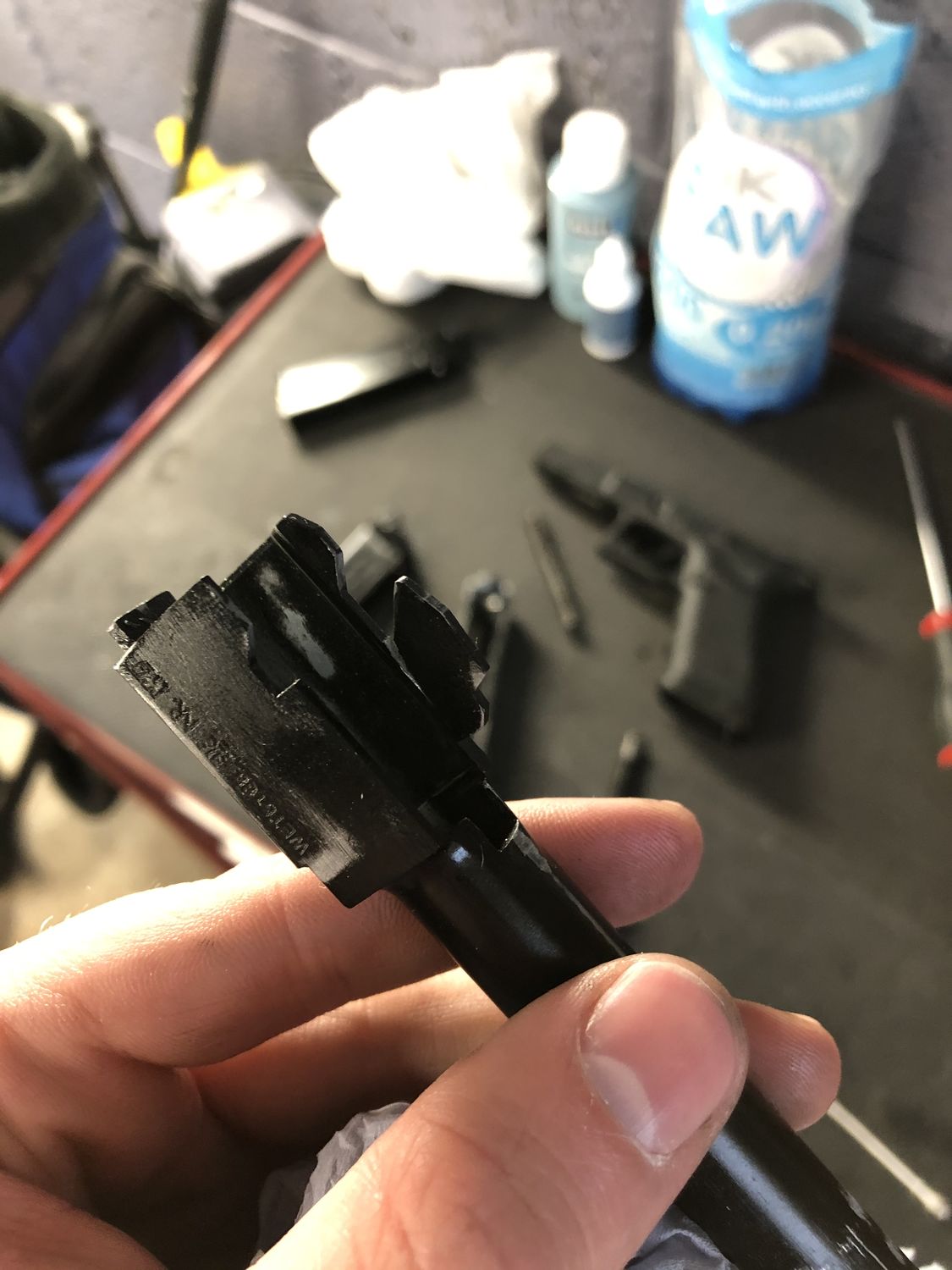

Iv since taken it all to bits again and noticed this damage on the outer barrel.. Iv ordered a new barrel to hopefully fix this issue..
I just can’t see how this would be related to not allowing the gas into the pistol but it’s worth a try.. any thoughts?
Aby help appreciated!
So when you rack the slide it loads a BB but doesn't fire when you pull the trigger ? what does it actually do ? does the trigger 'click' does it release gas ? Did it work correctly before the service ? Paint wear on the barrel isn't uncommon to be fair.

I reckon it’s something to do with this damaged outer barrel not letting the slide go fully into place or something. But that’s just a guess

I literally just got them as an add on for an order! I think it’s replace the other barrel since it’s actually cracked and then try new Bbs!
