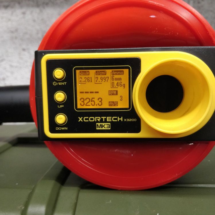

Well, it was a lot of pissing about during a  planned late night "tech session" as I'm on nights tomorrow / today (Saturday), but after installing 6 power up washers and replacing the hop rubber (Autobot 60°) I now have.....
**Drum roll please**
My limit was 329.7 FPS with 0.46g so I'm as close as I'm willing to get. Obviously it'll drop a bit once the bucking has bedded in.

And yes that is a baby milk powder tub I've got my chrono housed in!
