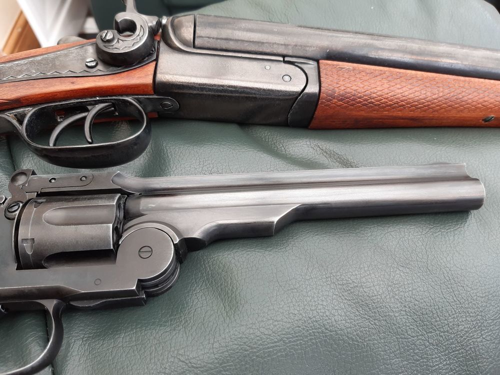

I've been into using Birchwood Casey's aluminium black for a few years now. Works on zinc alloys a treat.
It has been giving a better than paint, but not quite there finish since I've been using it, following instructions, looking on threads where people have used it on the rpf ect.
I've been experimenting with it, and today I've had a bit of a result.

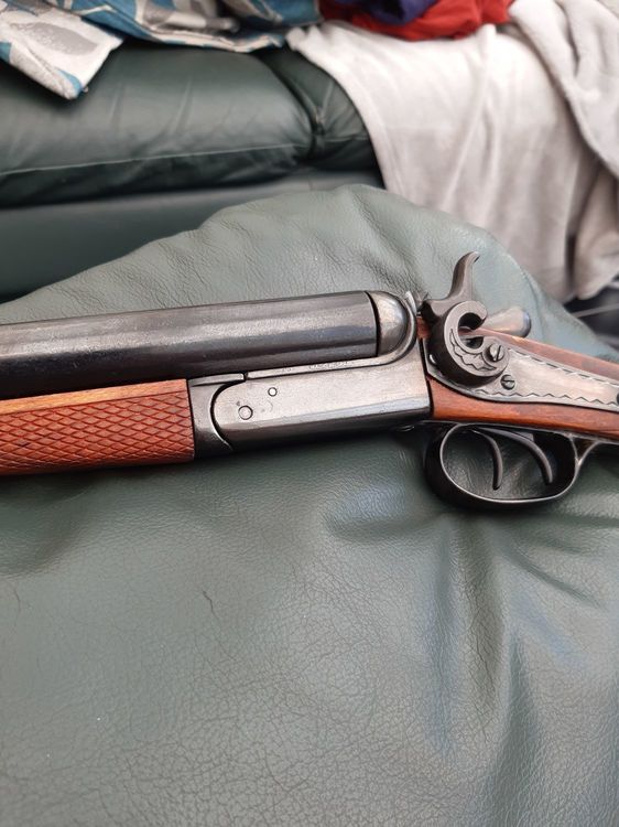

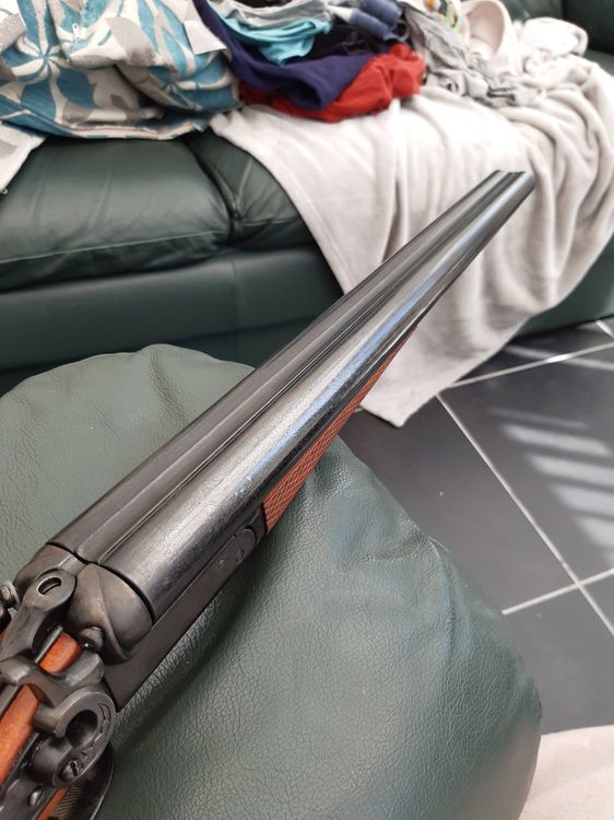

Warm metal parts, kept warm throughout the process, cleaned with acetone, apply the blackener with a cloth. Give it a couple of layers, dry off the excess.
Almost immediately after, I've been using t cut scratch remover, same cloth, polished the surface. It really now does look like gunmetal. We're all bored at home, it's easy and it looks so much better than paint.
On the last photo you can see dull bits around the frame that haven't been finished at the time of the photo.

How does it hold up? Is it a durable finish at all?
Yes it is, though if you were to scratch it  it's dead easy to touch up.
