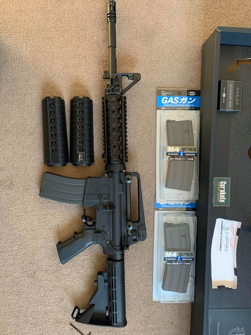

Well this just got expensive. Started off life as an M4 carbine already had the mws handguard fitted and a friend has done the 'biro mod' as well as a few other bits before I take delivery and really make it my own

Wrong thread?
