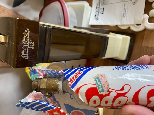

Hi folks I have the older (ancient!) soda stream tanks which are smaller to carry round, is there an adapter which covered these? I don't know what the thread is called just that it's considered Au/Nz fitting. Even if these could be removed and swapped for the newer ones that would be great. Anyone had any success with either? (An adapter or swapping the threads). Thanks. (Sorry about image orientation, don't know why it turned and can't seem to edit it)

The Palmer link above should still be the same for the old classic sodastream threads
Nice Bejam price sticker
Cheers for the quick response Tommikka, aye I didn't want to mention the Bejam tag to show my age! ?
Had a look through that link and didn't see a mention of the older ones. Do you know what the fitting is called?
