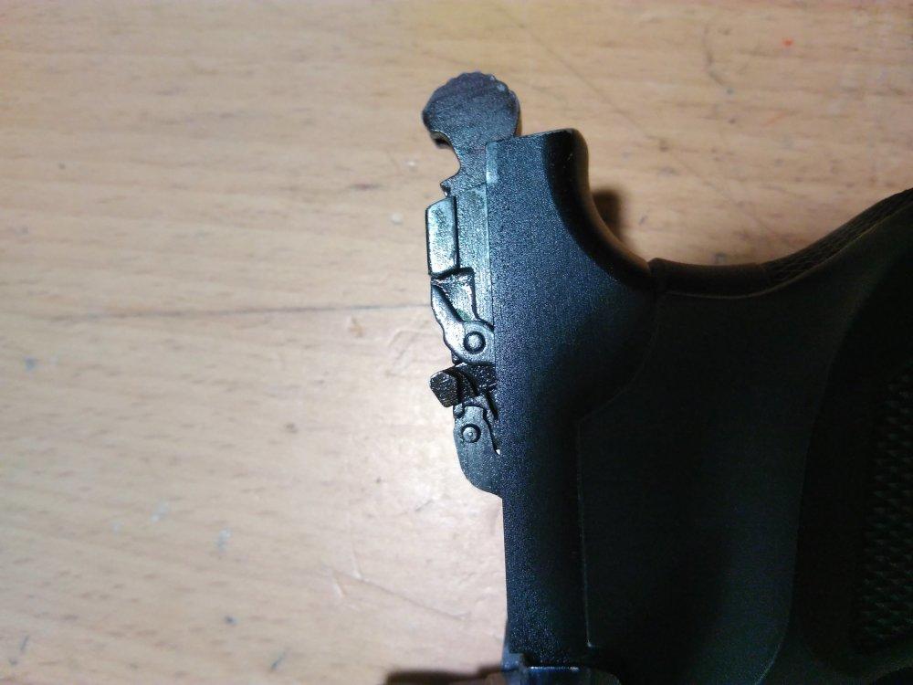

I did take some video but its too long to upload.  1st pic wont fire, second pic the bar is up far enough to fire but once you pull trigger again it wont work
Trimmed it down

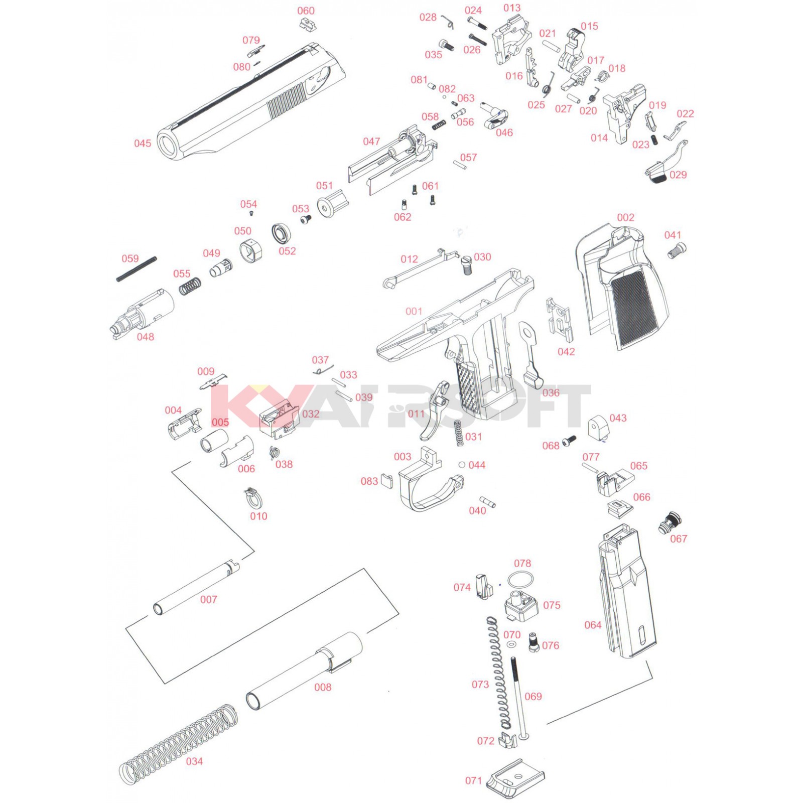

There is meant to be a very small leaf-type spring under that sear bar.
I'll try to take pics if Hamster doesn't beat me to it
Thanks, maybe I did lose something afterall - part 28 I am guessing?
EDIT - And just found the little sod on the carpet - lucky!  Helps to know you are missing a piece thanks Ed.  Now any help on getting it all back together?

getting it together is a bit of a pain, a bit of a tip is don't worry about getting the slide catch in with the trigger unit, with a bit of twiddling you can get it in afterwards.
that spring (28) is a pain, but there is a groove in the bottom of the trigger bar that it sits in quite nicely once you've got it in there.

Got part 28 in easy. Not sure about the other side.  Is this the right setup?
That looks about right (edit) scratch that it should be down at the front, the arm is part of the decocking mechanism, if you push it it should move the striker up out of line with the mag.

A note fitting this bar
Make sure it engages the tab at the bottom of its travel.
You'll see if you look inside where it fits in.
