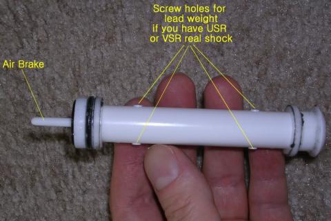

There are softer/silent piston heads
and only bolt snipers an air brake that at last few mm's plugs the hole to brake/brace for impact....
Image result for airsoft sniper airbrake
Not really an option fitting an air brake head on a snappy responsive AEG on auto
perhaps slight short brake for DMR but really air brake heads are for single bolt snipers tbh
But yup they do short air brake AEG piston heads for DMR but never used them myself
The idea is that the piston gets slowed the last say 5/10mm prior to impact
Not wise on an AEG cycling quickly - even on semi, the sector will mesh with piston
So a big brake is not wise, only a small tiny brake say on a DMR is a possible option...
