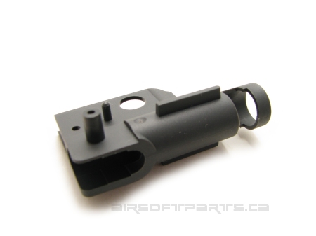

Supporters Monty Posted June 15, 2013 Author Supporters Posted June 15, 2013 Are they new Mag's Monty? May just be a case of loading and unloading them a few times to wear the springs in. Also, if they're not very firm in the magwell you could try a bit of eletrical tape on either side at the top, this usually works to help feeding problems with other magazines. Failing that, if you're set on Emags and prepared to spend the money you could change your hop unit and see if they feed better with an alternative. Someone feel free to correct me if I'm wrong on anything, still learning myself They're really tight in the mag well, no wobble at all. BB's come out of the gun when I remove the mag, but the hop up doesn't look like a regular m4 hop up, it's like this. I've oiled the magazines and loaded/unloaded bb's from the magazines, but it still doesn't feed. Nutster, they're the 70 round emags,
AirsoftTed Posted June 15, 2013 Posted June 15, 2013 Perhaps they're too tight? I had to put some tape on a magazine for my G&G CM16 to get it to fit, tried the same mag wiith the tape in my G&P m16 and it wouldn't feed. That hop-up doesn't look like anything I've seen, maybe changing the hop-up unit is what you need to do for it.
Supporters Monty Posted June 15, 2013 Author Supporters Posted June 15, 2013 Perhaps they're too tight? I had to put some tape on a magazine for my G&G CM16 to get it to fit, tried the same mag wiith the tape in my G&P m16 and it wouldn't feed. That hop-up doesn't look like anything I've seen, maybe changing the hop-up unit is what you need to do for it. Yeah, I'll try to get some better pictures tomorrow, the magazines fit not too tight, but tight enough for them not to wobble too much. I guess I'll have to buy a new hop up. The current hop up's feeding nozzle is attached to the lower receiver, it's quite a bizarre design for a hop up.
Supporters Monty Posted June 15, 2013 Author Supporters Posted June 15, 2013 Well, here's the hop up. http://www.zerooneairsoft.com/product_info.php?products_id=4328 Quite a strange design!
Supporters Nutster Posted June 15, 2013 Supporters Posted June 15, 2013 If you look inside the magwell, there are some molded 'ridges' along the sides, filing those down a little should help with the tightness, and may solve the miss feeding. Your hop is the standard 2part TM hop, and without modding the body, you're kinda stuck with it
