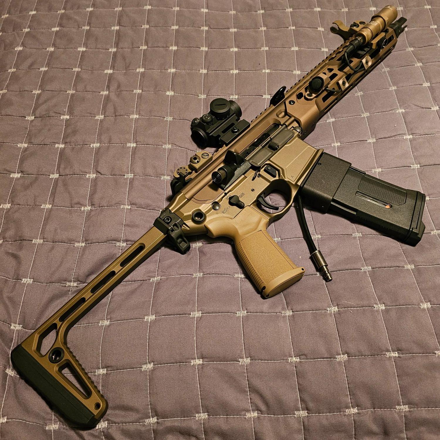

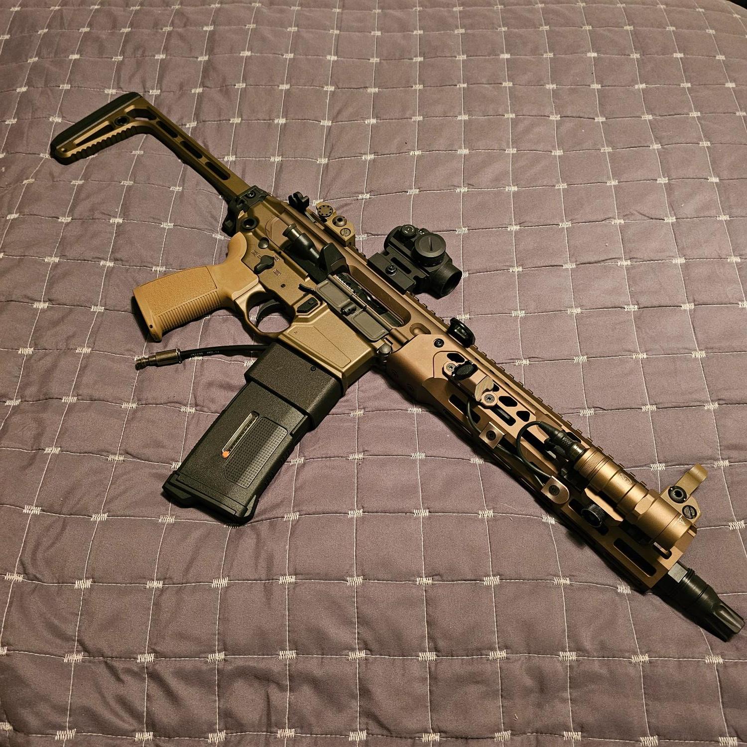

Barny Posted January 28 Share Posted January 28 I'm not sure if i'm going to be much help here... Very new to GBBR, and not exactly a whizz with hpa either! This is an APFG MCX Spear, which i believe is based/made by VFC. Its got the Airtac VFC adapter in it with a PTS short 170rnd mag. Plays nicely at 120psi on the regulator which is handy as my DMR's are set to that too. The npas was removed as it fell out whilst tinkering and i've not bothered to put it back in yet. Ive since fitted the winter springs as recommended on this forum but i appear to be getting bolt bounce so may swap these out and/or refit the npas. I've not used it in game yet so ive no idea how it will perform. Thinking of spraying the adapter tan to blend it in a bit too Link to comment Share on other sites More sharing options...
GiantKiwi Posted January 29 Share Posted January 29 13 hours ago, Barny said: I'm not sure if i'm going to be much help here... Very new to GBBR, and not exactly a whizz with hpa either! This is an APFG MCX Spear, which i believe is based/made by VFC. Its got the Airtac VFC adapter in it with a PTS short 170rnd mag. Plays nicely at 120psi on the regulator which is handy as my DMR's are set to that too. The npas was removed as it fell out whilst tinkering and i've not bothered to put it back in yet. Ive since fitted the winter springs as recommended on this forum but i appear to be getting bolt bounce so may swap these out and/or refit the npas. I've not used it in game yet so ive no idea how it will perform. Thinking of spraying the adapter tan to blend it in a bit too Did you shorten said winter springs to 230mm? Link to comment Share on other sites More sharing options...
Barny Posted January 29 Share Posted January 29 10 hours ago, GiantKiwi said: Did you shorten said winter springs to 230mm? No, i just swapped 'em straight in. Assumed the softer rate would offset against the longer 300mm length. I'm guessing i should? Link to comment Share on other sites More sharing options...
GiantKiwi Posted January 30 Share Posted January 30 17 hours ago, Barny said: No, i just swapped 'em straight in. Assumed the softer rate would offset against the longer 300mm length. I'm guessing i should? Recommended on HRC is to make them 230mm long, to stop misfeeds - which is typically caused by bolt bounce. Barny 1 Link to comment Share on other sites More sharing options...
