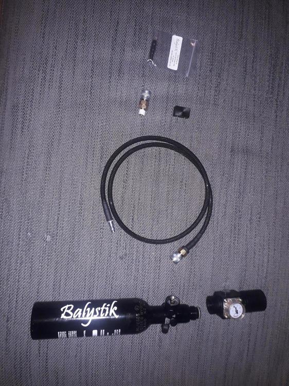

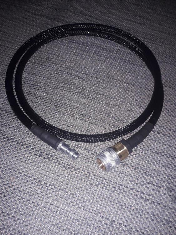

So I finally sat down to fit all the parts but it's dawned on me that I don't actually know what I'm doing. I've screwed the regulator onto the tank but further than that I'm not sure what comes next so to put it bluntly, HELP20241201_135909.thumb.jpg.430d69620f7b94b53b81e999a839433f.jpg
20241201_135923.thumb.jpg.101e8eb39f5b33753eb393c858a837b2.jpg20241201_135937.thumb.jpg.0dcec5ba575fdc1d2cf9532402cd921b.jpg
