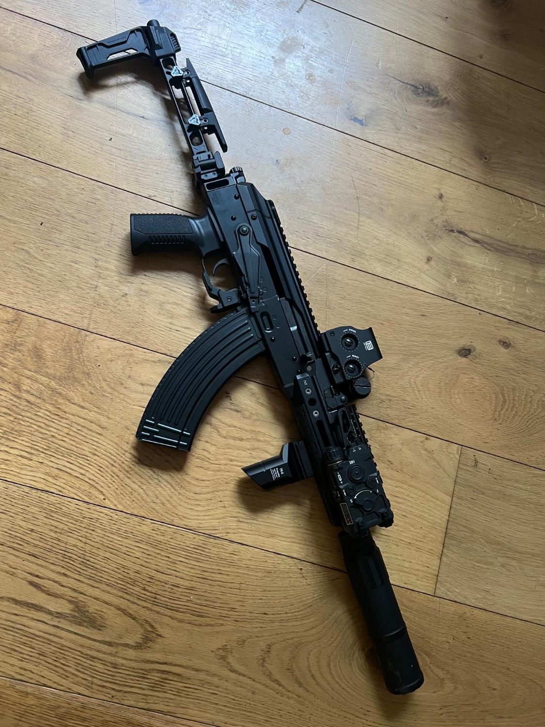

Popular Post zizivert Posted October 2, 2024 Popular Post Posted October 2, 2024 So I bought my second GBBR… UK-Recce, B6_tactical, Llewestymest and 7 others 9 1

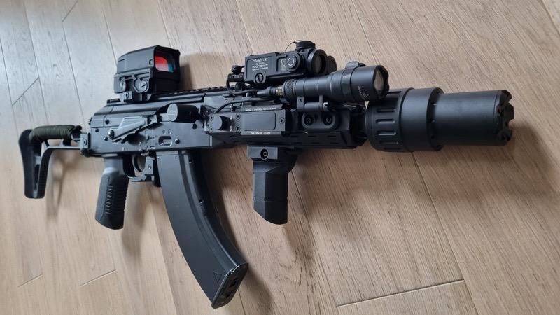

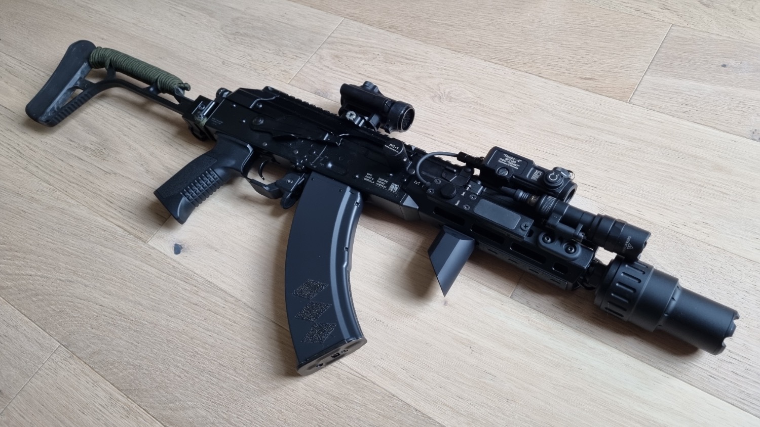

zizivert Posted November 25, 2024 Posted November 25, 2024 So, this is the last version of my Akx. I didn't want to do the same as my m4 Mws so I only changed internally/externally what seemed really useful and relevant to me. I bought it with M.L rubber and crazy jet inner barrel so I installed the Jaeger précision hop up arm. I have the angry gun heavy piston and 130% recoil spring but i didn’t installed yet. Maybe at next summer. Externally i replaced the uh-1 by a copy of Vzor-1 by Novus, customised the switch for the perst4 to create an mlok version, replaced the front grip by the wiitech rk-6l and put grip tape at the bottom of my mags. It’s so heavy in comparison with my m4 Mws but god, this is my favorite GBBR, really love it.
EvilMonkee Posted December 5, 2024 Posted December 5, 2024 On 25/11/2024 at 14:38, zizivert said: So, this is the last version of my Akx. I didn't want to do the same as my m4 Mws so I only changed internally/externally what seemed really useful and relevant to me. I bought it with M.L rubber and crazy jet inner barrel so I installed the Jaeger précision hop up arm. I have the angry gun heavy piston and 130% recoil spring but i didn’t installed yet. Maybe at next summer. Externally i replaced the uh-1 by a copy of Vzor-1 by Novus, customised the switch for the perst4 to create an mlok version, replaced the front grip by the wiitech rk-6l and put grip tape at the bottom of my mags. It’s so heavy in comparison with my m4 Mws but god, this is my favorite GBBR, really love it. Whats the surpressor?
zizivert Posted December 6, 2024 Posted December 6, 2024 Foam only https://www.patrolbase.co.uk/5ku-tactical-sf-9x19-flash-hider With tracer unit https://www.taiwangun.com/fr/traceur/traceur-tactique-sf-9x19-spitfire-cache-flamme-5ku There is also a version with white marking. Mine is full black without any marking. https://www.sixmm.com/fr-fr/products/5ku-mpi-kp-9-airsoft-flash-hider-14mm-ccwblk EvilMonkee 1

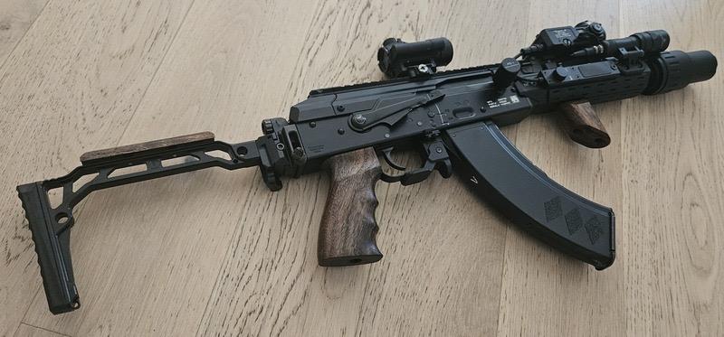

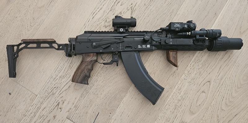

Popular Post zizivert Posted August 10 Popular Post Posted August 10 (edited) The last version of my akx. I replaced the laylax stock for the JMAC SS8-RP + JMAC folding system and added handcrafted wood parts: rizer, pistol grip and front grip (copy of the zenitco rk-6l). Edited August 11 by zizivert LMKipper, MistakenMexican, ButcherBill and 2 others 4 1
MistakenMexican Posted August 11 Posted August 11 19 hours ago, zizivert said: The last version of my akx. I replaced the laylax stock for the JMAC SS8-RP + JMAC folding system and added handcrafted wood parts: rizer, pistol grip and front grip (copy of the zenitco rk-6l). Very nicely done with the wooden furniture ??
