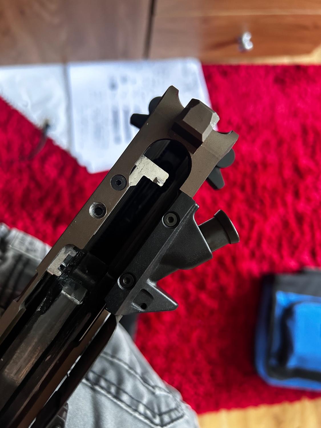

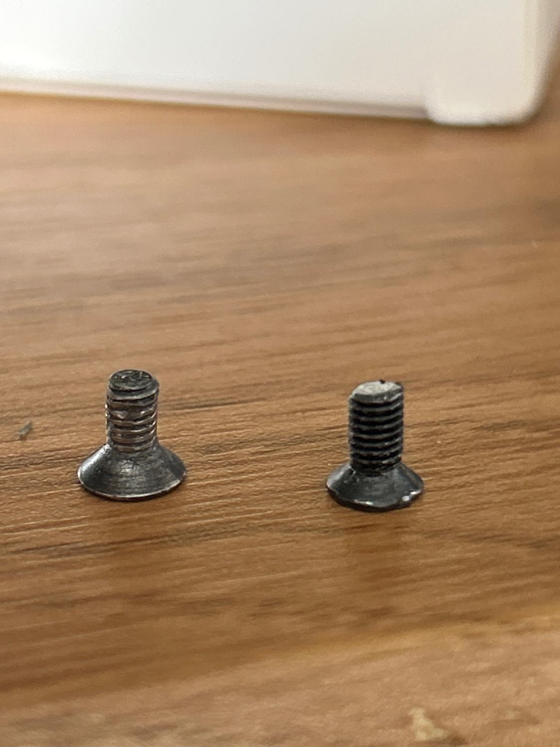

WilloJay Posted June 16, 2024 Posted June 16, 2024 Hi all, recently ran into some problems with my APFG Spear so I thought id let everyone know so it doesn't unfortunately happen to you lot! It's been running perfectly and still is however there are two screws holding in the hammer connecting level and one has stripped out of its thread. This has happened on both mine and my mates spear so it looks like a manufacturing issues as the screws look way to short to get a proper grip. Factory both mine and his came Loctited but eventually stripped. I would recommend either using glue or some other method of ensuring the screw stays in as it looks like this will happen on MOST spears. At the minute I'm unsure if this happens on the rattlers but looks likely. Currently I am trying different screw lengths to see which will work the best and I may need to drill and tap the hole to a bigger thread if none of the original thread is usable/left. Below is a picture of the screw that has come out, a good way to tell if this has happened to your is that the upper and lower may be difficult to join together again. I will update if I find a solution, I have created this as a topic so if anyone else has issues and remedies they can attach it here, remember we all can help each other out! TubTub 1

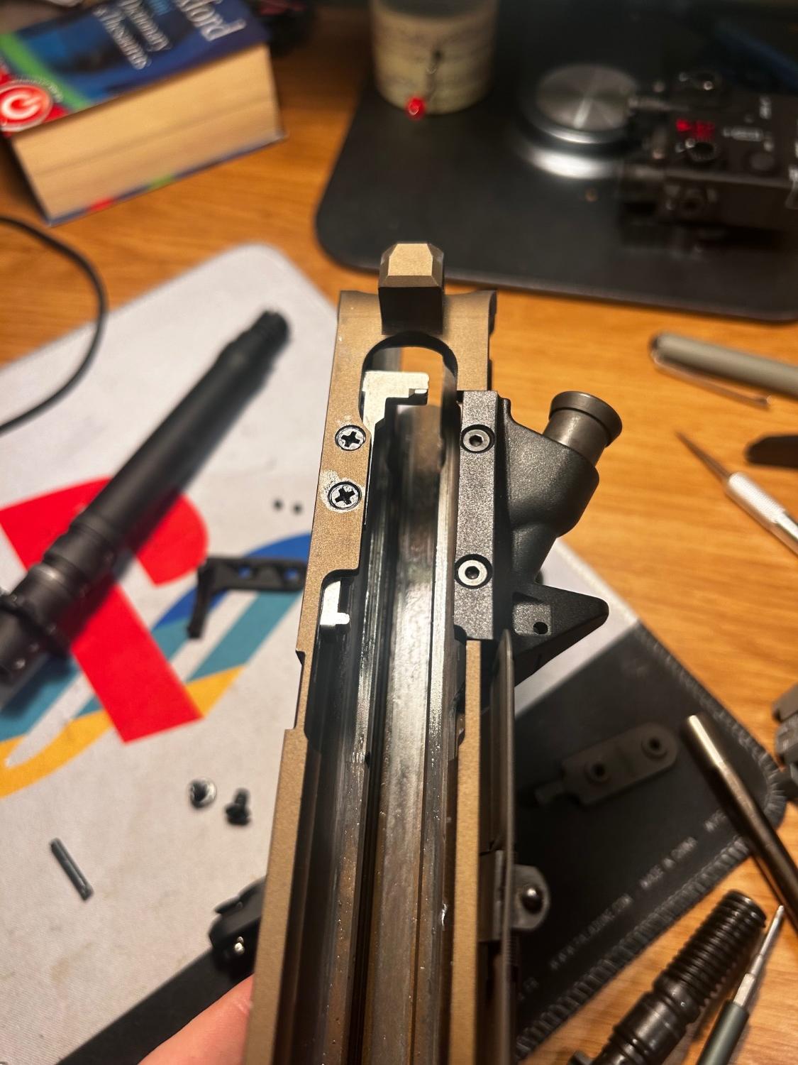

WilloJay Posted June 17, 2024 Author Posted June 17, 2024 (edited) Update! I ordered M3 screws that were 8mm thinking they would be long enough but where too long so I cut them down slightly, they sit in a bit more providing more depth. Looking at the original screw the thread is demolished which is odd from factory. The picture left is the old one, the right is the new one. I’m going to replace both then test for a game day see if the thread gets destroyed on the new ones as well Edited June 17, 2024 by WilloJay acrxil, Nick G, TubTub and 1 other 3 1

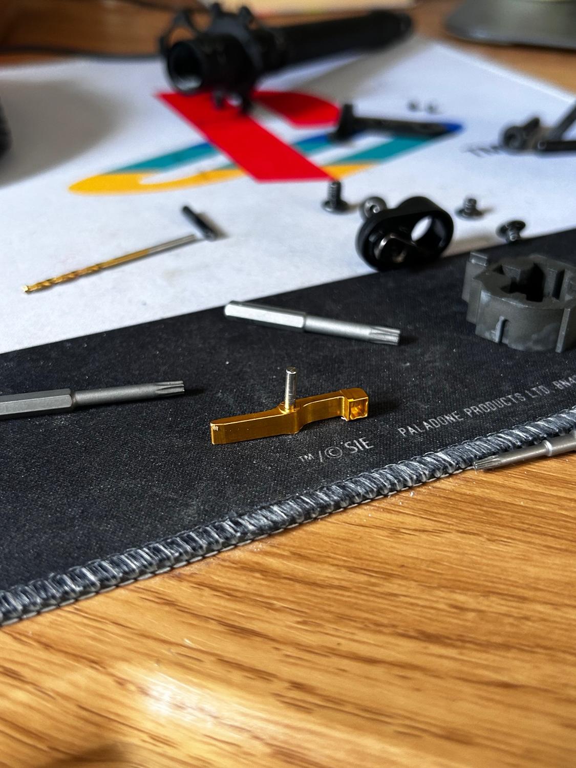

Popular Post WilloJay Posted June 18, 2024 Author Popular Post Posted June 18, 2024 (edited) Babe wake up new APFG update, Okay yet another post, I've been busy. So the screws work perfectly so far with testing, I've also swapped out my maple leaf Mr hop 50 degree out for a flamingo 60, this was because I found that with the combination of Mr hop and crazy jet barrel the bb was getting seated slightly differently each time causing inconsistent hop affect . So far the flamingo has been much better however I haven't shot many shots through it. Also installed the GSI mcx hop arm with their soft nub, The tolerancing of the hole that the pin for the arm sits in was way too small so I drilled using a 2mm drill bit it out until the pin sat in snugly. The GSI hop arm is better as it has a flatter contact patch, as oppose to the original arm which has a thin rounded metal part which causes inconsistent bb hop especially when the power changes (very bad as GBB are always slowly loosing power). Also another thing to note is the JWI hop unit is a very snug fit in some spear! If there are anymore things I discover I will post them here Until then Enjoy! Edited June 18, 2024 by WilloJay Jacob Wright, TubTub, acrxil and 3 others 4 1 1

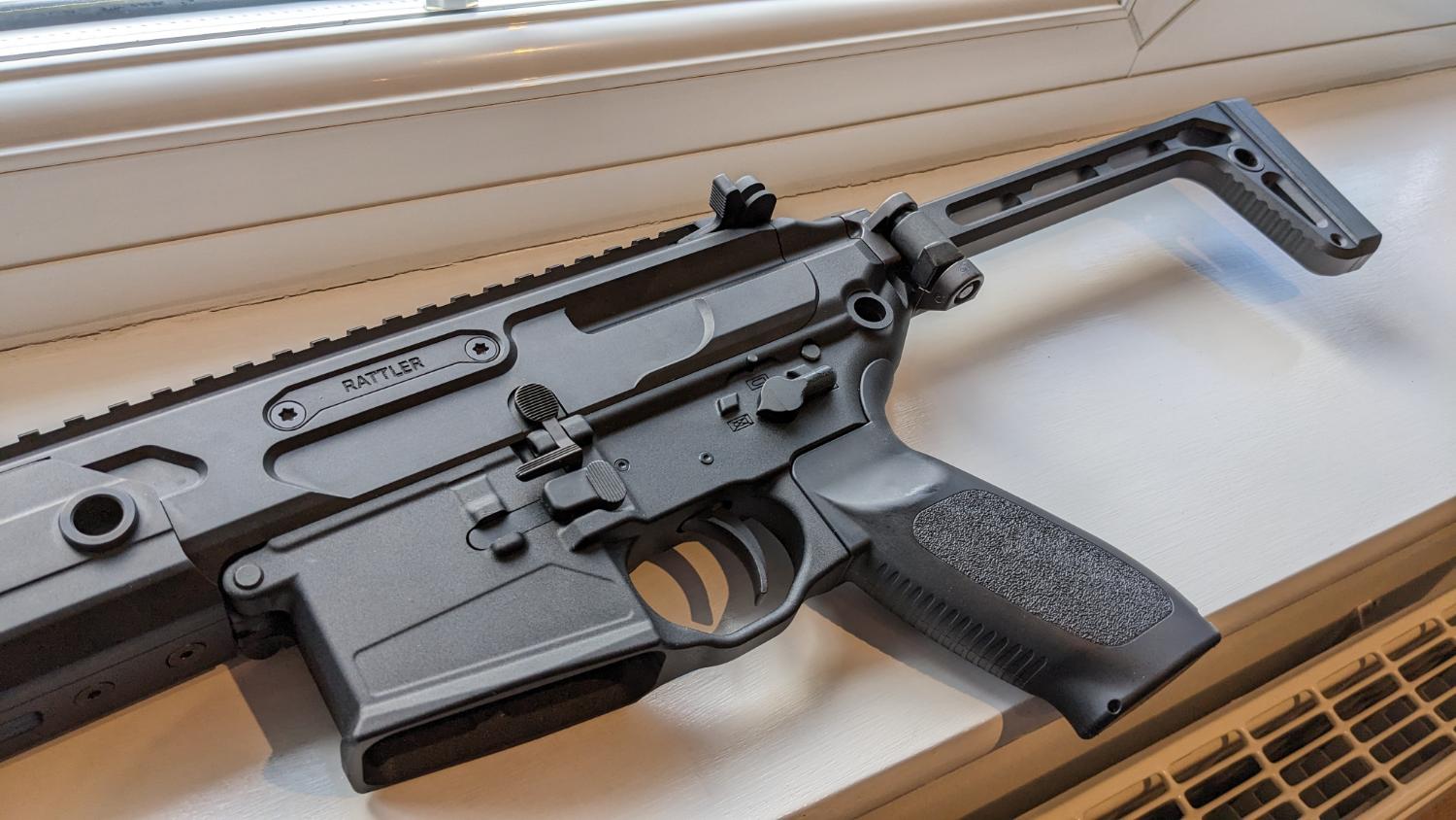

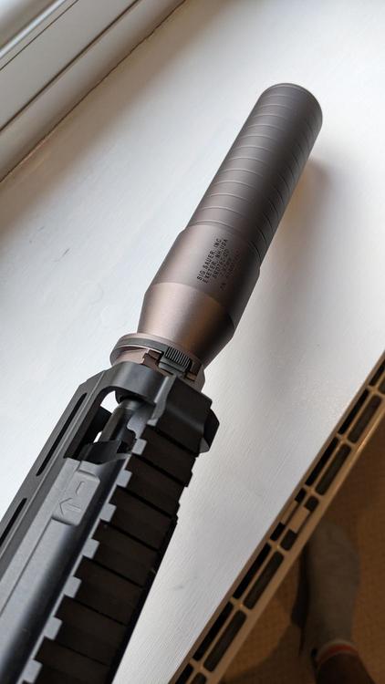

acrxil Posted June 21, 2024 Posted June 21, 2024 (edited) I have just had my APFG Rattler delivered today and I am over the moon with the thing! Build quality is insane and it is rock solid, I spent some time cleaning all the icky factory grease out of it and using some gun salve to re-lube it. A massive thanks to @WilloJayfor making me some extended screws for the hammer connector, I made sure to loctite them before testing. After all that prep I chronoed it and holy sh*te does this thing kick, and fling bb's at some insane speeds. Stock with abbey red gas and the suppressor installed I was getting 370fps on .32's? I haven't fiddled with the NPAS at all to bring it down but I'll list the out of the box findings below: - STOCK w Suppressor and Abbey Red Gas - 370 - STOCK w/o Suppressor and Abbey Red Gas - 305 - STOCK w Suppressor and Abbey Green Gas - 320 - STOCK w/o Suppressor and Abbey Green Gas - 270 All the test's I've run were with .32's and it was very under-hopped, so I will see if I can get a consistent hop with a good fps in a mo. I was using a standard VFC gen 3 mag that came with the gun for each test, I do have some VFC Gen 3 V-Mag's that I'm going to test to see if it has any impact on performance. I doubt it but its worth a test ?♂️ Edited June 21, 2024 by acrxil Diemaco, Barny, gavinkempsell and 1 other 4
