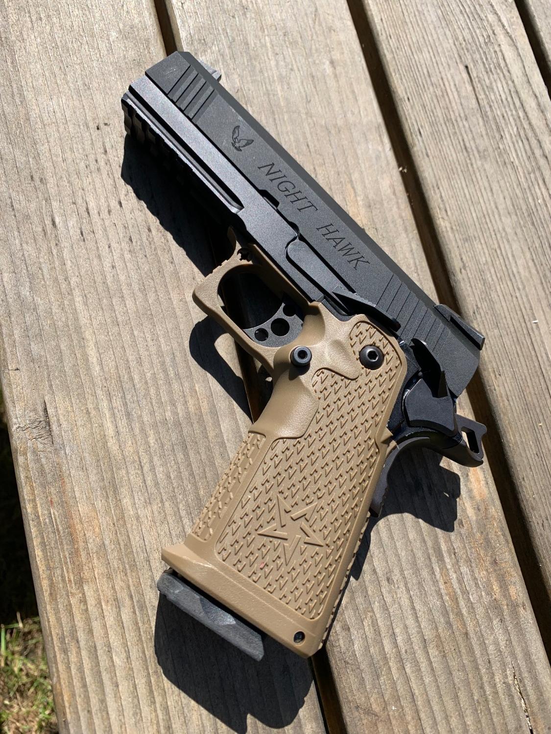

Currently have a Guarder Night Hawk on my 4.3 build, zero issues with it. Does have all Guarder internals on the slide, but a Gunsmith Bros frame with AM steel bits.
Never had an issue with any other Guarder stuff either, also have a Guarder slide/frame on my M&P9L build.
Just lots of negative views on other forums and some on youtube, because they are cast and not cnc. The Knuckles hi capa bloke for example advises people not to buy them.

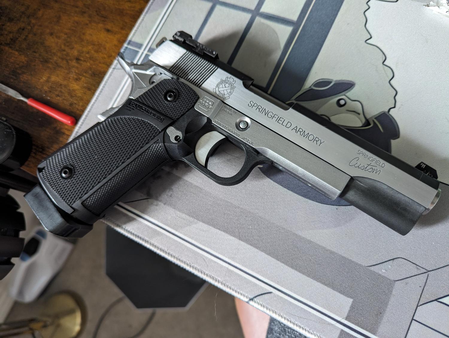

Late I know but I was also warned about the Guarder kits but it was for me the best value option for a full metal TM MEU.
The fit in the end was quite smooth, I even went overboard and had it all cerakoted as well.
