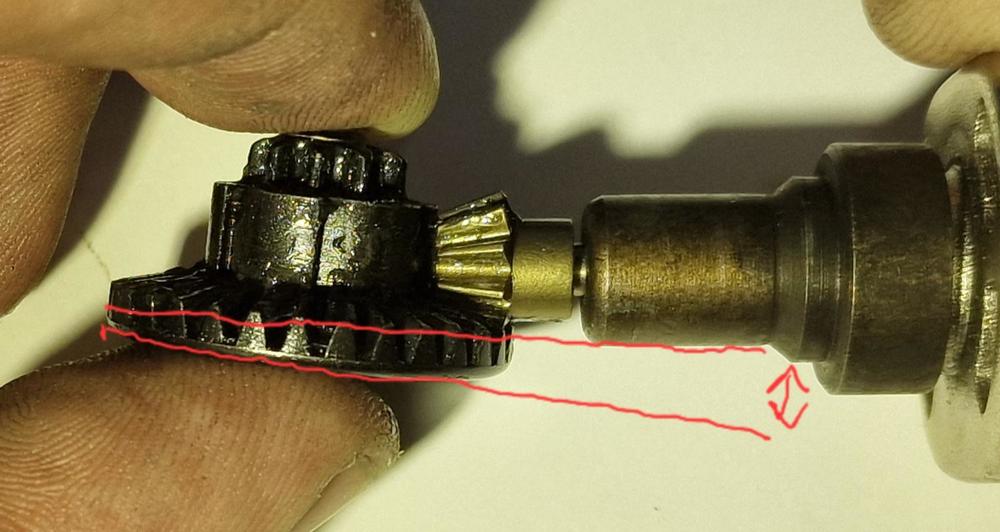

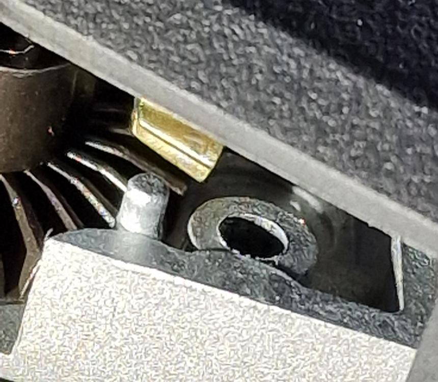

First gear..   the motor pinion, setting the height.   I've set it so it's aligned with the bevel drive gear, not to high, the outer edges are alinged, I believe this is correct.
Now setting the height of the bevel drive gear to the pinion, this seems to need a lot of shims to me to get the right height...  But I don't know.
Can anybody confirm?
Motor pinion, this is the first pic.  I moved it up from this original position to remove the slight overhang of pinion to bevel if that makes sense.
Below shows the height needed to make contact between pinion and bevel (I know full contact is bad, I will leave a baw hair of play)
Is this too much shimming? Will it cause me issues with the next 2 gears?

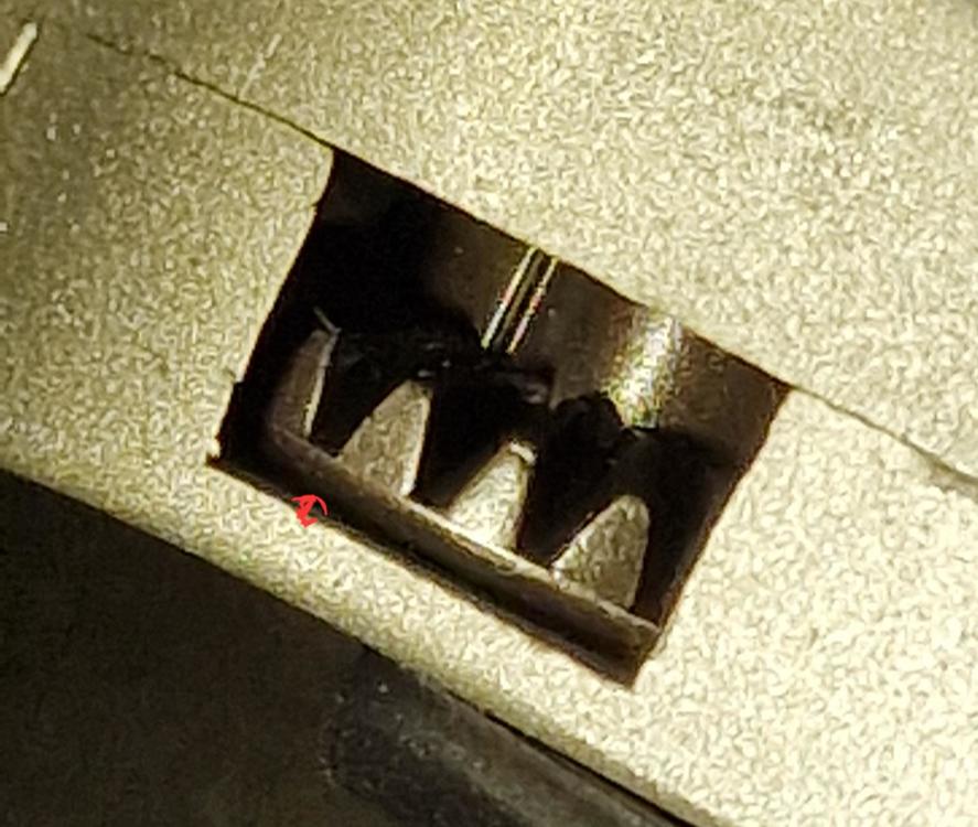

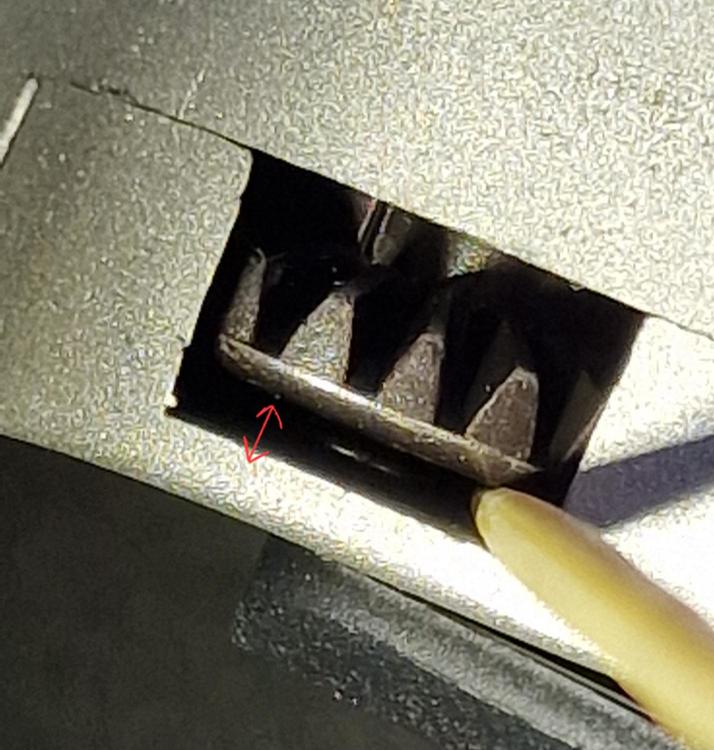

Take the motor and bevel in hand, and spin them together to find the optimal motor height--the easiest most proper fitment will feel right. You then need to fully close up your gearbox with the bevel in it and screw the motor grip on. From there, adjust the motor height until it reaches the height your hand test showed.
Next, add very small shims beneath the bevel until there is about 0.1-0.3mm of play in the bevel gear. It's important to do all testing with the gearbox tightly screwed shut.
Full contact is good. You want the bevel gear to have a hair of play between it and the pinion, but it looks like your bevel is rather low to my eyes.
After you shim the bevel to pinion, you can add shims to the top until you hopefully end up with just a hair of play. The way I personally measure if I've done it right is by tilting the gearbox side to side, when screwed fully shut. If the bevel gear rotates on its own, yet has maybe 0.1mm of up and down play, I know it's right.
Thank you Leo.
Fitted motor pinion to bevel gear by hand and it's tightest with the motor pinion at an angle to the drive gear.  Can you get better pinion gears with an angle more matching the bevel gear?
As this isn't achievable right now the next best thing was pushing the motor further in, there is now a tiny bit of play in the bevel drive and pinion gear but putting an extra 0.1 shim in removed all play to the point I think it is pushing the pinion gear up.
Your advise has made me more comfortable it is as good as it can be, at least for me and has to be better than stock.
Rocking the box back and forth the bevel gear does move but adding 0.1 shim stops it so again your tips have helped.
Thanks again.
Edited by MuPPeT_ON_TouR
All done.  definitely sounding better, on closer inspection of the pinion I could see a shiny spot on the edge, so pretty sure it wasn't making good contact from the factory setup.

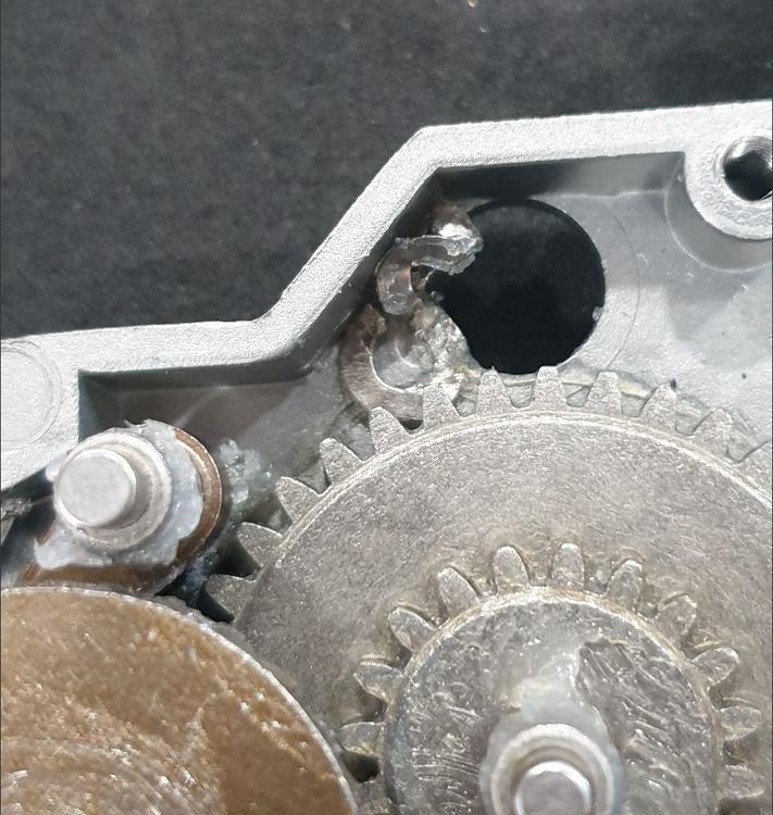

Moved onto doing my sons V3 gearbox, just a shim job and a check.   Good job too, a nice surprise from the factory......
426721411_Shim1.thumb.JPG.907eb9ca9708c551586d45e430d58687.JPG912185746_Shim2.thumb.JPG.36349680e42b0484618ae6f7b7491540.JPG299418548_Shim3.JPG.44a0a8b504dcc69ffe374a6858006921.JPG
No major sign of damage on any gears, I guess he got lucky....   But...  I have the gearbox open so seems silly not to upgrade, his cylinder head leaks air as well, it slowly loses compression when being compressed coincidently it has the same cylinder head as mine and mine had the same issue.  There also wasn't a drop of grease/silicon lube on the cylinder rails.
£350 each and nothing but piss poor quality control right out of the box.

Found the pinion and pinion puller....  new gears and pinion on way for son's gun and mine.
The shiming job done was probably ok, it was the extra sprinkle of lose shims that over did it.
