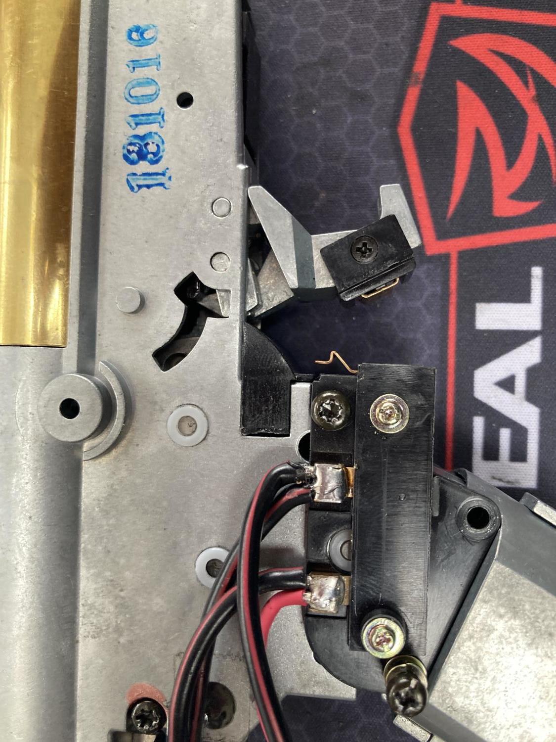

So if it's like the TM, it will look like the attached.
Essentially the box is in permanent semi auto because it's got a cut off lever, but no fire selector plate on the side of the gearbox to hold it out of the way.
To get round this, they have the second external set of contacts you can see in that picture. When the cut off lever disengages the first set of contacts, you can pull further back and make the connection via the second set, giving full auto.
The problem I guess you've got with using a "standard" mosfet is lack of being able to select fire mode. I have no idea what the effect of wiring it up to one or the other set of contacts would be.
Kind of does my head in a bit trying to think about it...
If my head reads it right, like you say, the gnu is permanently in semi with an extra set of contacts for auto. So if either of the contacts sees a go signal it will (should ?) fire. The only difference is the cut off lever on the semi will stop it re-cycling.

On the gate mosfets (warfet, merf, nano etc) the wiring isnt that bad if your handy with a soldering iron.
Basically you wire the two contact wires (small black plug) to one set of contacts, then link those to the second set of contacts in paralell so either contact sets the mosfet off.
Then the motor is just wired to a deans plug which plugs directly into the mosfet.
I'd advise against anything with active braking bar the warfet, as without adjustable precocking the active brake functionality can screw with the function of the cutoff (which is bad enough in a conventional pew let alone one with a rube golberg trigger mechanism). Took me longer than i like to admit realising thats what was causing the endless semi lockups on me f2000
Yup. Working a treat. Desoldered the battery cables and motor cables as I was using new stuff. Deans to the mosfet +-, MOSFET to the motor +- and the two wires for the firesignal soldered to the tabs on the screw on bit by the motor screws.
Semi and full auto work perfectly.
