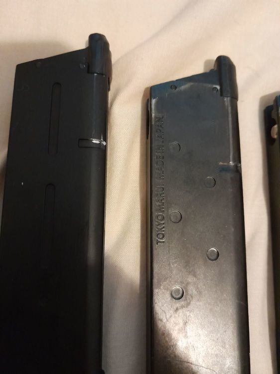

Also just a little problem with an aftermarket mag, it will drop out when firing the pistol but not when it just sat in the mag well, I got two tm mags for it and they work just fine. The guy I bought it off said it was an aa mag? Any ideas? Thanks all
