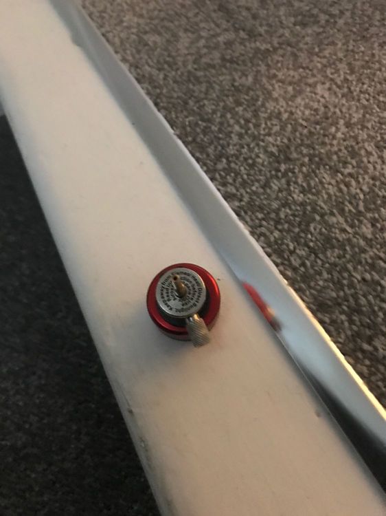

Has anyone had a success with a Madbull XG02 Propane adapter. I have bought one and it’s basically rubbish and won’t work with my TM mags. Is there anything out there that does?
Mine has worked fine, is yours a genuine madbull one with the black text on the top of the silver bit or a copy with no black text on it?
I got it working by stripping it all down and putting lubricant on the centre pin. It was stuck in the up position. It works a treat now.

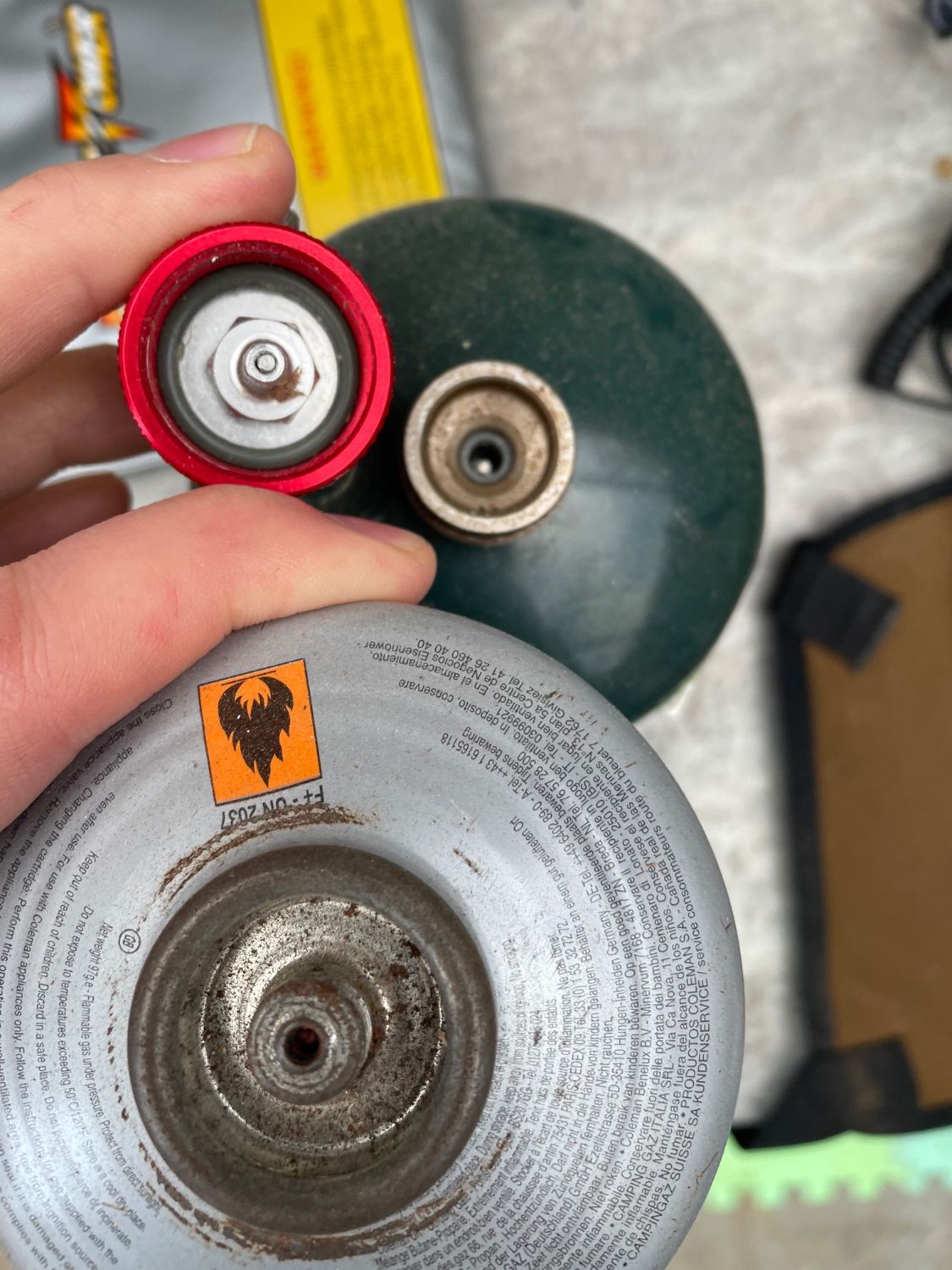

It looks like the thread will be the smaller one for Butane-mix camping stoves, not the larger Propane ones. Will pop out to the shed later and check as I have both types and a Madbull knock-off fill valve :)
EDIT - yeah they are different- see pic
Edited by SSPKali
Added pic and difference in thread size
Fair enough!  It was too good to be true
