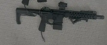

I am currently using a Specna arms BO-4 replica, with a 11.1V LiPo battery that has 1450 mAh, 30C (Brand: Electro river) (the battery is also good as new for 3 weeks), a MOSFET is also installed.
The problem is as follows, when shooting rounds (automatically), the replica reduces its power after about 7 balls, I wanted to ask you where the problem could be, in the battery or in the replica itself?
