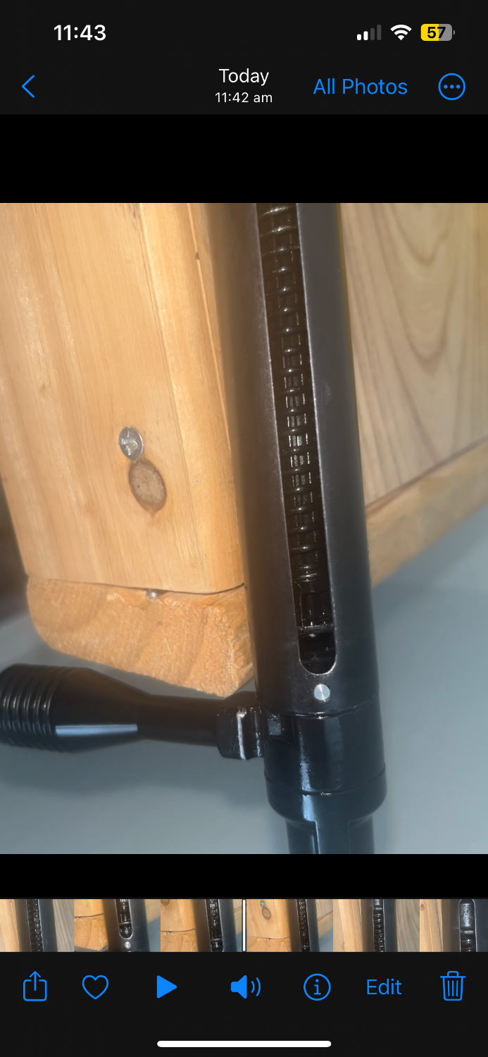

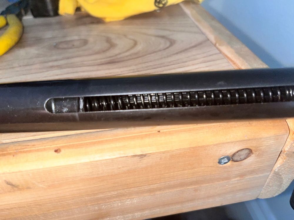

also just to add ive noticed the spring guide is not straight its sits skew in the cylinder, the piston also gets really banged up by the looks of it ?

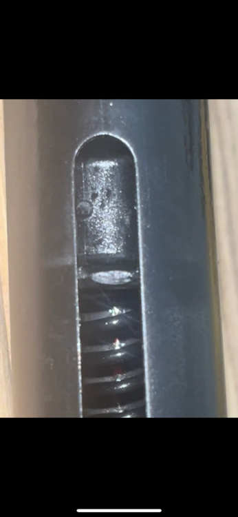

What is that spacer block behind the spring guide? I don't remember having one (albeit I haven't taken it apart in a while, so I might have it and never noticed)
Im not sure about a spacer but its only the spring guide back there when i tilt the cylinder upside down its the only thing that falls out, I’m assuming with the new spring it might be pushing the spring guide a bit more back because i have to use quite a bit of force to get the sear back into the cylinder once the trigger assembly is on.
