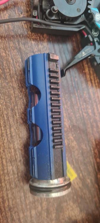

My original concern was how quickly the motor heated up as well as the battery. When I opened it up, I noticed the piston doesn't look stock - this wasn't mentioned in the listing when I purchased it. They had mentioned a tech put in the new nub, titan and trigger, but nothing else:

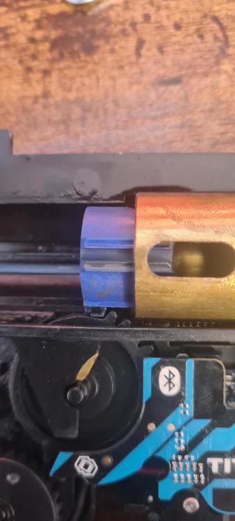

Whilst the piston head wasnt the best, as it is stock, i suppose if it isn't broken don't fix it. The teeth on it look ok. However, the AOE looked a little odd at first:
Although depending on how you look at it, it's not too bad, especially when you match the next set of teeth, and consider that the previous tech put in sorbothane padding in the cylinder:
Whilst you could shave down that first tooth, the clearance seems fine. I figured I would trust the work that's already been done to it rather than complicating it further. But I will heed your advice @Speedbird_666 - if something seems off in future I'll replace the piston head as I now have the parts to do so!

looks like the 1st tooth (the big thick one) is a little high, it could be rubbing against the top of the sector gear, but I've got zero experience of the eve so might just be a "thing".  However is easy fixed grinding it down.  you're right though perhaps leave it for a few games and see how it performs.
