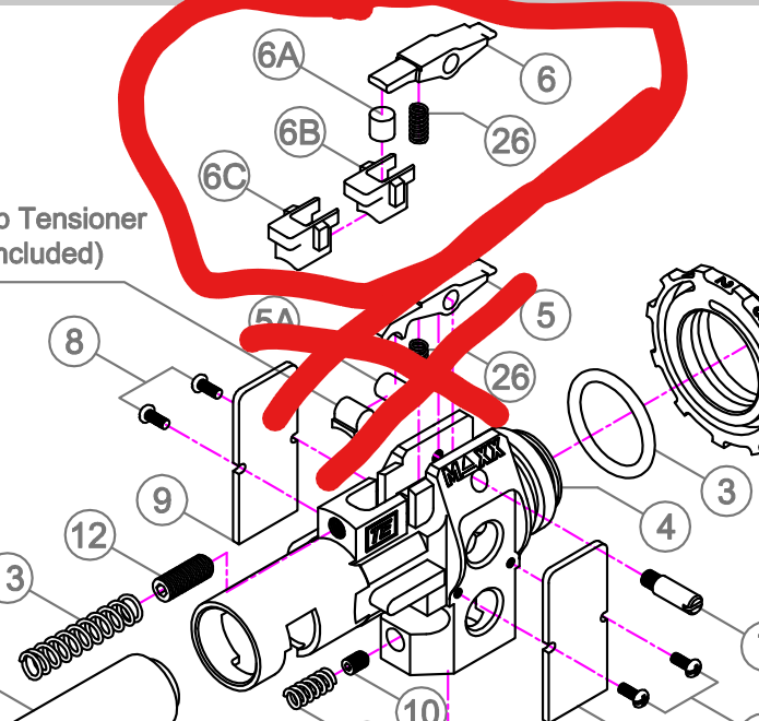

Hi peeps
Can i use these bits in my maxx pro hop with a standard rubber + barrel? any advantages over the normal "arc" style arm and nub? (5)
The r-hop blocks?
Yes they work well with the likes of the maple leaf series (same idea as the omega nub but more solid construction)
Wouldnt be so useful for a standard bucking though.

The r-hop blocks?

okay thats great thank you
General advantage is a pressure distribution that covers a larger area instead of focusing on a single strip.
I say use them without fear of messing up anything.
Back when I ran flat hops, at one point I was running a standard hop rubber (without shaving down the little mound inside the rubber) with a flat tensioner and it worked great!
