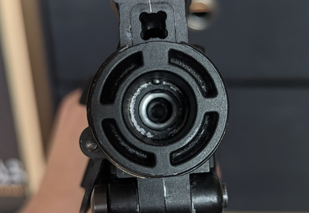

RostokMcSpoons Posted March 28, 2022 Author Posted March 28, 2022 (edited) Thinking about how I'm losing air, I wondered if there should be a barrel spring on my gun. So I've just pulled the inner barrel out. No spring, but then I've looked at the Tippmann M4 manual (for the v1) and there's no spring shown in the exploded diagrams. However, it did show I've got a damaged hop rubber. It seems the gun likes to damage the end of it... ... it's split a little on both sides. I'm not sure if that damage is enough to account for the low and variable velocity though. (The original rubber was deformed on the right hand side, creating a nub of material that made the BB's curve to the right) Is this a sign that the nozzle isn't aligning correctly? It does look very slightly low and to the left when viewed here: edit: I put the gun back together, but first I wrapped some PTFE tape around the hop rubber (at the muzzle end of it) My gun has had the 'dwell mod' done to it, so for shits and giggles I screwed that in a bit too. And when I chrono'd it (no hop applied now)... it's still variable. But perhaps a little better? Edited March 28, 2022 by RostokMcSpoons
Supporters Adolf Hamster Posted March 28, 2022 Supporters Posted March 28, 2022 those torn lips will absolutely ruin the consistency, tbh i'm almost surprised it's not worse than it is. if it's tearing the lips like that then something mustn't be right, and nozzle as you're already thinking seems like the likely culprit, maybe going too far forward? RostokMcSpoons 1
RostokMcSpoons Posted March 28, 2022 Author Posted March 28, 2022 1 hour ago, Adolf Hamster said: those torn lips will absolutely ruin the consistency, tbh i'm almost surprised it's not worse than it is. if it's tearing the lips like that then something mustn't be right, and nozzle as you're already thinking seems like the likely culprit, maybe going too far forward? When the 'bolt' travels forward, it goes up against a solid block that is effectively part of the upper receiver... I'm sure I could shim that in such a way as to back the nozzle off a little. The problem is the gun could eat quite a hop rubbers before I get it right ?
Supporters Adolf Hamster Posted March 28, 2022 Supporters Posted March 28, 2022 4 minutes ago, RostokMcSpoons said: When the 'bolt' travels forward, it goes up against a solid block that is effectively part of the upper receiver... I'm sure I could shim that in such a way as to back the nozzle off a little. The problem is the gun could eat quite a hop rubbers before I get it right ? if you're gonna try shimming if you start out over-shimming, then drop it down until you get decent air seal? that way the nozzle is too far back rather than too far forward. kinda the opposite of trimming a nozzle where you shorten in little increments to be sure not to take too much off. that is, assuming there isn't some trick to the system that we don't know.
RostokMcSpoons Posted March 29, 2022 Author Posted March 29, 2022 (edited) I've had another look at the hop rubbers, to do a bit of 'forensic analysis' The original one has that slightly folded lip that caused the curving is otherwise undamaged. It looks like a Macaron Yellow, for reference, so quite soft. The cheapo one I replaced it with, which feels as hard as nails and could probably survive WW3 (which might be handy), is completely pristine. The Guarder Clear looks 'unhappy'. So yeah the nozzle might be 'doing something' to the rubbers, but hopefully it's a matter of fine margins. Rather than trying to shim the nozzle, could I shorten it a tiny bit? I put the cheapo hop rubber back in. It might not be soft enough to hop heavy BBs, but it ought to keep a good air seal. And things are getting 'interesting' in that I've dialled out the Dwell Mod grub screw, and with that I've seen the FPS reach as high as 380. But the consistency is still all over the place. I messed around with the hop (re-applying some) and the Dwell screw some more, and the last few shots got figures of 297-326. I've got the feeling I'm not a million miles away from it working properly... but I might need a new O-ring or something to make it happen. Edited March 29, 2022 by RostokMcSpoons

RostokMcSpoons Posted April 25, 2022 Author Posted April 25, 2022 (edited) An update and a request... The request is that I'm sure someone here posted an advert offering a nozzle block (without the dwell mod) for sale here earlier in the year. I sent an offer via the message button but never got a reply. And now I can't find the ad. (Perhaps it was on another site, my memory is shite) If that person happens to read this - please contact me! After a second message sent off to Tippmann via their website, I got a reply back from Dave at KoreOutdoor.com. I've not had time to try his suggestions, indeed I've asked for some advice regarding the lube as I don't want to have anything combusting in the gun :] Here are his notes, maybe someone else will find this useful (I would take issue with his comment about +- 15fps being acceptable, I've just been firing a few shots through the DE, and that's +-2fps!) Quote Just been sent your email from yank land We’re based in Crowborough, TN6. And are Tippmann in the UK & Europe +- 15 fps doesn’t seem too bad, but can hopefully be dialled in a little bit more The first thing I would do is oil the valve, a lot of owners don’t do this often enough and you’ll notice a bigger difference in performance. If you put a few drops of our oil lubricant down the ASA before airing up, this will oil the orings in the valve creating a better seal. Chances are you may need to put a fair bit down there and blast on full auto for a while to spread the oil out enough as it’s not been done before. A couple of drops on the rear bolt & oring also will help I would also check that the rear oring is the correct size. A lot of people just buy generic orings which are either the wrong size, hardness or material for the application. We haven’t had any issues with the front bolt (nozzle) not aligning, might be a case of taking the screw out holding the drive assembly in (front bolt, powertube & valve and rear bolt) and reinstalling As you said the bucking will contribute to the fps variance, I would ensure this is sitting correctly, as sometimes they come in not sitting flush so the feed lips are too far into the gun and cause issues Make sure the TDC isn’t damaged also, worth unscrewing and checking the nub is okay and screws up and down smoothly. Let me know how you get on with that, if not I can get a price for some orings & oil for you. Bucking, I would go aftermarket for best results – a lot of users are suggesting the ASG Madbull Shark Red (I believe), if not a standard G&G green is a good all-rounder. But totally up to preference Otherwise there’s not much more to them! Thanks, Dave Edited April 25, 2022 by RostokMcSpoons

Old man Jay Posted April 28, 2022 Posted April 28, 2022 I had the nozzle for sale but removed the advert, I have a few other bits and was going to put it up as a set, does your v1 have either the hard recoil buffer spacer fitted ? or the dave air saving device ? if either of these are fitted its best to remove them and start afresh. This will make dialling in your fps a lot easier. what barrel is in it ? I had a pair of madbull blue shark hop rubbers that actually worked fantastic in mine and they were cheap, hopped .3 no issue. Although the macron yellow should also be fine. Its easier to cut the end off the hop feed lips if you feel the nozzle is ruining them. Depending on who did the dwell mod you can put a bit of grease around the screw to stop leaks. Also pay close attention to your hop unit, I assume its a replacement tdc job, may be worth pulling it out and checking it over. also check the feeding manually to make sure there isn't to much resistance for the bolt when loading a round.
RostokMcSpoons Posted April 28, 2022 Author Posted April 28, 2022 Hi! Thanks for solving the mystery for me ? Mine is a v2 so it has the tdc hop as standard. It has a tight bore barrel in it at the moment.. Ive got a few guns where I could swap similar length barrels and go back to a standard bore, see how that works out. Is had the dwell mood but nothing else (as far as I can tell / what I've been told) Madbull seem to be the preferred hop rubber, I'll order one!
Old man Jay Posted April 29, 2022 Posted April 29, 2022 you might find a standard bore barrel a good start, might alleviate some of your fps inconsistences, also may solve your hop rubber issue. worth a punt to rule out the tight barrel.
RostokMcSpoons Posted May 2, 2022 Author Posted May 2, 2022 Just put some lube through the system and swapped the O-ring on the bolt over. Also filed down a little plastic inside the nozzle from the where the dwell mod screw goes in. Just fired a few dozen 0.20g BBs through it to see how consistent the fps is now, and it's still inconsistent. But not unusably so? It's varying from 390-420 but the majority are at 405. It's set pretty much at max power I think with no hop applied, so I think there must be something still wrong as it surely ought to be capable of quite a bit more. But it's getting better. I'll try a different barrel.
