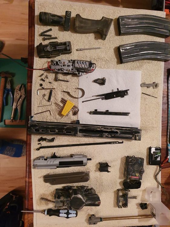

I have an L85 Afv that I picked up second hand and while going through the process of repainting I removed that rail.
The removed rail can be seen in the middle of this mess, it has two locating studs that are held in by two screws.
Hope this helps, I don't really have any experience converting the rail to anything else but with a drill and tap I'm sure it can be done.
