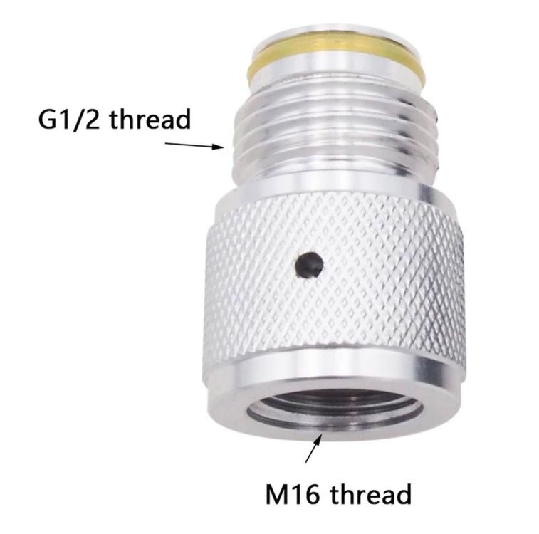

Option 4
88gram disposable co2
These are bigger disposable cylinders, equivalent to just over seven 12 grams
But you need a different adaptor for the 88 gram and will need to fit the HPA receiver to the Omega
These valves don’t seal, so you’re stuck with it fitted until you finish the co2, or let it all blow away when you remove it

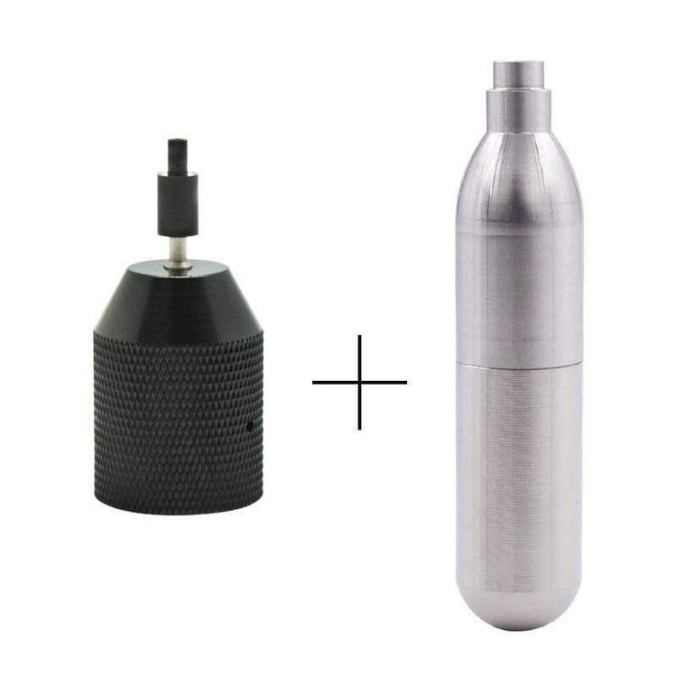

Option 5 - refillable 12 grams
Making sure to get 12grams with the refill at the normal puncture point, hoping the puncture nipples open the valve etc …..
My verdict is to put up with 12 grams or take the 13 Ci option
