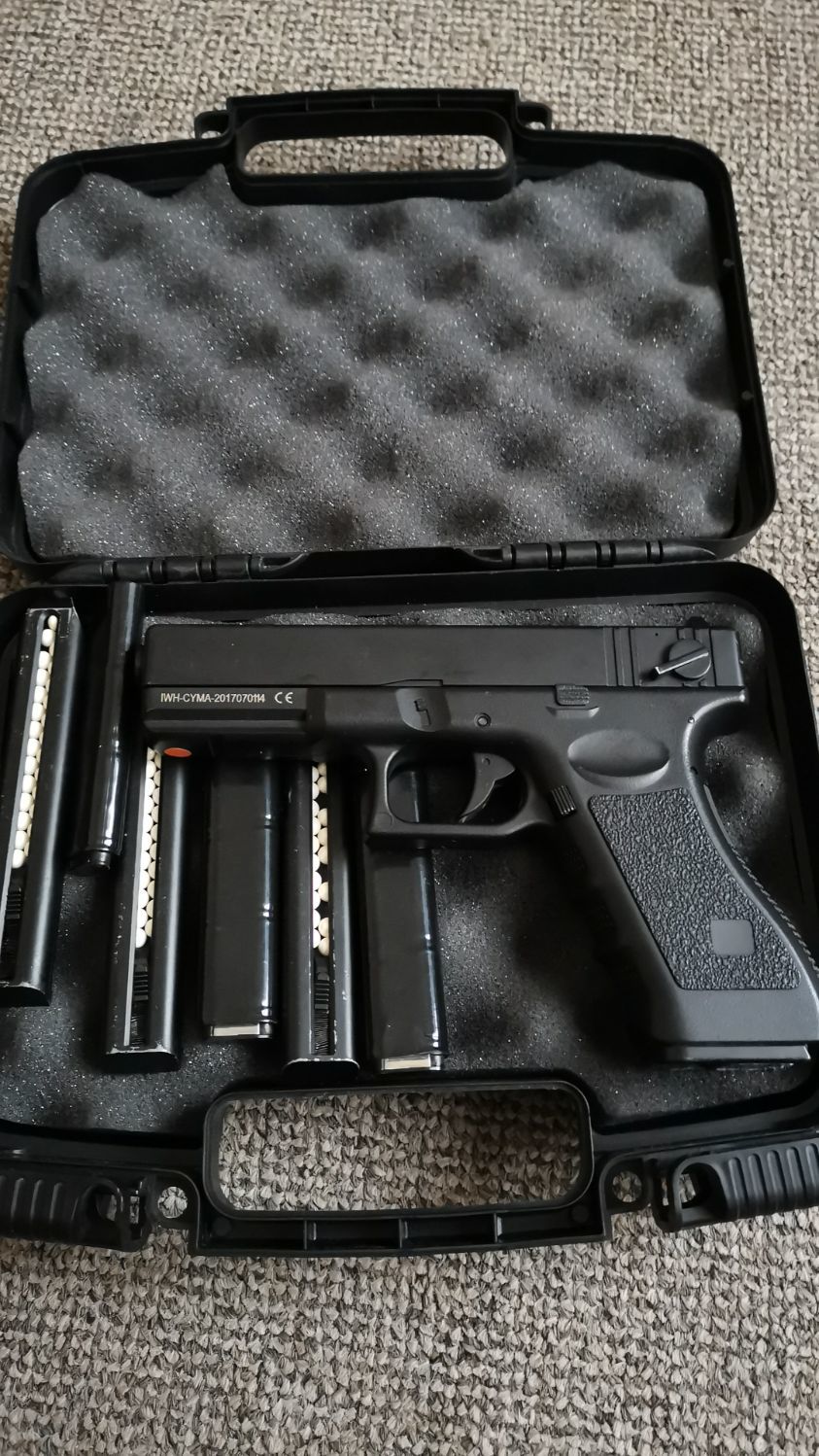

ibo7 Posted July 23, 2021 Posted July 23, 2021 My Cyma Glock AEP has mysteriously stopped working, tried all 3 batteries and nothing happening at all. Can anyone point me to what to look at first? Any common known faults with these pistols?

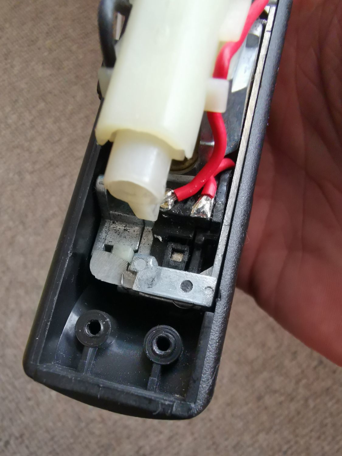

ibo7 Posted July 24, 2021 Author Posted July 24, 2021 4 hours ago, Rogerborg said: Do they have a fuse? I honestly can't remember, I've rewired mine and gone with Deans connectors. They are quite fiddly to disassemble, with lots of little parts to lose, but there's a comprehensive guide here: And I'd always recommend buying a basic multimeter which takes so much of the guesswork out of it. Sight unseen I'd expect it's either a broken solder connection, or the trigger, which is a teeny, fiddly thing. I've found the fault, the trigger latch(I made that up) doesn't quite go forward enough, when I hold the trigger down and just push it forward slightly, it cycles fine. Any ideas on how I can fix this? HwVideoEditor_2021_07_24_164128207.mp4

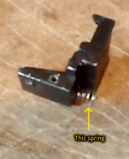

Supporters Rogerborg Posted July 25, 2021 Supporters Posted July 25, 2021 If you have a look at 5:00 in the video above, he highlights that there should be a small spring pressing down on the trigger bar. If it's weakened or missing, I'd replace it. I don't recall the size offhand, but a piece of spring from inside a pen might do the job.
ibo7 Posted July 25, 2021 Author Posted July 25, 2021 44 minutes ago, Rogerborg said: If you have a look at 5:00 in the video above, he highlights that there should be a small spring pressing down on the trigger bar. If it's weakened or missing, I'd replace it. I don't recall the size offhand, but a piece of spring from inside a pen might do the job. I seem to have lost the spring but that still doesn't fix the issue, the issue is the trigger bar doesn't go forward enough when the trigger is pulled
Supporters Rogerborg Posted July 29, 2021 Supporters Posted July 29, 2021 On 25/07/2021 at 14:53, ibo7 said: I seem to have lost the spring but that still doesn't fix the issue, the issue is the trigger bar doesn't go forward enough when the trigger is pulled Hmm, the triggers are pretty mushy, but the bar does need to be pushed down in order for it to engage the trigger. I'd definitely want to replace that spring. Ah, I did take a (bad) picture of it. The stock one is slightly conical, larger at the bottom where it pushes on the bar, but anything that fits might help.
