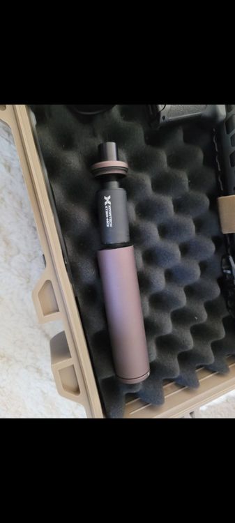

I run my tracer inside a suppressor unit. I've done it by using a thread extention which runs through into the suppressor with thread to spare for the tracer to mount to.
As for the size I just found a can that was foam filled and had a diameter larger than the tracer and nipped some foam out to make space.
I can get more pictures tomorrow if it helps.
