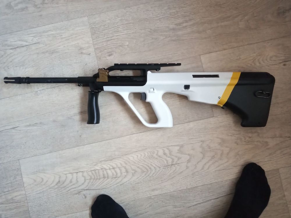

Hi all, I've just completed another one of my son's guns his aug, basically the same as the others fitted a micro switch behind the trigger and used the g&g etu v3 MOSFET £35 bargain. Fitted the electric trigger into the V3 gearbox as normal, but cut the wires for the trigger and selector, ran the trigger wires to the trigger (obviously) then ran to wires rearwards too a separate selector switch in the butt. He used it for the 1st time a couple of weeks ago and said it was awesome, lol.

What are you looking for? I fitted a cheap MOSFET to my tm aug a few months ago. Made a difference. 👍
