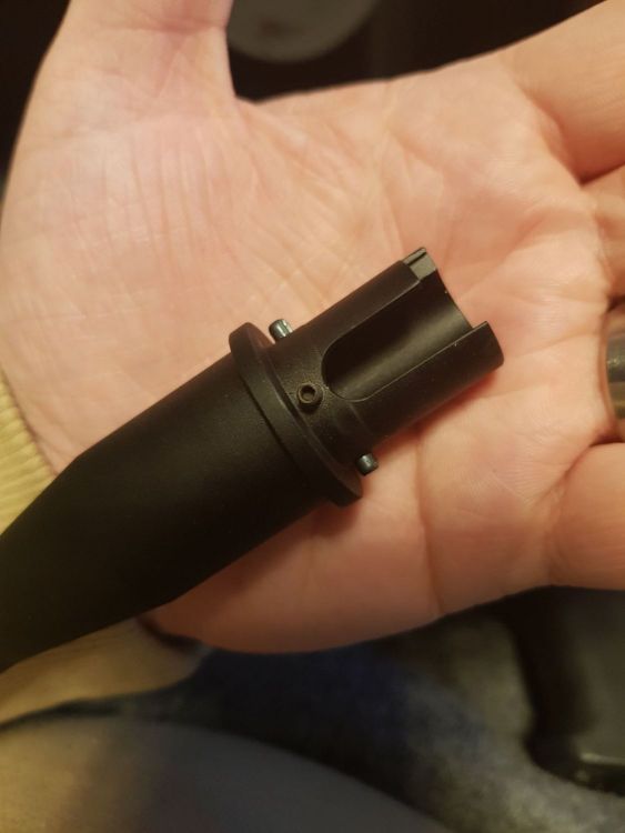

First things first is the original outer barrel fitting tapered? Most G&Ps have a different fitting to TM spec AEGs as it gives a more solid fitting. However this also means you can only fit g&p barrels.
As for the buffer tube I ended up spend nearly £40 on a g&p one after trying for ages to find one that fitted. The ones I could find that were the right length were still too loose. This meant that over time they worked themselves loose and chewed up my wiring.
Is the barrel painted or polished on the receiver end? The polished ones are tapered so a normal "TM spec" one won't fit. There's a fair amount of aftermarket barrels out there for G&P taper though.
I guess this is untapered?
This would go into the cheap sr15 but the cheap sr15 out barrel would only go a few mm into the g&p sr15.
Yeah the taper is pretty obvious
G&P Tapered Aluminum GP-T Outer Barrel for G&P GP-T AEG Receivers (Length:  16" / C7 Profile / Black) | Pro Shop | Salient Arms
Seems it's just down to the size then. Bit odd that the cheap one goes in a bit but then stops.
