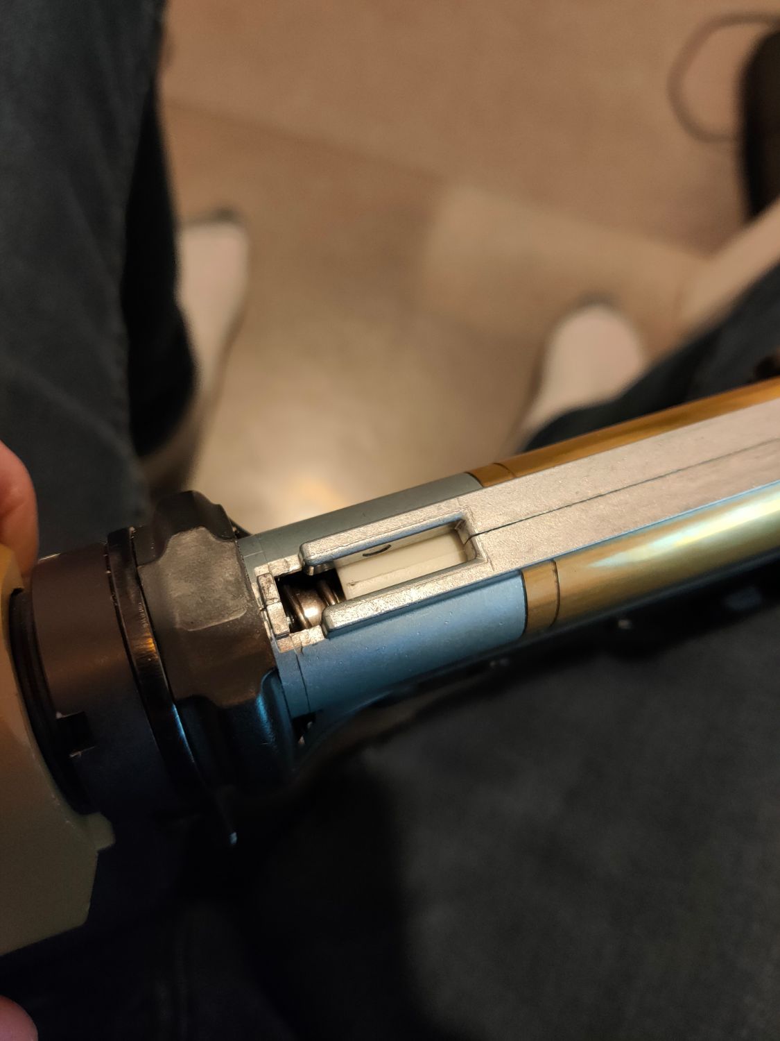

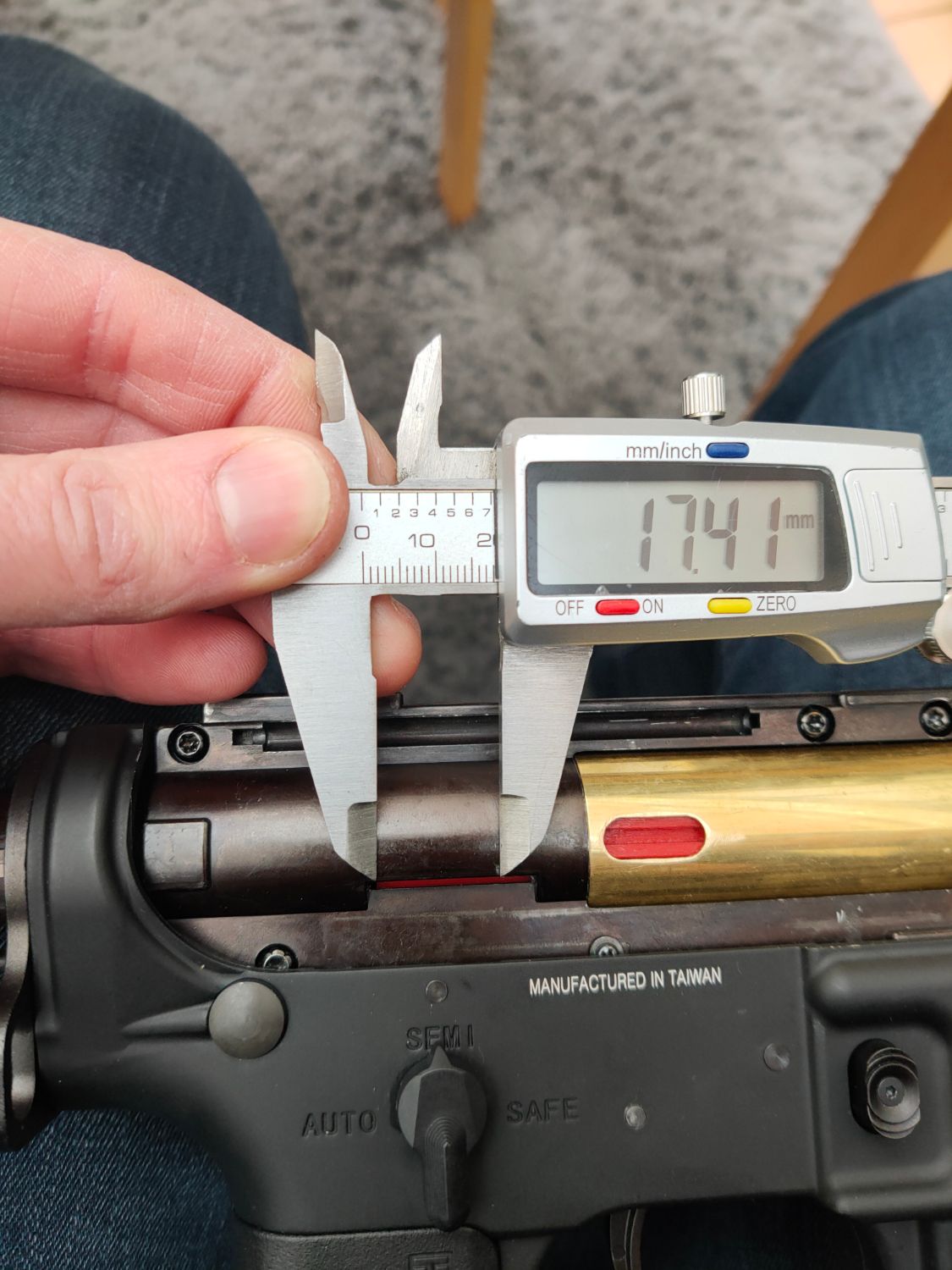

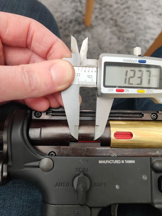

The gun shoots lovely (really does feel and sound like a different gun) nice a snappy on 7.4v lipos without a crazy high ROF which is what I was aiming for. However, I have a problem (or maybe not) with overspin.
I have attached some photo's showing how much the piston is being pulled back..
The pic showing 12mm on pull back is on a 7.4v 1450mah 30c Nuprol lipo
The second pic showing 17mm pull back is on a 7.4v 2200mah 25c lipo

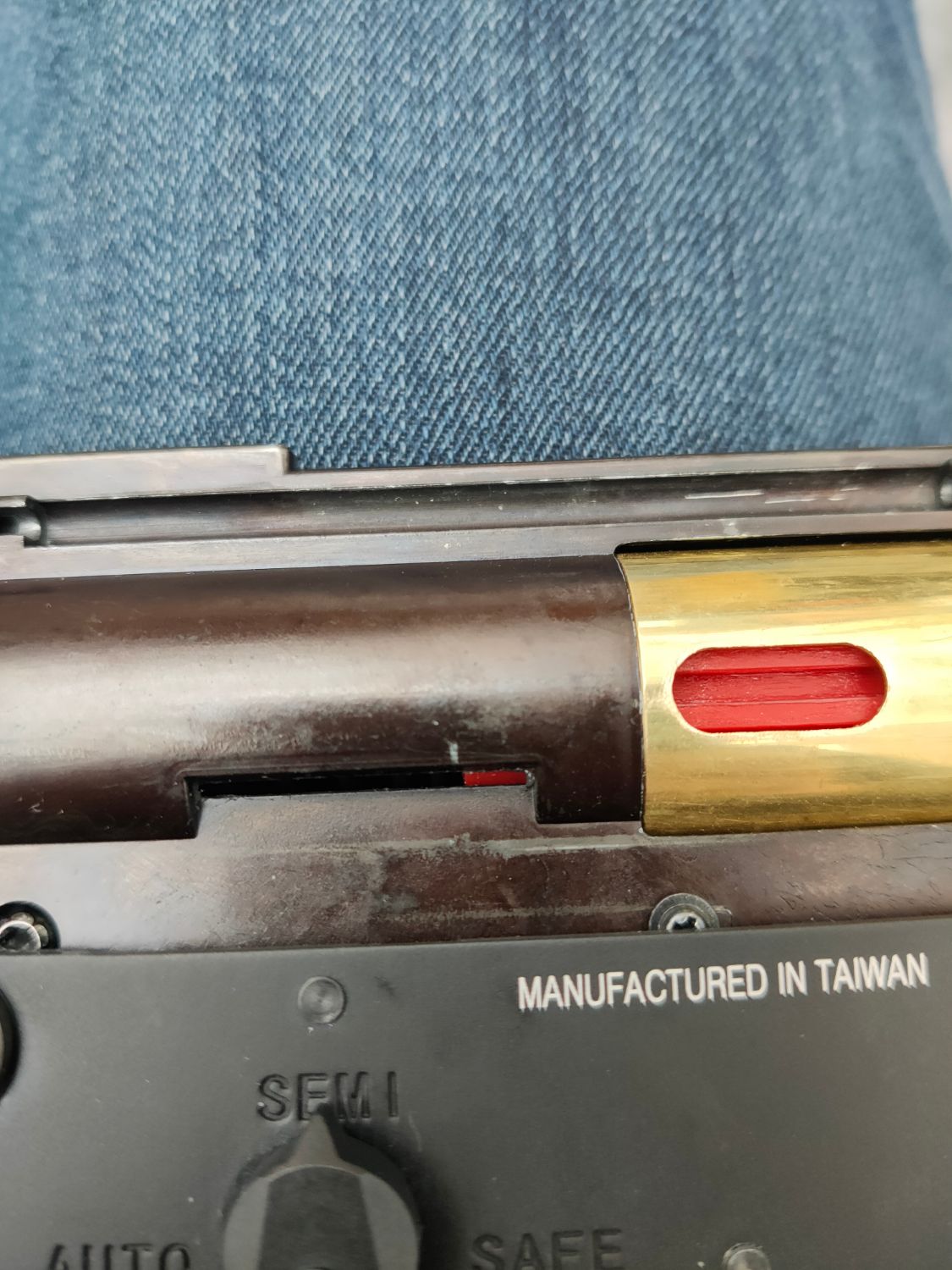

The third pic is the resting position with the piston head  against the cylinder head
So the question is... Should I worry about this and attempt to fix it by SS the sector? I know a AB mosfet would sort it but I'm not looking for one of those at the moment and would be quite happy to rectify it from a "mechanical" point of view if required rather than a mosfet.
I would prefer to use the 2200mah battery as the gun it a little more snappy with it due to the higher discharge. Also to note, I am getting no signs of pre engagement, no double shot on semi, no nasty sounds on auto, no wild fps inconsistences ( has a 1-2 fps variation).
Let me know if you would SS or is it beneficial to SS, or is it just my OCD kicking in :)
Thanks
Andy
It’s really not a massive concern, just think if it as a mild mechanical pre-cock!
Parts wise/compatibility that’s a good setup you have there now.
Mild AB is nice, but you need a fancier FeT to do that.
100% AB is just to harsh on the motor and makes so much heat.

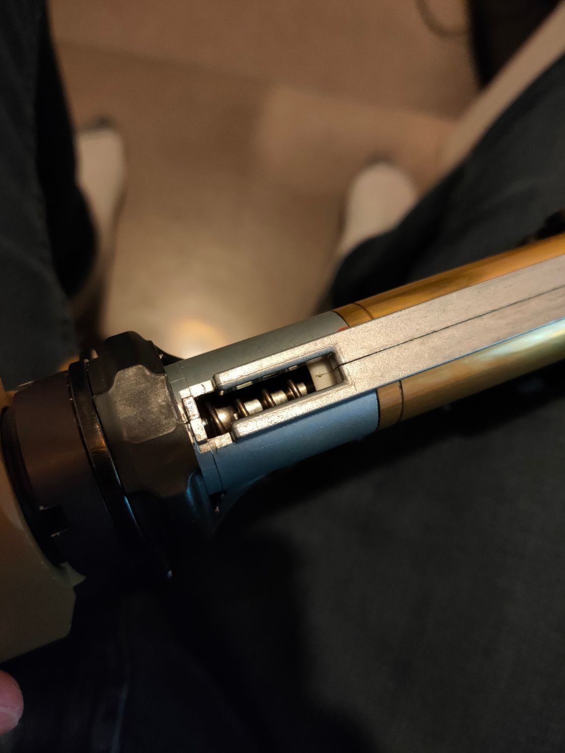

Thanks for the reply. I really do think it's my OCD kicking in as I got curious and went to check my TM recoil running pretty much stock power (bearing spring guide) and gears, with the same 7.4v 1450mah battery it is overspinning about the same amount and I've never had a problem with that gun. Pics below.
Would their be any other benefit to SS the sector besides rectifying the overspin? Would I get slightly more trigger response and ROF or would those effects be negated due to then having to use a heavier spring to maintain fps?
Thanks again
Andy
