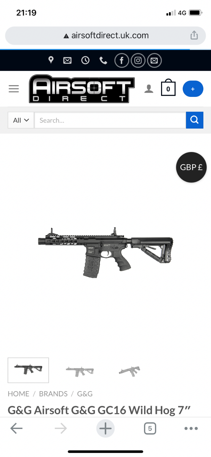

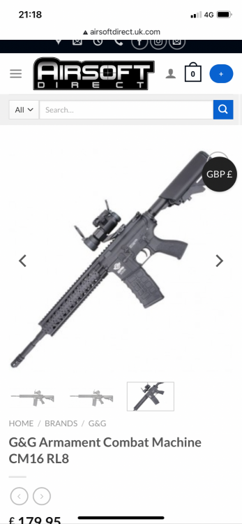

I’ve just bought a G&G cm16 rl8 off another forum user (image attached is the rifle with sight) I’m quite keen to make it have a flash hider immediately at the end of the gun (like in image attached) rather than a long barrel sticking out from the end.

I wanted to know if this means changing the whole barrel, and if anyone can guide me as to how to do this on this rifle? Am I right in thinking I would need to get a barrel that stops just short of the end of the handrail and then screw the flash hider onto there.

Problem is the RIS, And your specification.
You want the gun you have to have the barrel terminate at exactly the correct point for the suppressor to mount perfectly. It's an almost impossible question to answer.
You could remove the RIS and see what sort of outer barrel you have. If it's a single piece barrel then you have the problems with trying to locate a multi section barrel that not only fits, but then terminates where you want it.
If the barrel is already a multi section barrel then you can buy different length sections that screw onto that, Allowing you to have any barrel length you want within that barrels specification. Be that inch or 30mm sections or something totally different.
Only you can delve into the gun and try and work out exactly what you are working with. It's not as clear cut as reduce the barrel length by X with this new barrel.
Typical for most airsoft outer barrels can have a huge variation and whilst you would hope that there is a standard that all manufacturers follow, This is more often found not to be true.
This product might work... It also might not.
https://www.ak2m4.co.uk/external-parts/outer-barrels/xt-outer-barrel-aeg-set
