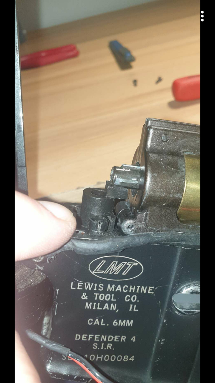

Hey, so my gun is not feeding bullets well, sometimes it does, sometimes it doesnt. So my friend checked it and found a broken part. I dont know how its called to get a new one, please help :)
I am talking about the part with 2 screws :)
Thats the bottom part of a 2 piece hop unit. I haven't seen one in years as they got replaced by the newer 1 piece hop unit. They used to come as standard on the older style Tokyo Marui M4 AEG's.
 It's normally an easy task to replace the 2 piece with a 1 piece which will give you a better airseal making the FPS more consistant.

Uhh damn yea Iv been confused. I was looking for the same hop up as I have an I only saw them with a longer barrel I thought my broke in half lol, now you tell me its 2 piece :)
So in my case it would be better to replace my stuff with a new 1 part hop up chamber?
there is always a chance that a 1 piece won't fit so if you are new to messing around with AEG's it's probably best to stick to a 2 piece. The other option is to take/send it to a tech who can do the work for you.

Well I definetly couldnt do it as I am not very good with this things, but a friend could maybe do it, depending on what needs to be done :) I found a piece in the EU and the cheapest I foundis like 35 EUR with shipping, where I could get a complete 1 piece metal chamber for like 15 EUR shipped...

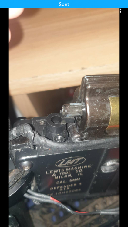

Well, it works now as a friend moved it in place and tightened 1 screw more then the other, but who knows when its gonna get bad again.
I found one in the EU, but it is very expensive. What do you mean another mounting plate missing tho?

in the pic...
there is a tiny small screw missing on a plate/mount- where your pinky is
then there are two perhaps slightly larger countersunk screws that hold the lower hop onto the plate
the tiny screw by your pinky is a pan/jap head and may not be a big deal
though I don't think it would hurt trying to put one back in there - the wiring should still clear it
(it is a front wired M4)
then two countersunk self tapping screws (most likely) afix the lower part onto mount as i said
and it should all be golden - but don't over over tighten the cracked side
just try to re-affix it all in place better, so it doesn't shift around and it should improve the feeding
if not - send it to a tech
but just try to replace the missing screws if you can, I think though cracked it "shouldn't be tooooo bad"
use it for plinking and if it goes again then look for a tech perhaps
