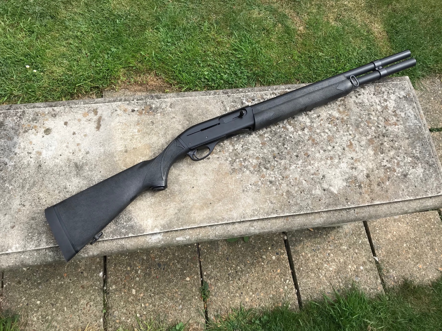

Picked it up in a trade deal, will likely keep it, but interested to know what if might be worth.
original box, 29shells.
Pretty good but not perfect condition, I’ve replaced the piston head with a  decent Tm G17 one, reduced the trigger pull and enhanced the ejector with the steel modification so it doesn’t wear out.
they are £300 to £400 ish new currently sold out though, considering unknow age £250 to £270.

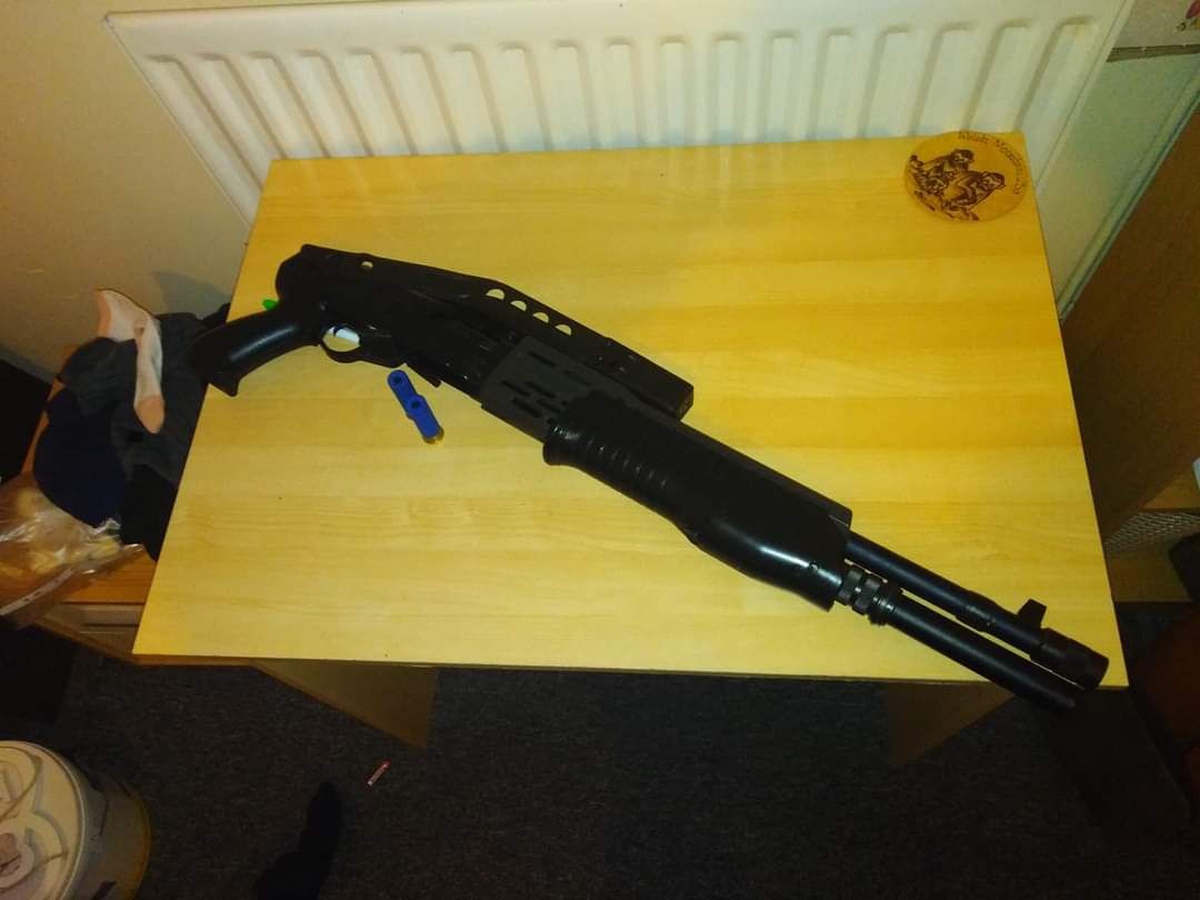

They fit inside Marui spas 12 bodies.
It should, also be plenty of space for an internal gas tank. However, how are you going to have it mag fed?
Having had many apart in the past I don't see how you could make one magazine fed.

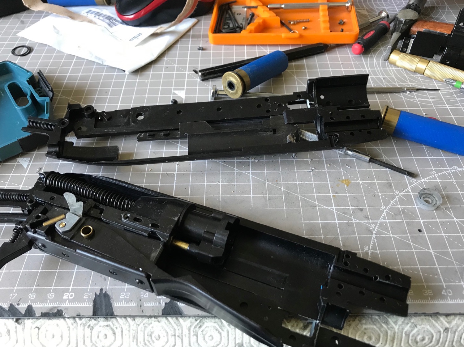

I'd be intrigued as to your plans too.  I've laid an M1100 on an AA12 trying to work out how to it.  I figured you'd need to use the M1100's tube mag and the AA12 mag would just be for show but there is so much stuff that just doesn't line up.

Thats what fabrication is for lol
Interesting project... the M1100 gas system is pretty much bulletproof. A weak spot is is the fake bolt. I had a few snap at the attaching point to the blowback mechanism when putting high pressure gas through it, but it'd be straightforward to fab up a flat AA-12 shaped bolt out of steel or alu.

it’s a good system, but being made of pot metal means it has a number of inherent weakness’
First thing I did was put a steel ejector in it, second was making a much lighter trigger.
Honestly, I think the two biggest issues will be getting it to lock back on empty, and reworking the fire control group to allow for full auto.
Im in no rush, however, I have all winter ??
Since the AA-12 is open-bolt (i think), could instead of a lock open device have something on the mag follower that blocks the trigger so it stops shooting with the bolt closed after the last shot?
Sorry, I'm sure you've got loads of ideas... it's just Maruzen shotguns and the tinkering of were very much my thing :D
The shell lifters can break too, had 2 go on me.
