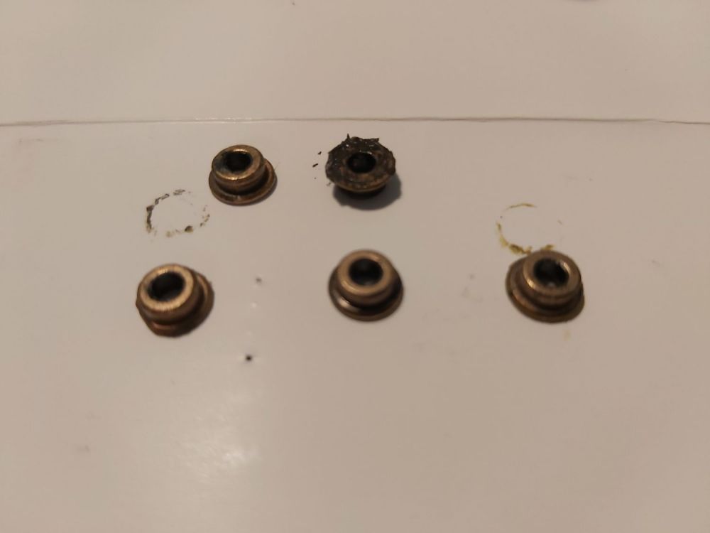

20200927_205408.thumb.jpg.3a873d3f273dedcea20a9c2aeab6a5f7.jpgnoticed (after taking gearbox further apart, this pic was to help me put everything back in right place) that there is a missing bushing on the gearing behind the trigger as seen in middle of pic. I assume this is the cause of the problem and now have replacement 6mm bushing on order and some shims just incase. Will give gears a tiny bit of grease while in there too.

6mm bushings, how old is this gun ???
Which might indicate a bit of wear (so much the bushing worn away completely - sarcasm)
think you might want a pack of shims too - coz can't see any on that sector/missing bushing-gear

UMG comes stock with 6mm (oiless) bushings I found out, even the new ones still on sale, my gun is about 6 years old and has fired 10k~ in just the last 6 months alone I quickly calculate from memory.
Glad the nozzle position isn't an issue thanks for the info.
I did get the gearbox completely open (and have plenty of pictures if you wanted to see them now) and honestly when putting it together again is when I noticed the missing bushing as the other bushings were out of alinement with the case (attached to the gearing still rather than the case). Seems doable from what I have seen and now read on these gearboxes but the shimming process sounds time consuming and with a bearing missing its probably needed as may have had one there. I plan to replace all 6 bearing FYI.
Thanks for the advice,
Problem fixed. 6 bushings replaced, the remaining 5 were tatty and the shimming was pretty much nonexistent so my probably rookie shimming job should be better than nothing. Greased it up too abit. Gun shoots and sounds nice now.

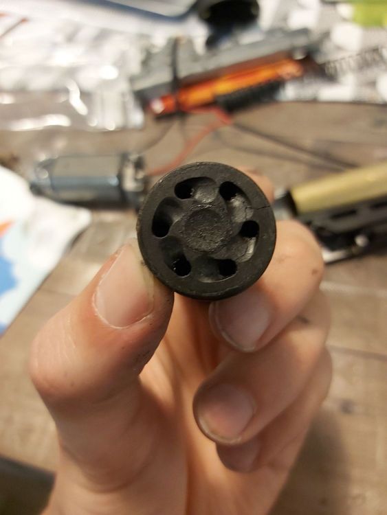

I have spotted a crack forming in the piston so I wonder if it's best to replace now or wait for it to fail if that's still potentially a long way off?
update for anyone with a similar issue that finds this thread... from replacing the busings and greasing the gearbox and putting back together again the gun went from 285fps on 0.25g bb's to 334fps on the same bb's!!!!!!!!!!!!!!!! My gun was too hot to play with so I had to purchase a spring to down grade the fps so I could play yesterday, lucky they had an on site shop and I had the tools in my car so took it apart on the floor of my car!
Definitely replace that piston head!
