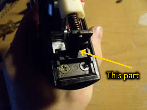

Sight unseen, the part I'd suspect is this:
That's the piece that the nozzle spring guide butts against.  It needs to be securely screwed down, and there's a conical spring underneath it which pushes down on rear of the the trigger bar.
If it's not putting enough pressure on it then the bar can jump over the top of the trigger switch on the gearbox, and in particular, the sprung piece on the left rear of the trigger bar won't be able to engage underneath the plastic semi-auto cut off lever that pops up on the left top of the gearbox, leading to full auto.
If that spring is missing, it'll need replaced.  If it's there, I'd try giving it a bit of a stretch, or shimming between it and the trigger bar.

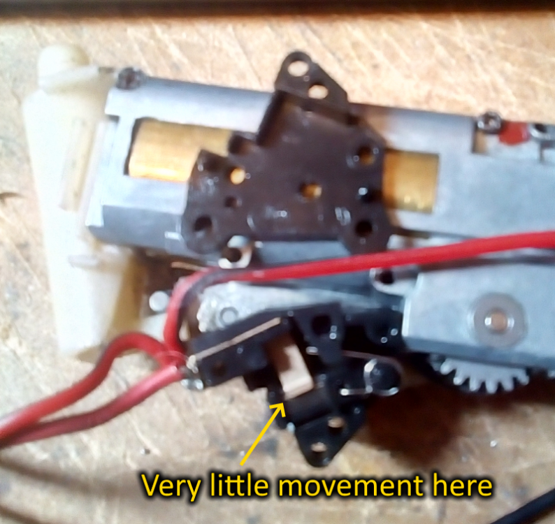

Well, if there's no sign of wear at the rear of the plastic trigger switch, and if you're not just shimming to replace worn away material, then I'd suspect the trigger contacts themselves.  Have you had the trigger unit open to look at the state of the contacts?  There's a tiny amount of movement in order to bridge the contacts: if there's any pitting or corrosion in there or if the contacts have splayed then I can see how it could act up.  Actually, the small amount of material and movement in here is a pretty good argument for fitting a mosfet (as I have) to reduce the current going through the trigger.
All 4 screws need to come out, shortest two go back in the top holes, middle length in the middle, longest in the bottom..  The trigger is held in pretty securely, it's not going to escape at this stage.
if there's nothing obvious at that stage, you'd be looking at taking the trigger out, cleaning the faces the contacts and the trigger metal, and possibly pinching the contacts together.  However, that trigger spring is pretty sproingy, so I'd do that with some caution.
Apologies for the blurry awful picture, hopefully it's clear enough what I'm pointing the finger (and arrow) at.
