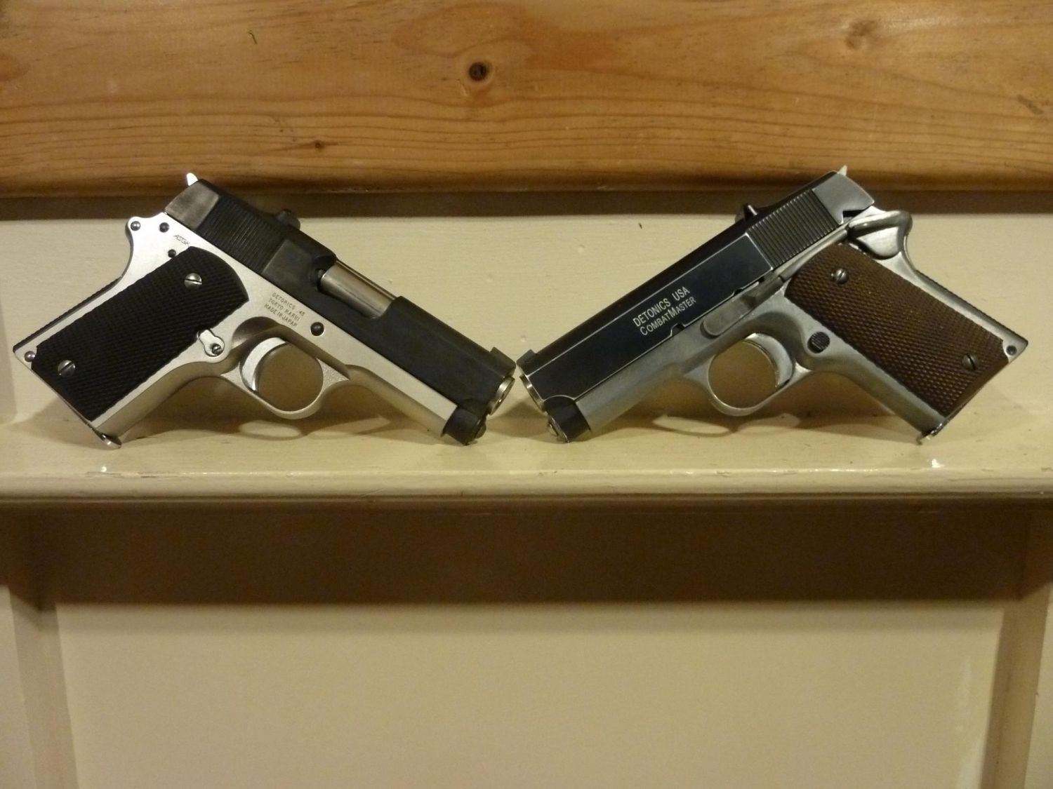

Detonator...not Detonics...
Although I do love Detonics, I've been waiting forever for a Army R45 to arrive from Asia ?
