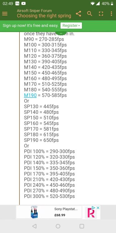

Found this from when I was building my VSR from the Airsoft sniper forum.
I can't stress this enough. 500FPS isn't a target. It's a limit.
If you "tune" your VSR to 498fps with a 0.2, the moment you stick a heavier BB in then your 0.2 equivalent will be above what it should be.
Perfect example, my VSR that was doing 485 on a 0.2, once I stick shooting weight 0.43's in racked up 2.39J which equivalent put me over the 500fps mark. OK the site may not chrono me on shooting weight but firstly technically I'd be over the limit and secondly, I'm a human and shooting more powerful could potentially hurt someone at mid range. Said VSR has now been backed off to about 470 on a 0.2 but comes through chrono on a .43 at 2.28J
