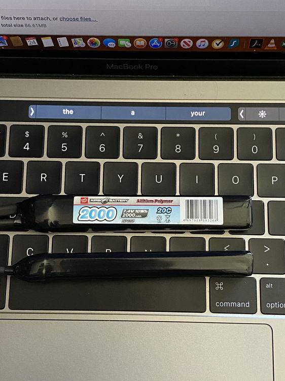

AlphaBear Posted June 24, 2020 Posted June 24, 2020 That connector is perfectly fine. I use one in my 416 too.. You just need to make sure you buy the correct 7.4v 1300mah Lipo as the space in the sopmod stock is a tad tight... Also where did you get the Devgru from? Did they not offer you to buy this adapter and a set of batteries from them? Edit: 2000mah battery works fine (see post below)

AlphaBear Posted June 24, 2020 Posted June 24, 2020 The battery which you need to fit into the SOPMOD is the following. It's a VP 2000mah 7.4v crane stock and it fits perfectly into an unmodified SOPMOD/Delta/416 stock. Component shop sell them: https://www.componentshop.co.uk/7-4v-2000mah-20c-continuous-discharge-airsoft-lipo-split-pack.html EDIT: You may find that the butt cover may have issues... if so get a single stick battery as opposed to a crane stock.. Pick up the 1450 mah batteries. They will work fine...
