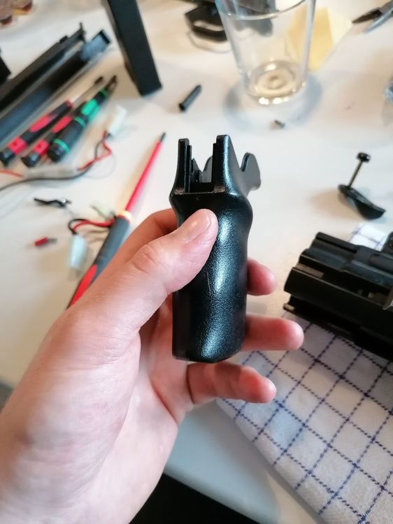

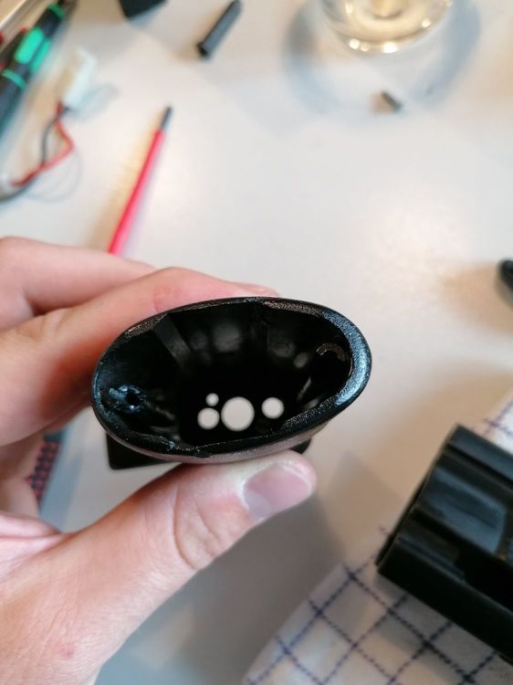

The bottom of the pistolgrip got lose, and the gears started to grind due to a not fully pushed in motor.
So the motors gear is wrecked, and the pistolgrips bottom has broken screws.
Marui Part No.G-4BLK (Pistol Grip) For Marui G3 Series (Black)
The pistolgrip doesnt seem to be in stock anywhere. I can find newer versions, but doubt they fit.
So i guess we have to make a fix somehow. I would print it if i could find it.

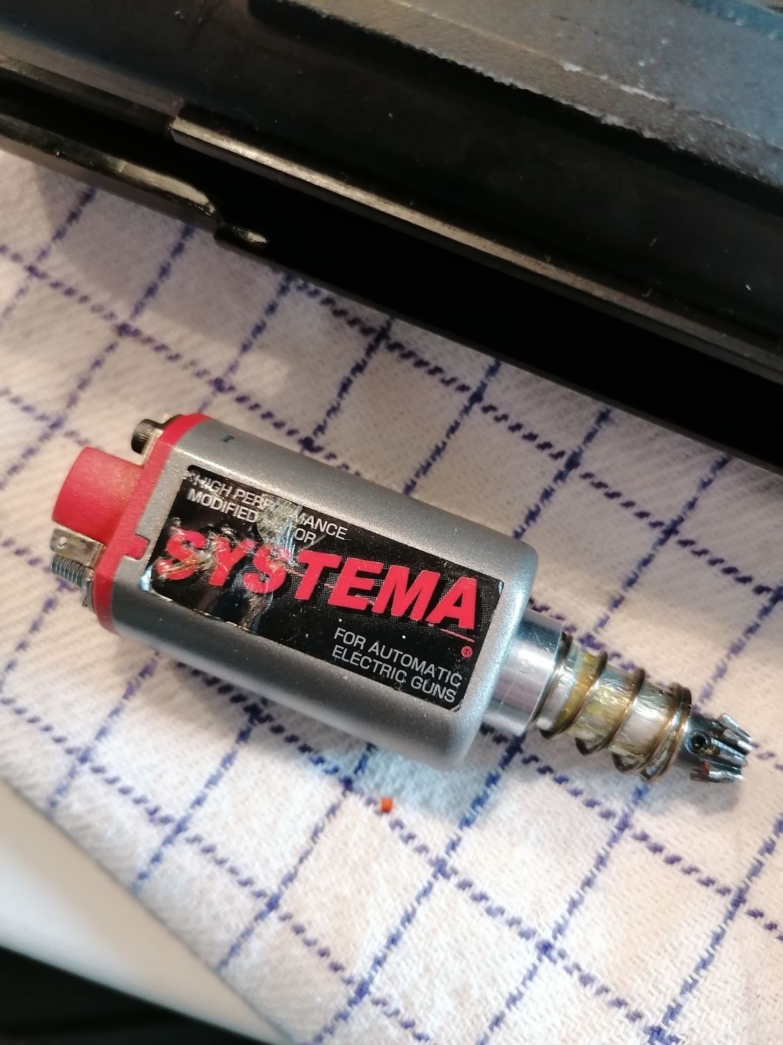

The second part is the motor. It has No info on speed or power. I would like to replace it, but dont know with what.

The LCT pistol grip might fit, At £15 it's worth a gamble since it's a UK shop selling it.

As for the motor. You can pretty much pick what you want within reason.
If you want a cheap all round one then the AK2M4 16 or 22tpa would be reasonable. 16 been faster but if you are running 11.1v lipo's I'd probably go 22tpa.
https://www.ak2m4.co.uk/internal-parts/motors-parts/gp-16tpa-motor-long
https://www.ak2m4.co.uk/internal-parts/motors-parts/gp-22tpa-motor-long
The motor is also a D type pinion, So you could just pick up the pinion gear.
https://www.ak2m4.co.uk/internal-parts/motors-parts/shs-ra-motor-pinion-gear-d-shaped-mim
You will have to inspect the rest of the gears to make sure there is no damage.
As a pistol grip fix I would try this: (got nothing to loose)
- Scratch up the area of the screw mounts with a knife or rough sand/glass paper.  (The better you do this the better chance it  will hold)
- Thoroughly clean and de-grease it.
- Coat the screws with thin layer of grease and screw into the holes a little way just so they hold. (not all the way in)
- Using small strips of kitchen towel soaked in super glue, apply layers to broken area like paper machee around the exposed screw until it looks strong enough (probably 6-10 layers?).  The strips should be long enough to go around the screw mount and onto the flat area either side.
- Allow to dry thoroughly
As for motor, as Iceni said, its a common motor type. (AK2M4 sells quality stuff so that's  a good bet)
Just look for LONG type motors and get the one you like.
I did something like this for a customers gun a few years back, it's still holding nice and strong.  I filled the screw holes with JB Weld and then when semi-dry screwed in the screws, creating the thread
Check the Systema pinion gear very closely - it might not be a D type...
They tend to use bespoke O type pinions with a grub screw in it - ffs Systema
The shaft on some armatures are O type but has a tiny area cut like the D to accept the grub screw
So a std D type pinion won't slide onto the O type shaft - FFS x 2 Systema WTF x 4
Getting one of them pinions is like looking for rocking horse shit & if you do locate one it won't be a few quid
https://www.amazon.co.uk/Motor-Pinion-Gear-Systema-Airsoft/dp/B011UMJG88
http://www.redwolfairsoft.com/redwolf/airsoft/Parts_Systema_PTW_Professional_Training_Weapon_Parts_Systema_Motor_Pinion_Gear_for_M16_and_Pinion_Gear_Screw_for_PTW.htm
now "some" might use a proper D type but pretty sure most Systema's use/used a bespoke O type with grub screw pinion
Systema Airsoft Motor Medium Type High Speed For PSG-1 | eBay
other Systema's...
Systema "A to Z" AEG Motor Released | [PT]Airsoft
or blue Systema's...
Systema Turbo Motor (Medium) for PSG-1/SG550/SG551 <font color ...
So check very closely the end of motor, I think it might be a O type with grub screw than regular D type grub screw
In which case the motor is likely wanked as it is....
(could maybe clean it up, trim the axle make a medium/short systema high speed motor with a O type pinion)
So likely look at new motor, the motor was likely a 35k ferrite, but there are a few revision of speed/turbo fast motors
(think red torquey/magnum's systema had neodym magnets - still fucking expensive Jap motors though, no longer stocked)
Might want the 16tpa motor to kinda match performance of a Systema High Speed
the same" high performance" label is applied to your motor & the blue turbo so fuck know which high speed systema this chart refers to exactly - assume a 30~35k motor perhaps, though probably a bit knackered...
Systema turbo vs systema magnum motor - Airsoft Ohio Forums
Old motor, some had shortage risks and fucking expensive, though windings soldered on to arm etc...
So a precision built motor, not cheap, slight shortage risk....
and a wanky bespoke pinion gear looks like a D but is in fact an O type with grub screw
(so you gotta buy Systema bespoke pinions of course - crafty sods)

Seriously, thank you. Thats so much help! I'm gunna order a replacement now. Fixed the bottom of the pistolgrip with a 3D printet solution.

Drevil, if you need a spare G3 pistol grip please let me know. I have a few left from old projects which you are welcome to have.
I would love to buy one if possible! Since the 3D-print we are doing wont be pretty, at all, but only effective.
Are they like the ones up top? Since there is a new version of them :)
I love the astetics of the gun, and would love to make it look like new :)
I am from Denmark though, so will gladly pay for shipping and more!
I will check the spares box at lunchtime and photograph what i have.
