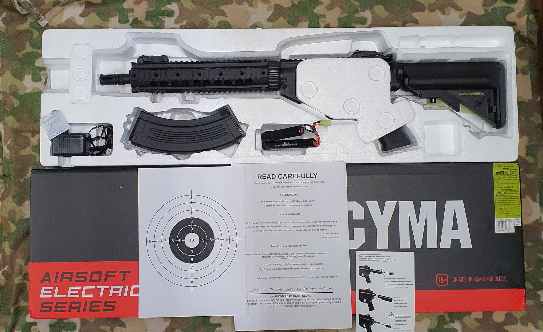

Inside the box you get the AEG, Hicap magazine, battery, battery charger, cleaning/unjamming rod and some basic paperwork.

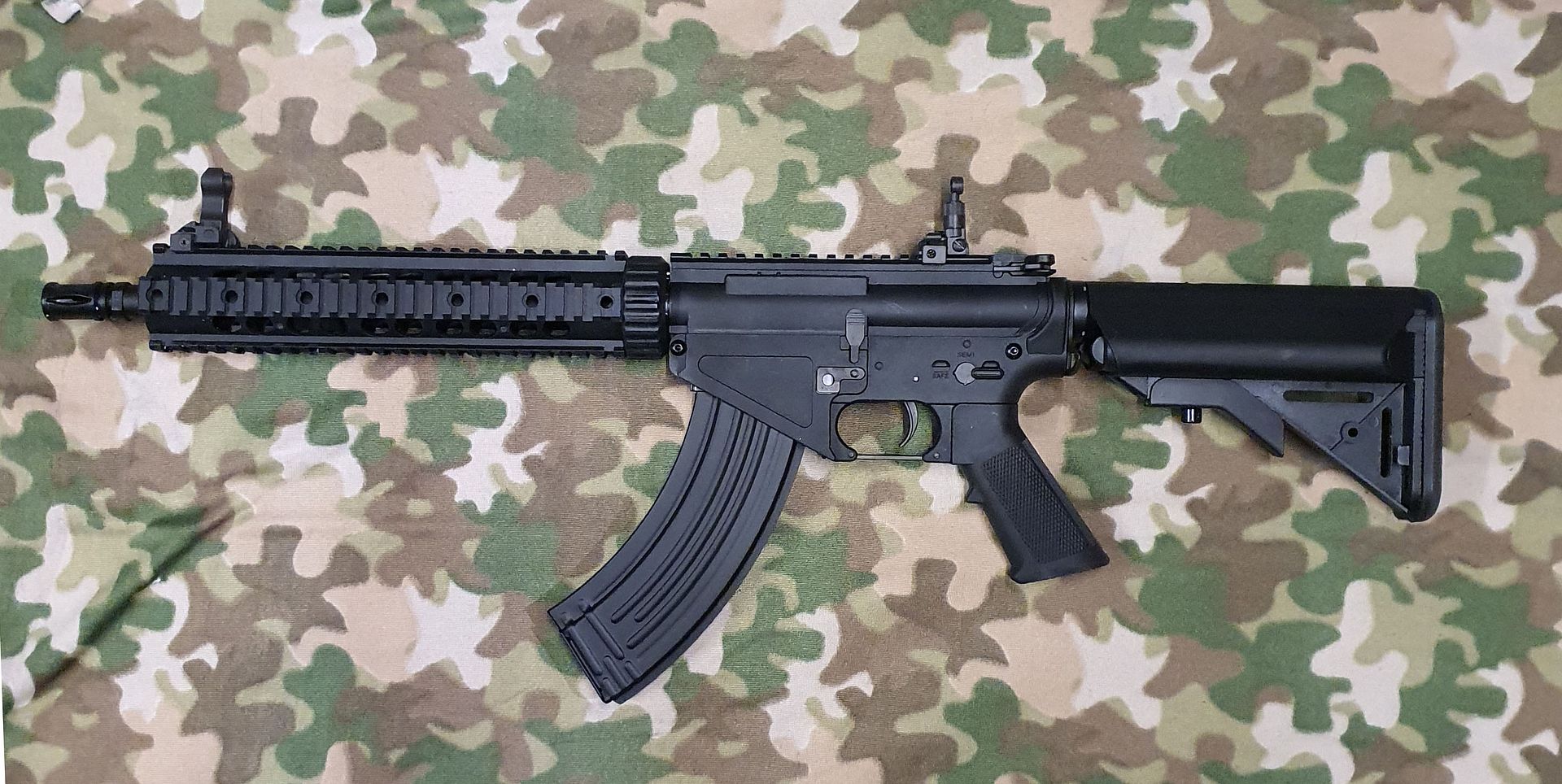

The AEG is very lightweight, and this is due to the AEG being mostly made of polymer. I’d comfortably say that you could run around the woods all day with this AEG and not notice it. It would be ideal for a younger player or someone who might find carrying a full metal AEG all day a problem.
The polymer seems to be strong and doesn’t seem to have any weak spots as far as I can see.

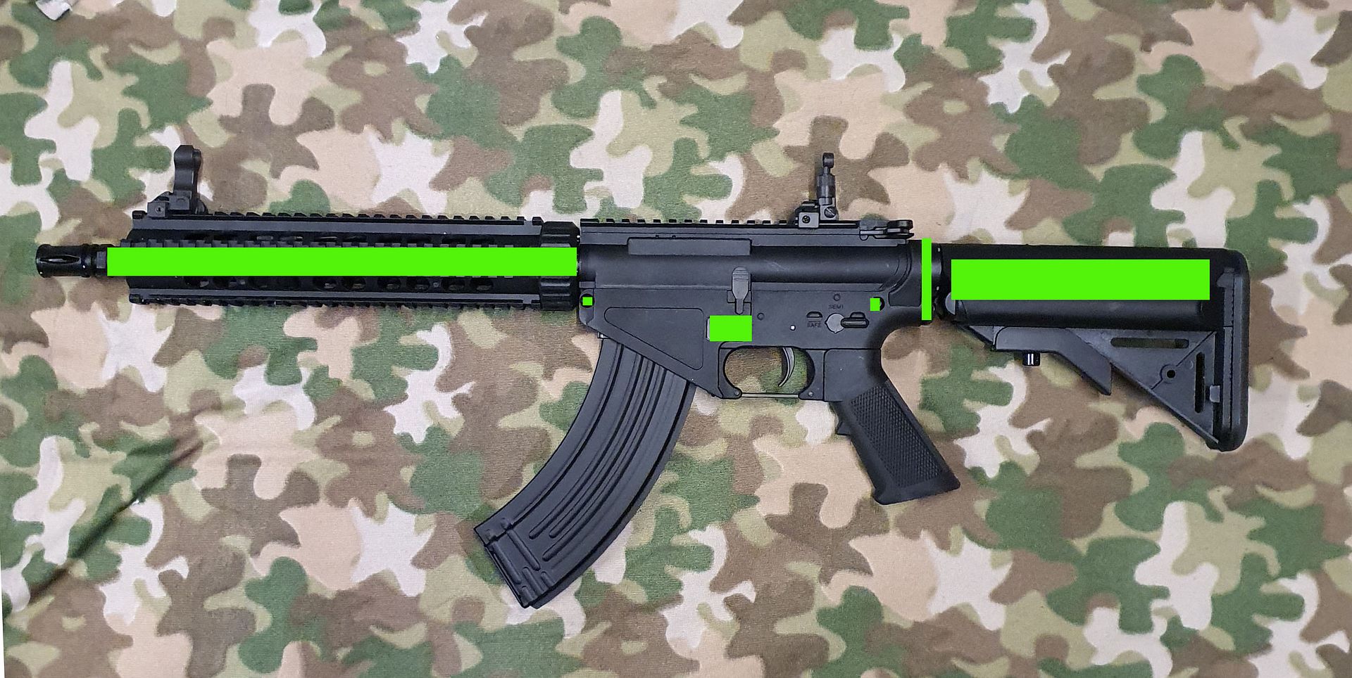

I’ve highlighted below just how many parts of this rifle are metal. As you can see it’s pretty limited but for an AEG costing £109 I’m not surprised.

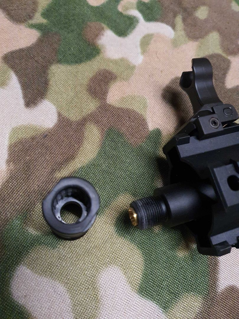

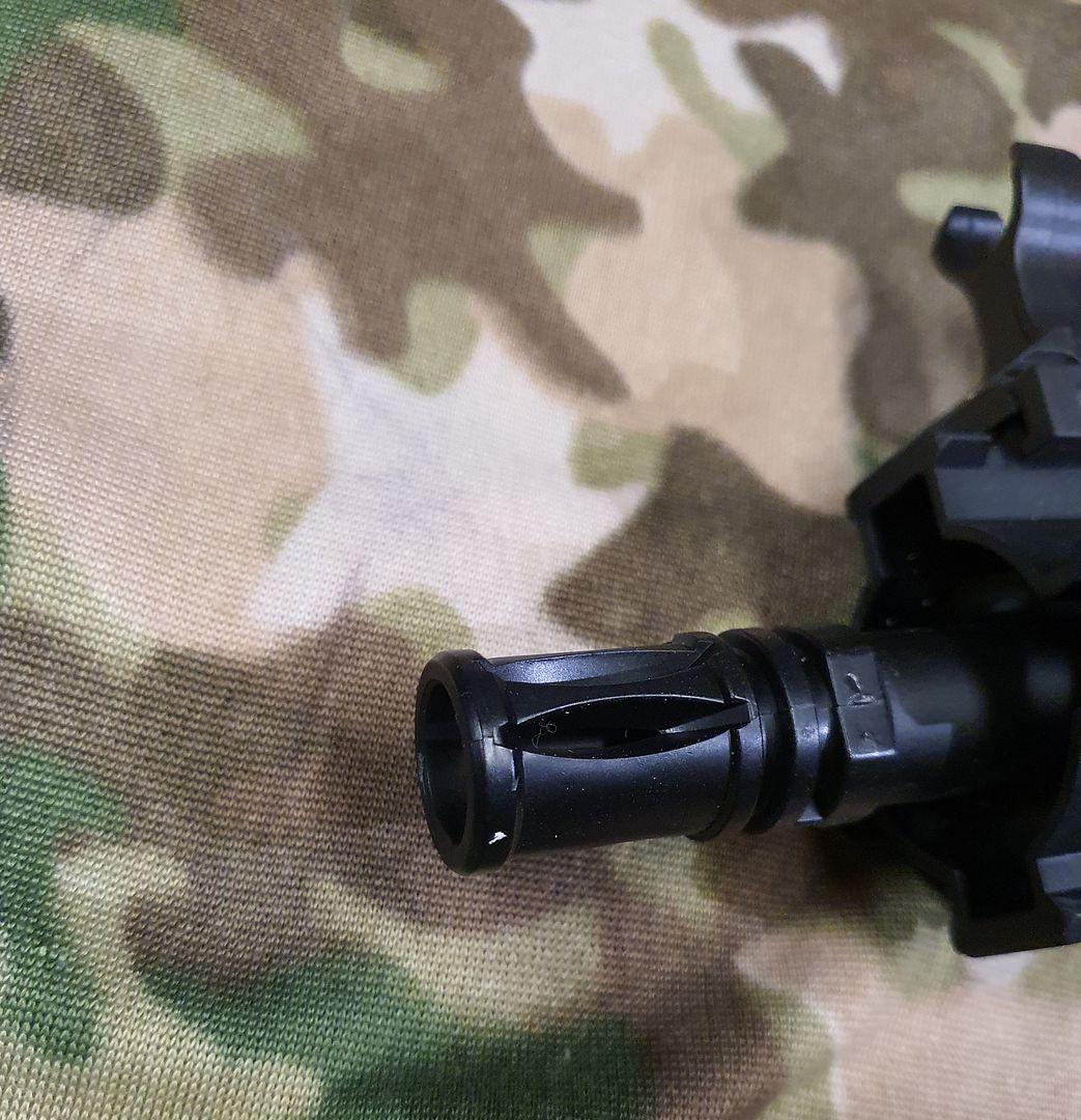

First up is the flash hider. This is a plastic copy of the M4 style bird cage flash hider and is just jammed onto the threads of the outer barrel and there isn’t a grub screw securing it to the AEG. It’s not going to fall off easily as it’s jammed on tight but there are actually no threads inside the flash hider. This is a first for me to be honest.

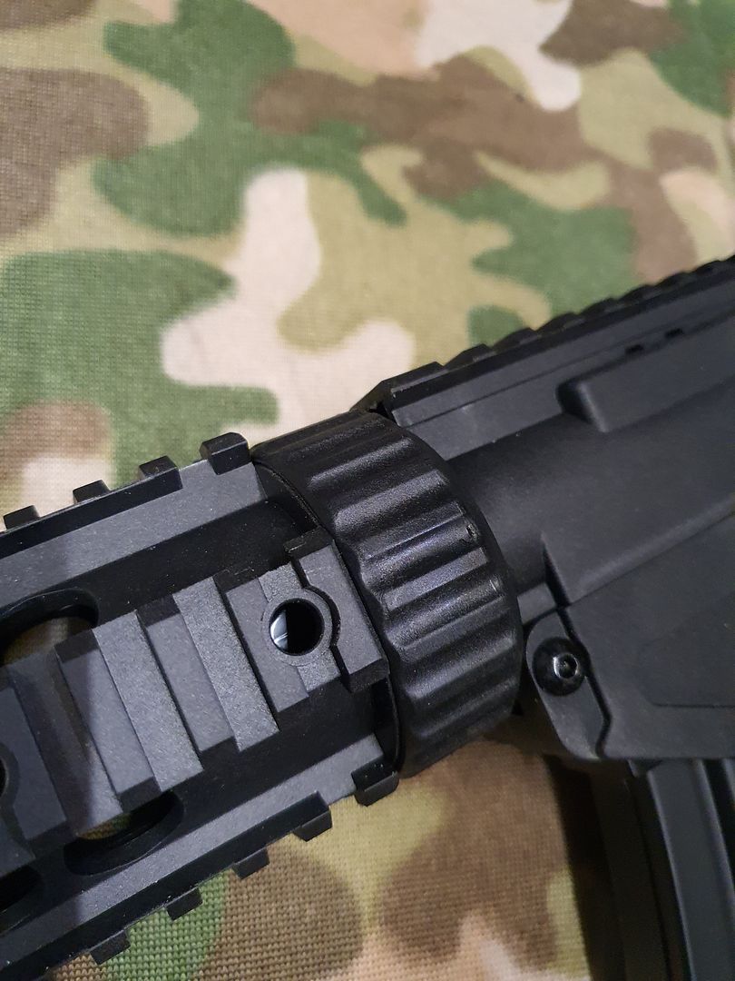

The front RAS rail is a copy of the Knights Armament SR15 rail but all in plastic including the delta ring. It seems thick enough and shouldn't snap too easily and the picatinny slots accept all the accessories I tried on there.

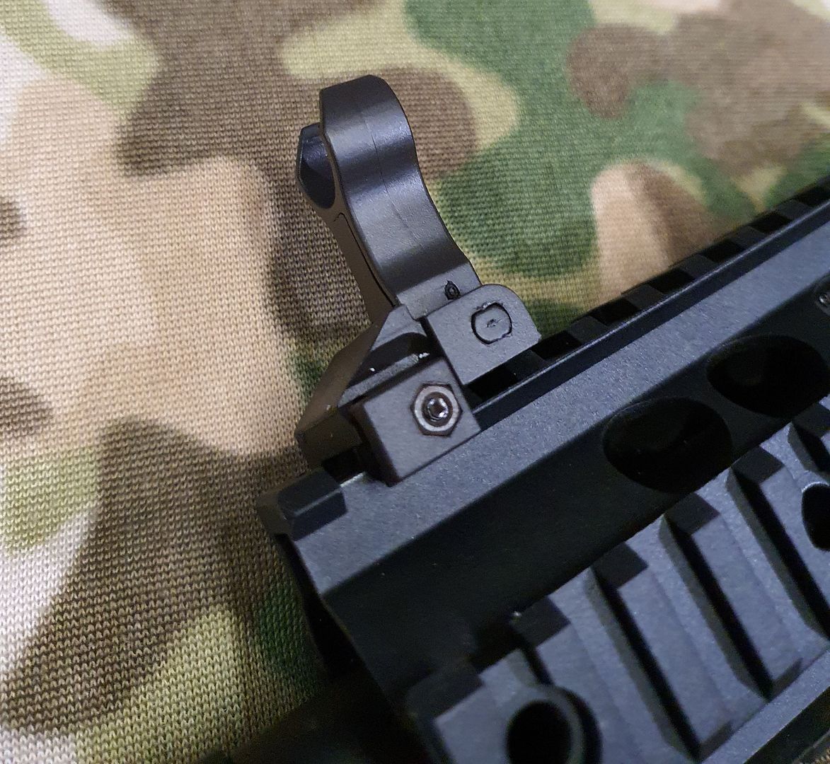

The front sight is a plastic copy of the Troy front sight and folds up and down. There is no adjustment for height of the sight post.

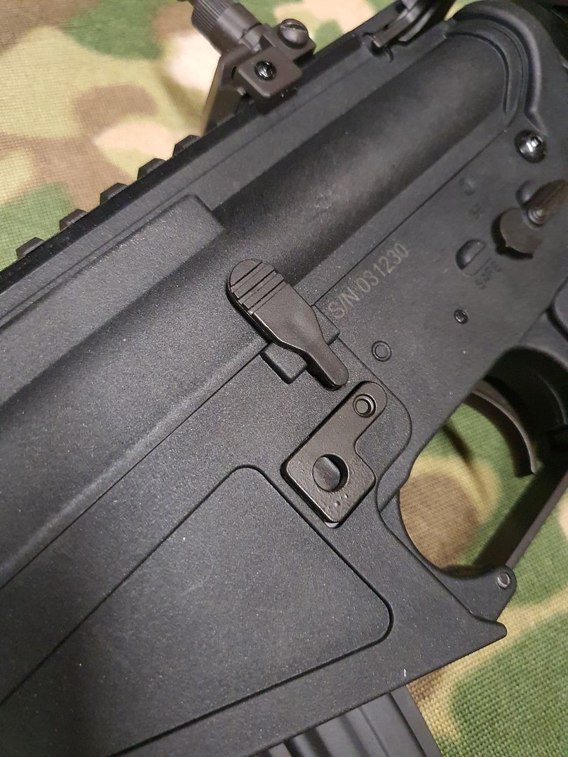

The magazine release is one of the few metal parts on this AEG and can be used 2 ways. You can release the magazine by pushing the button on the right hand side, the same way as a M4 or you can push forward on the lever inside the back of the magwell like an AK. You are unlikely to use it the AK way as the lever doesn’t protrude far enough out of the magwell to be useable. It really needed to be 1cm longer to be useful.

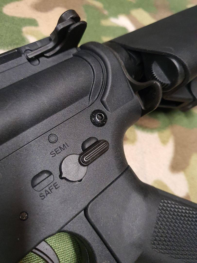

The selector is made of plastic and clicks nicely into each firing position.

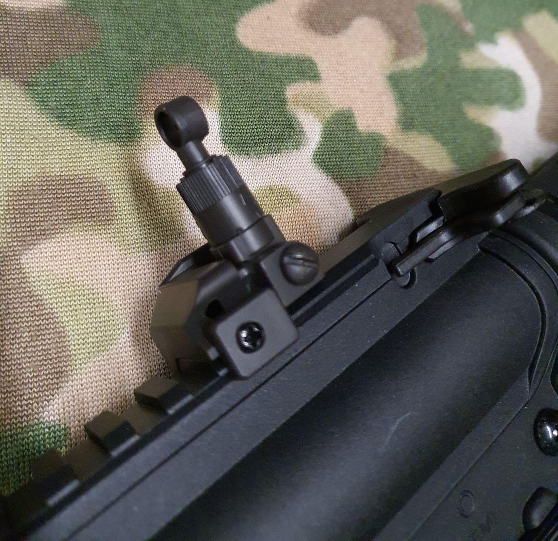

The rear sight is a plastic copy of the KAC pop up sight and has adjustments of elevation and windage.

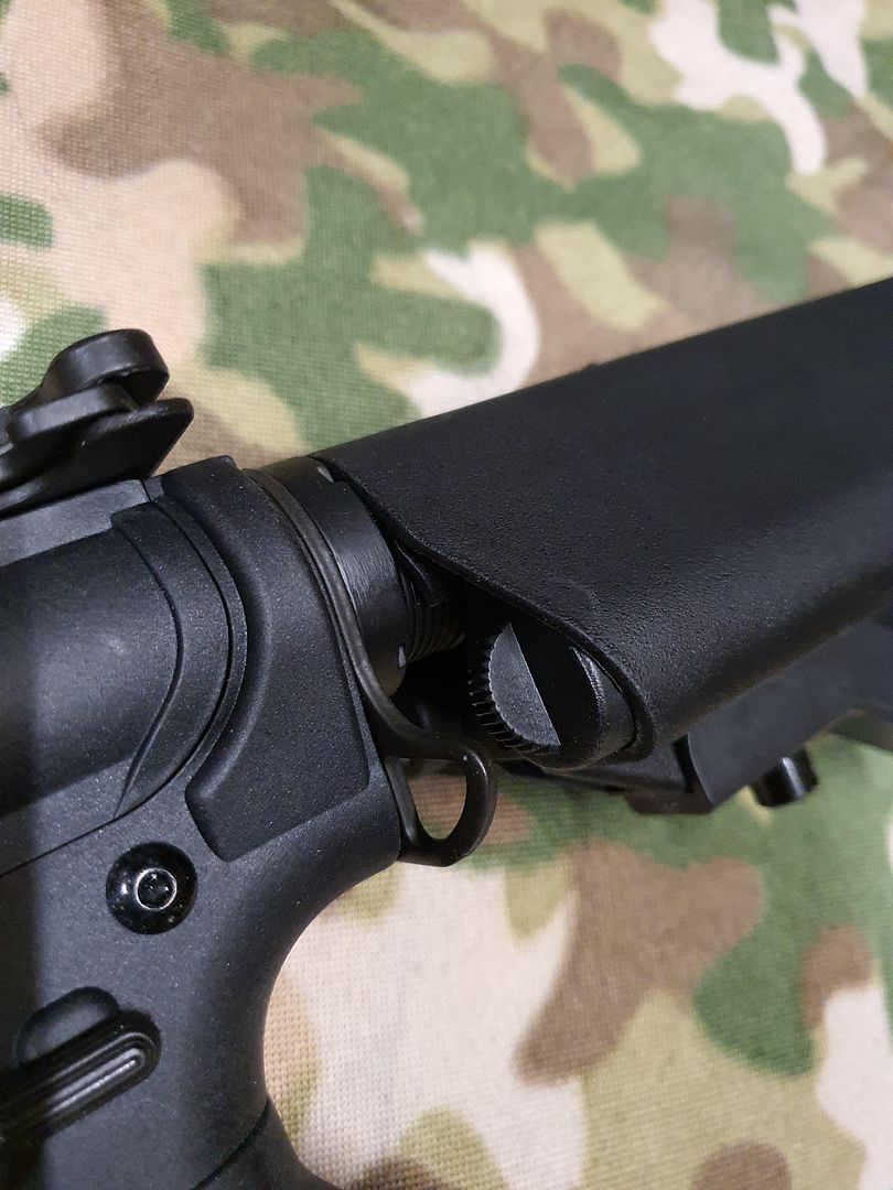

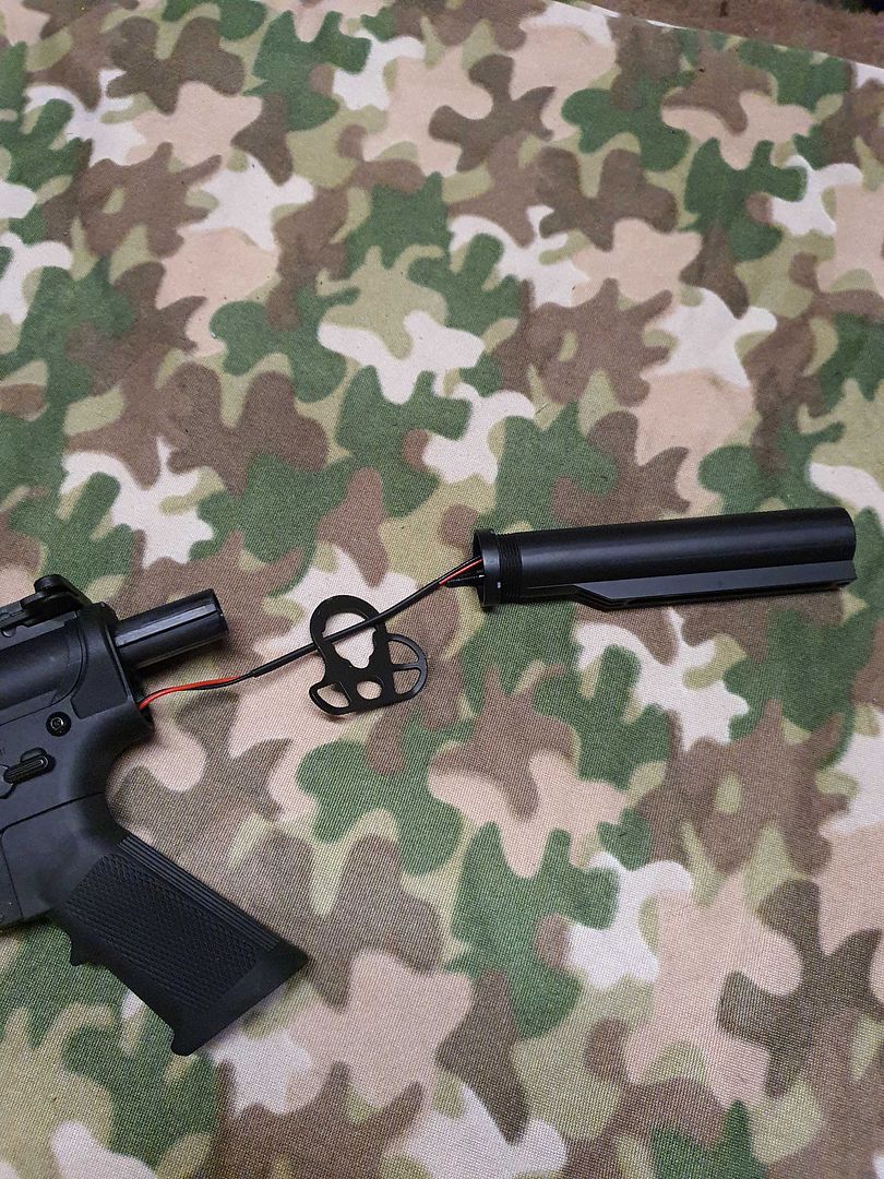

Another of the rare metal parts is the end plate sling loop. This is nicely made and gives you the option to sling the weapon.

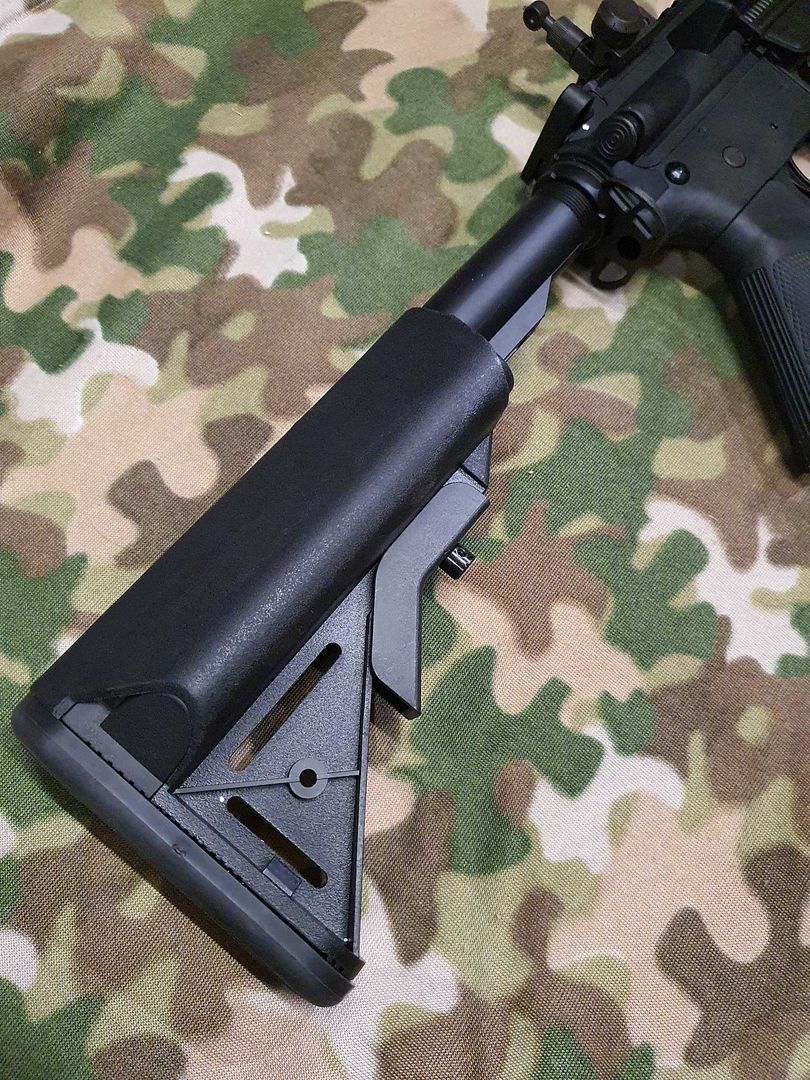

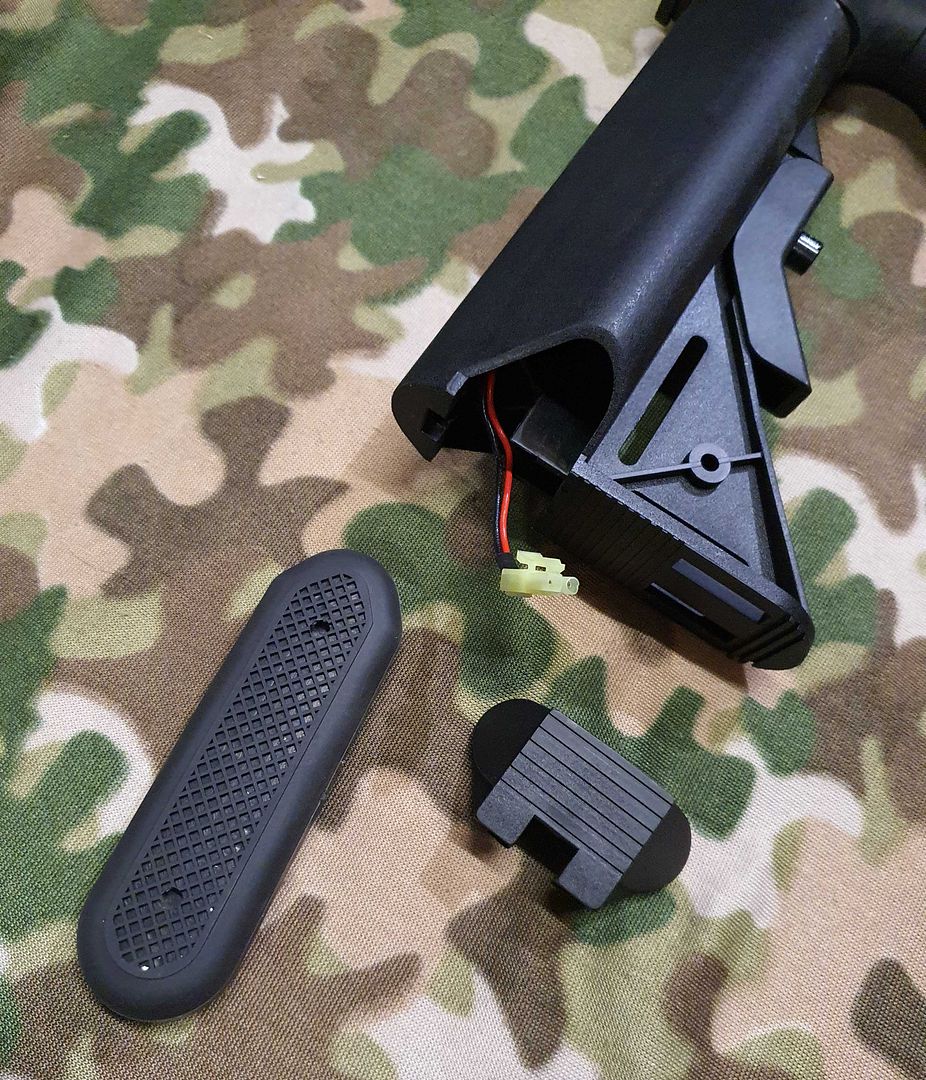

The stock pipe is cast metal with the castle nut moulded into it. On top of that sits the crane stock. The rear of the crane stock is removal able to allow a battery to be fitted. There is plenty of storage inside the stock pipe and crane stock to fit a lot of different battery sizes however don’t both using a11.1V LIPO but more on that later.

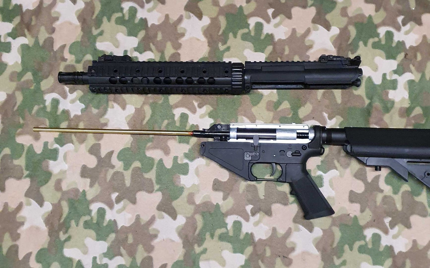

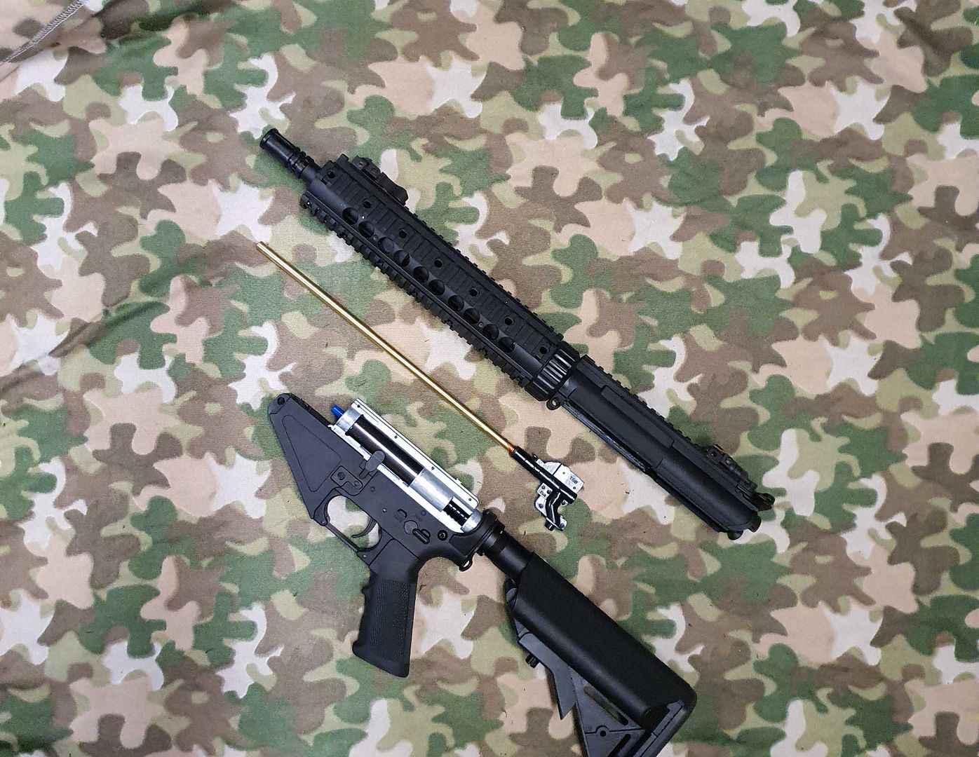

Removing the front retaining pin allows the upper and lower receiver to be split. The front pin isn’t captive but does have an Allen headed bolt to stop you loosing the pin when it’s attached to the AEG.
Splitting the rifle in to should be done carefully as the hop unit and inner barrel stay attached to the gearbox and you need to remove the upper receiver and then twist the hop unit and barrel out of the lower receiver.
When you piece the rifle back together make sure you attach the hop and barrel to the front of the gearbox before sliding the upper receiver on.

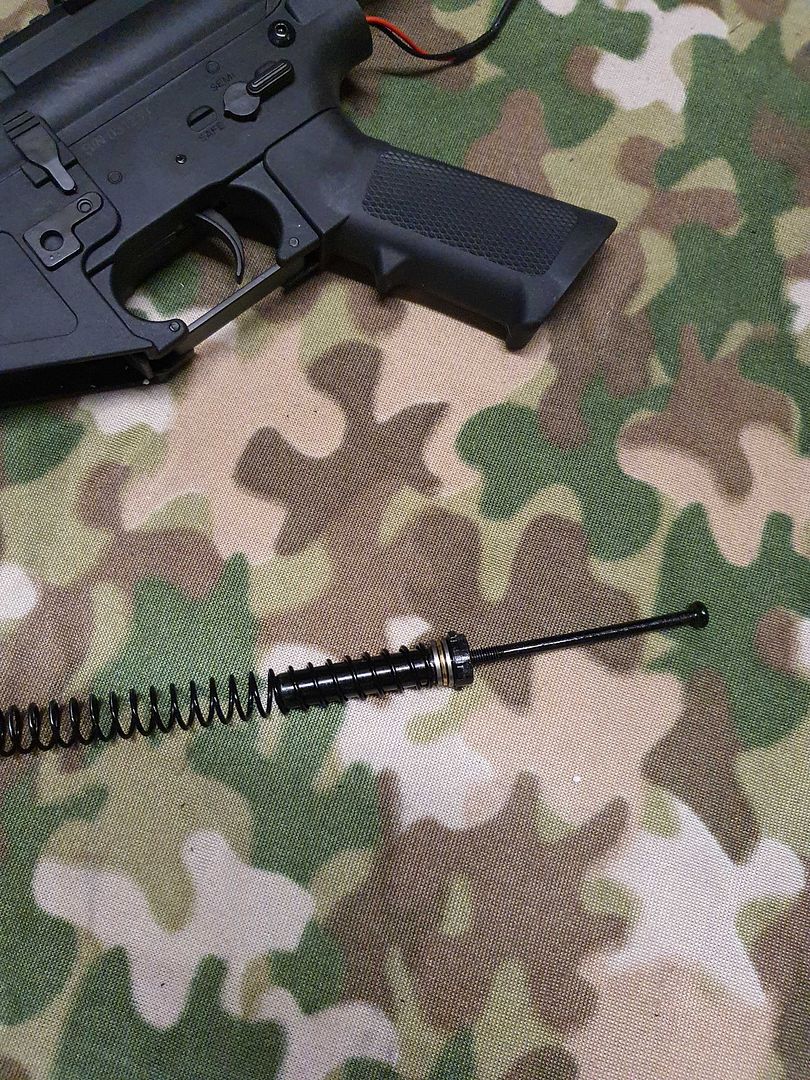

The gear boasts a quick-change spring but I found that it was anything but quick change. You need to remove the stock and stock pipe and then turn the bearing spring guide into the slots in the back of the gearbox shell to remove the spring. I did several times and couldn’t get the thing to come out. I ended up lining it up in the cut-outs then used the stock pipe retaining screw to pull it out. I chopped my main spring 3 times to get to the required FPS I wanted and all 3 times I had to so the same thing with the stock pipe screw to get the spring guide out.
Looking at the accessories in the box, you get a charger with European pins, a 8.4v Ni-MH 1300Mah battery and a Hicap magazine.
The battery charger isn’t great. You’d probably want to just throw it away and buy something better quality. The battery is actually fine to use and I tested it out and get the same speed when firing as a 7.4V LIPO.

The thread on them flash-hider's or rather lack/no thread - just whacked on
is what many of the £70 M4 ultra cheapo 5xx like CM515 & CM517's have

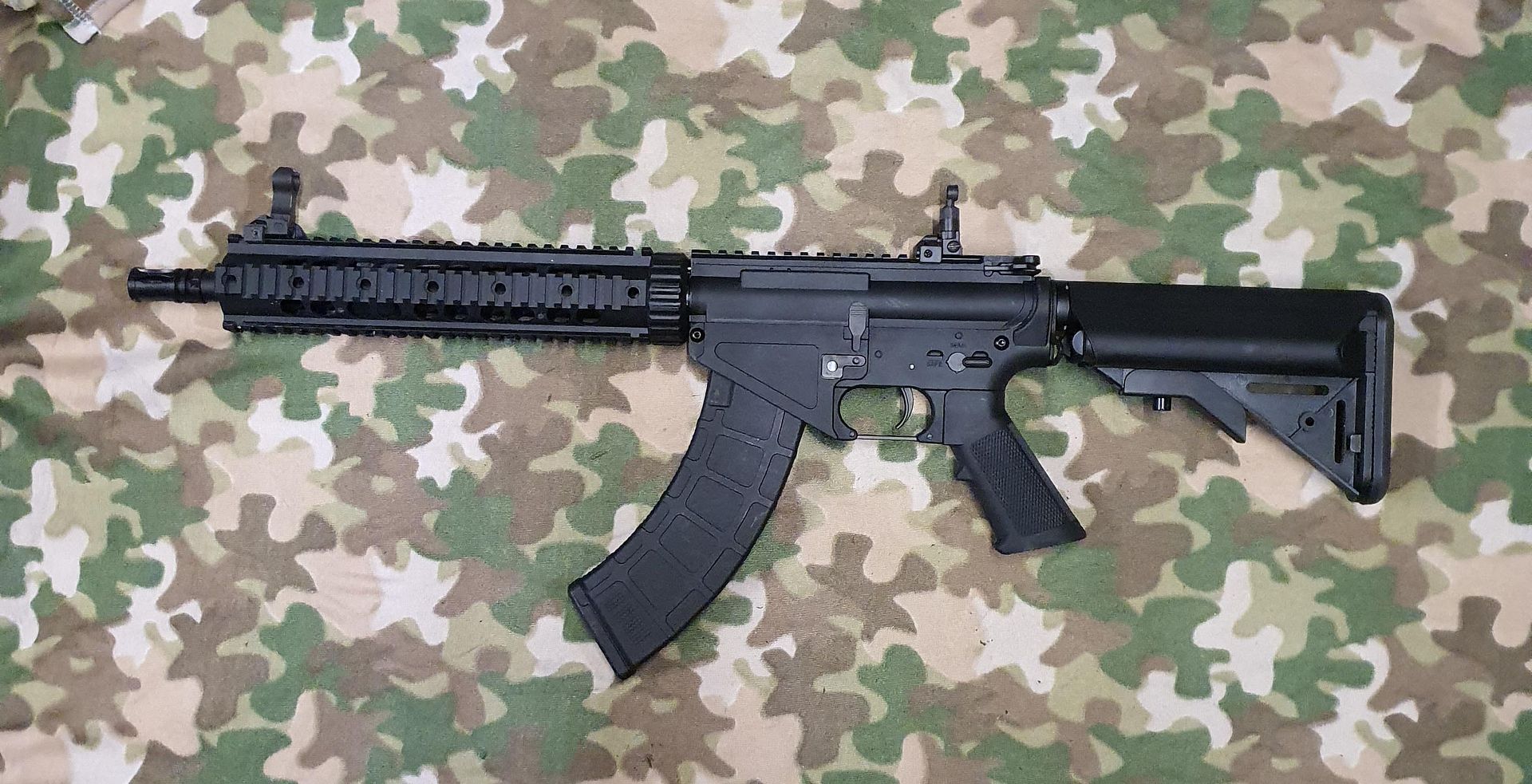

There's nothing I really disagree with in @mightyjebus excellent write up. Other than the loose stock on the buffer tube (solved with velcro), there are no wobbles or creaks. The rail is pretty sturdy as is the plastics in general. I don't think it's quite G&G quality but it's certainly not low end. The trigger response in semi is good, but full-auto ROF is a touch slow at around 11rps. I don't run 11.1v LiPos in any of my guns, so I'm unlikely to have the battery issue affect me.
I'm not planning upgrades other than replacing the stock hop rubber/nub and the polishing the barrel.
I think that the only significant issue is the pricing. I was very lucky to get one for the price I did. Back last year these could be had for £110, plus shipping from TaiwanGun, this was of course prior to Brexit - even then, there was stiff competition in that price bracket, with only a few quid more getting you a full metal CM.045 AK or a DE M904. Fast-forward to today and these go for up to £170 from UK sellers, which prices them out of contention for most people, especially with the likes of metal-bodied Specnas et al readily available in the UK. It's a shame, but I don't think I'm going to see many of these about in future. But if you see one for less than £100 on sale, and it tickles your fancy, I say it's worth a punt.

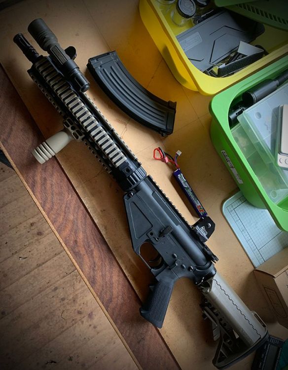

I've thrown on a few parts that I had knocking around in the spares box to liven it up a bit.
